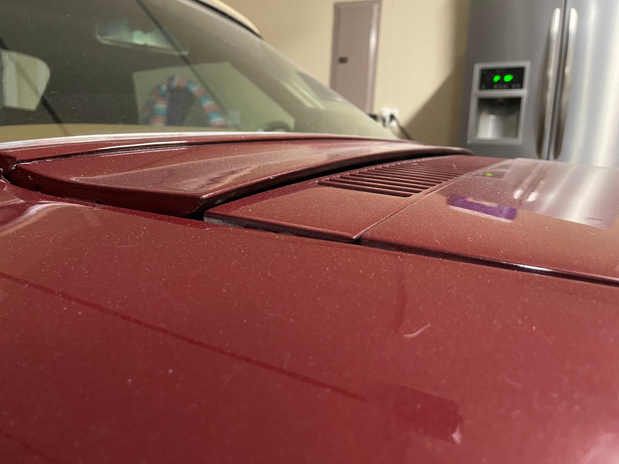

Is this a partial vacuum leak? Can’t get the wiper door to fully seat so there’s no crack /see pic).

When the engine's not running, does it sit flush? If not, there is a close-stop adjustment (from the '72 AIM):

And if it's not the stops keeping it up, it's possible the actuator connecting turnbuckle needs to be adjusted

I suggest removing the wipers and seeing if it closes then.....before going off and doing whole lot of stuff. Unless you can absolutely make sure they're not getting in the way.

good point
