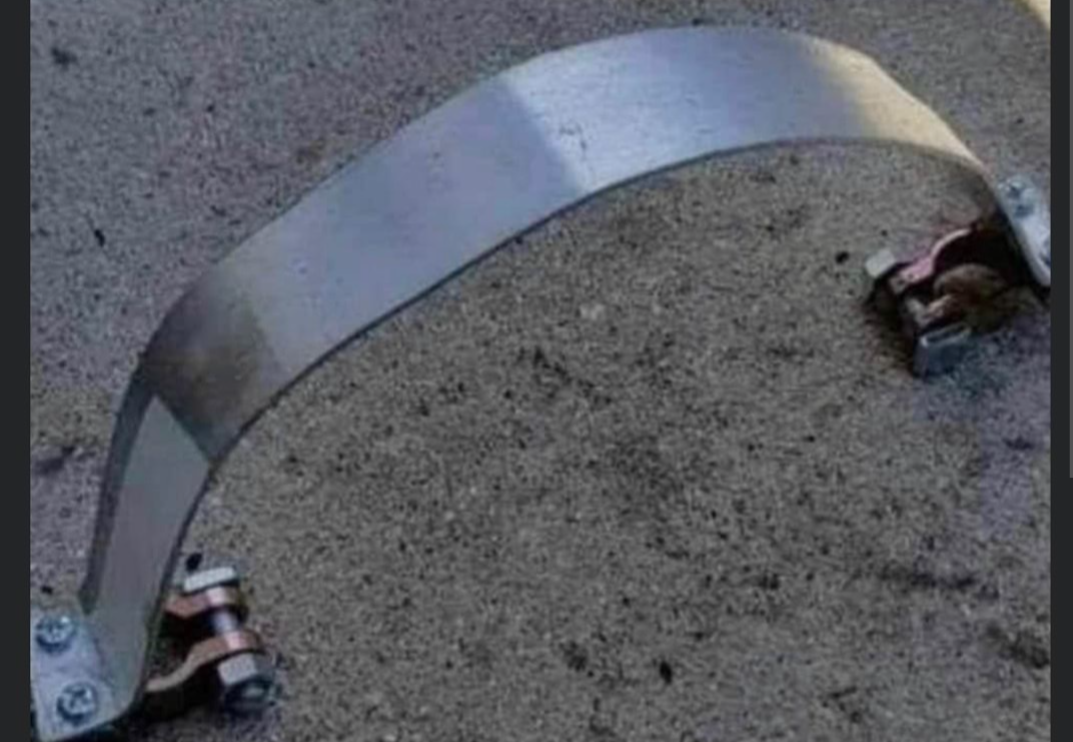

Also if your battery doesn't have a handle you can build one really easily

hahahaaaa!
