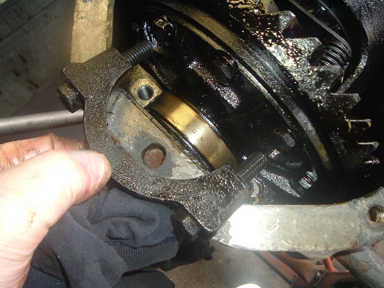

Original diff, no oil change.

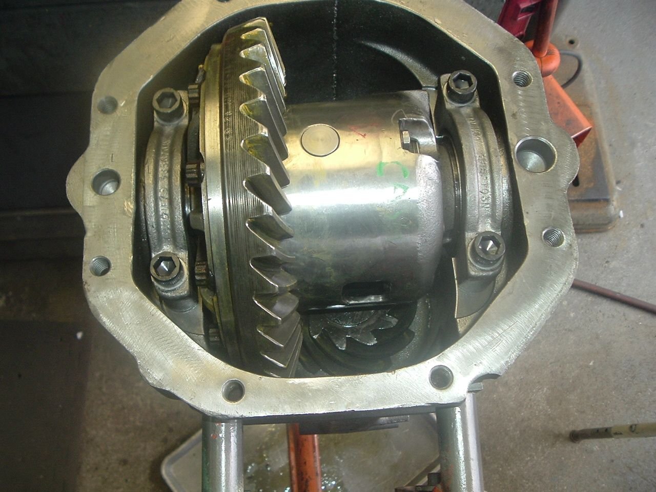

From: Connecticut, USA
Same Diff after I finished it- Change the oil

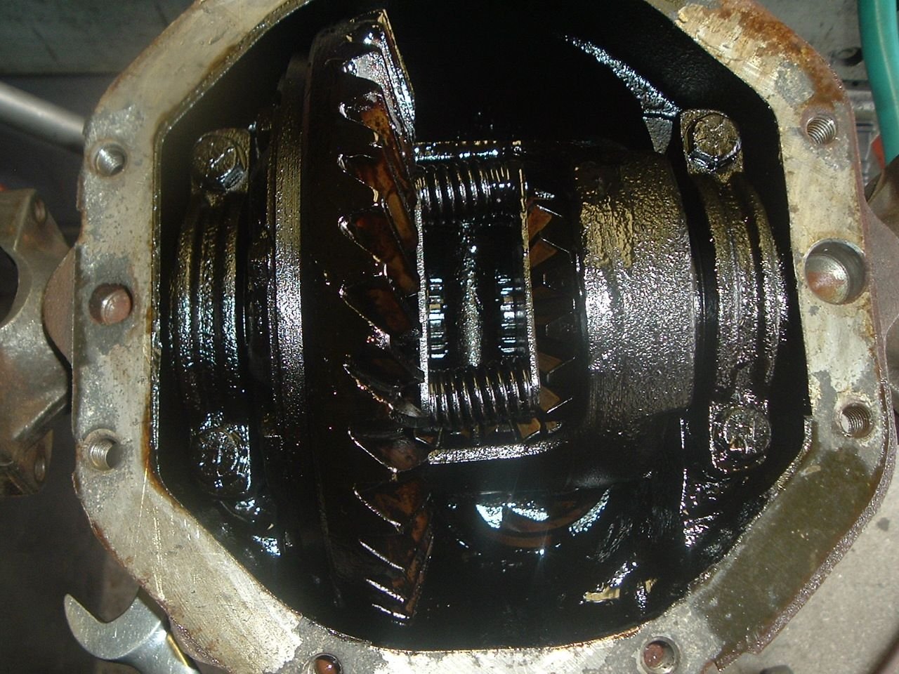

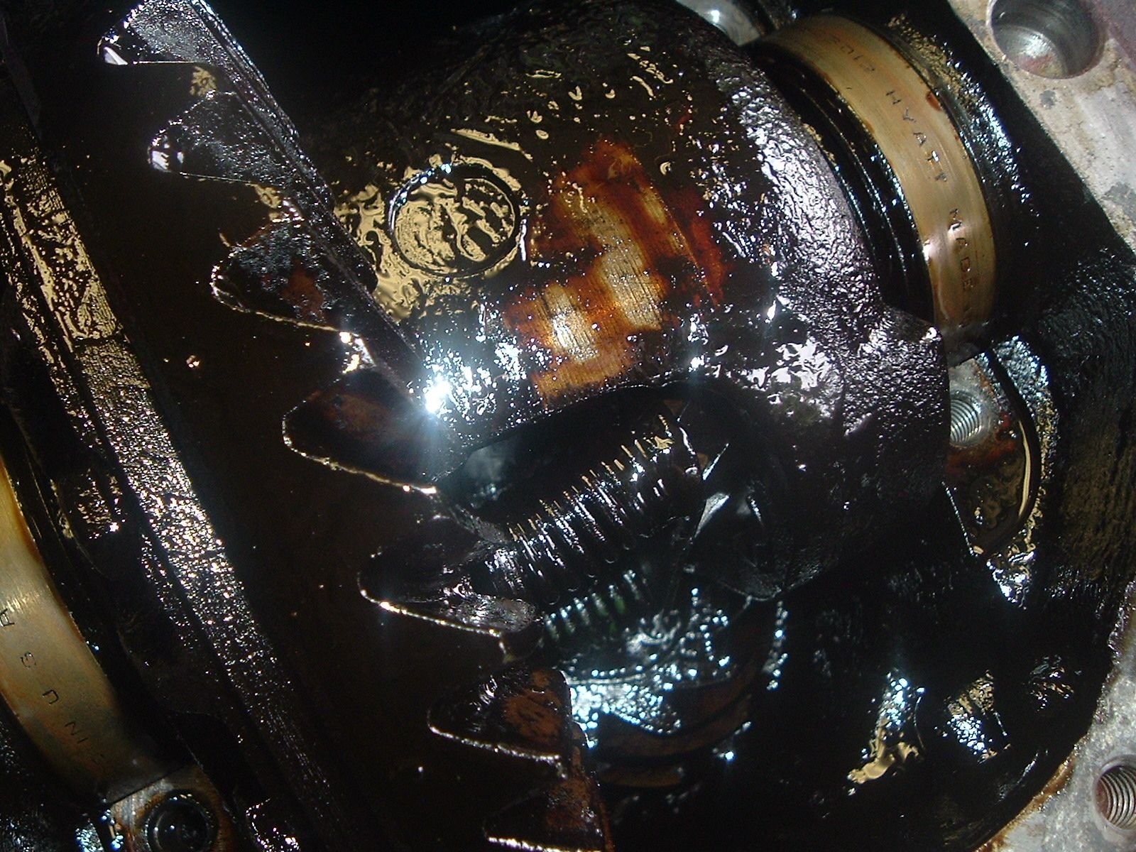

I know this may open a large can of “Worms.” What oil and additive do you as a rebuilder recommend for our old stock differentials. Does the case cover have to be removed to see if there is sludge buildup like the one in your photos. If it needs cleaning, can the differential be cleaned while on the car? Many thanks
Eli
Old Dec 22, 2023 | 11:43 AM
GTR1999's Avatar
GTR1999
Joined: Aug 1999
Posts: 15,175
Likes: 3,990
The diff in the picture was bad, I have seen and worked on worse. Once they are at that level, the only way to clean them is to take them apart. If you go that far then replacing the common parts and addressing the weak areas is recommended. However, I know guys that would take it apart, clean it, and put it back together without changing anything but the cover gasket.
All comes down to what you want for your car = ok, good, or the best.
As for oil, I use Lucas 85-140 non synthetic gear oil and 2 bottles of GM limited slip additive. A big thing is how the posi is built, most times sloppy with the spring pack. If tight with the spring pack it will chatter. Clutch type is important. solid steels, snowflakes, fiber. Some are junk, some are good. Both are still being sold today.
Hey, GTR: You need to change your profile name to "REMBRANDT" that's some piece of artwork ................................WOW !!!
