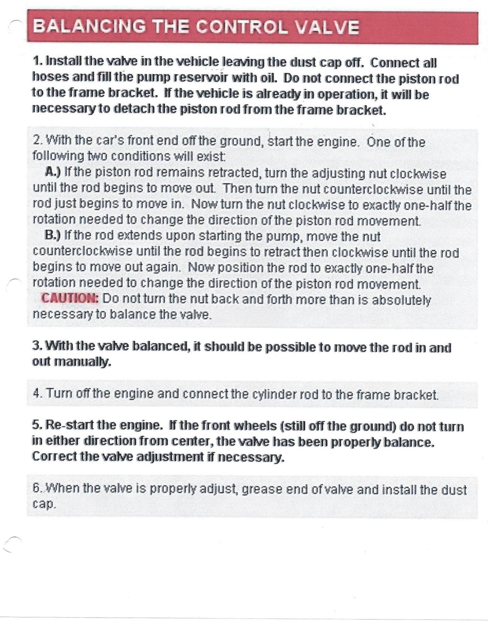

Since you actually read instructions, here's some on balancing the control valve.:
Good instructions. Thanks. I ran of time yesterday. Will get that done this weekend.
I rebuild scuba regulators as part of my paying job. I need to read instructions very carefully since there are so many variations in design.
I see the last line mentions “grease the end and install the dust cap”
I have never seen a reference, or find a reason, to put grease under the dust cap. Therefore, I am assuming they are referring to the other end where the zerk fitting is at.
The hole where my zerk fitting went was partially stripped when I got the car and a small bolt was inserted. I loaded mine with grease and used a copper washer with a bolt to seal the hole.

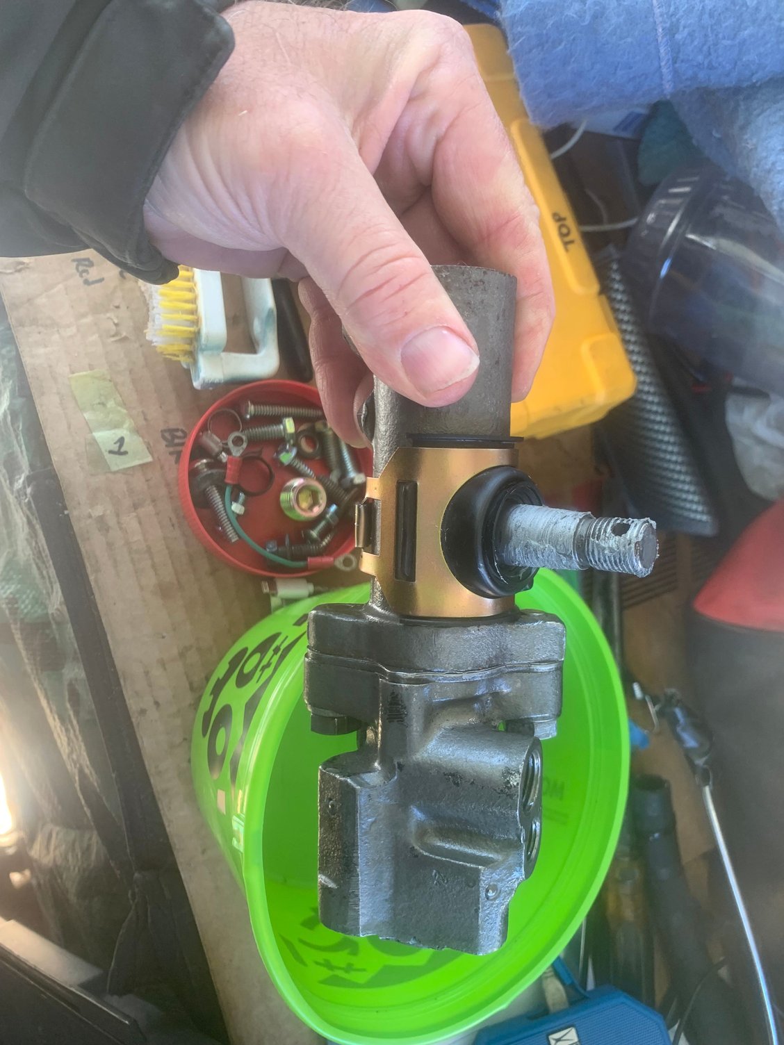

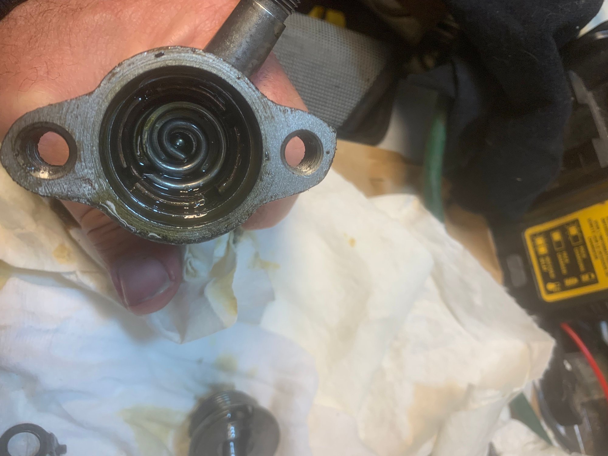

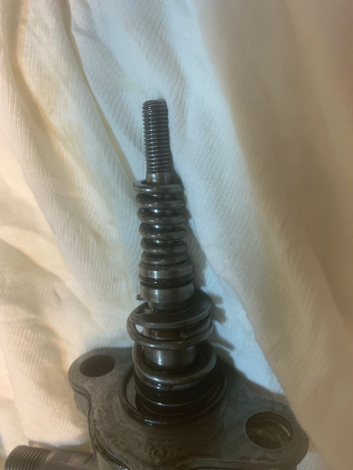

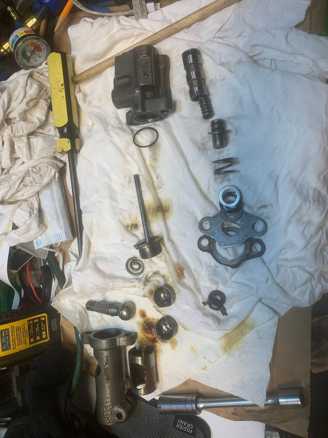

Originally Posted by 4-vettes
Looks good on the outside. Any pictures as you were going along??
Every step of the way!!
I even mic’ed my adjustment nut to put it back in the exact depth.
My car sat for over three years with a dry valve when the previous owner’s mechanic passed away. When I took over, the valve was leaking badly when I added fluid. I saw no damage to any of the seals or Orings. They were a little harder than my new set, so I am hoping they only firmed up by sitting static and dry under pressure for so long. I cant see any scoring to the cylinders.

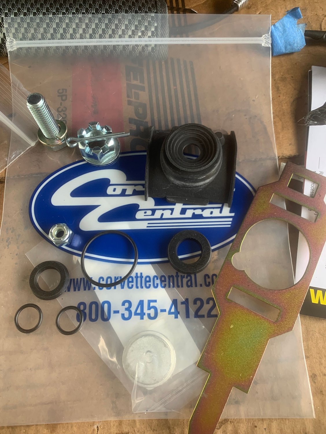

“did your kit include all the metal parts, (sliding collar etc) or just the ball pin and the rubber seals etc?”
I used the Corvette Central kit, part number PSV-2 or 562337 with the following (see pic):
(Note there were two of the same oring in the pack. I only replaced one, so I think it is either a spare in case damage during install or just a duplication.)
Forgot to mention - I purchased the new dust cap separately. My kit did not include a new cap. However, I find I did not need a new one. I even re-used my old one.
Yes, that looks like the kit I used. At the time I bought it, CC offered a kit that included all the metal internal parts, but I decided against that. In the end, I sort of wished I'd bought it, but after some judicious cleaning the old parts seem OK. It's lasted for at least 5 years now I think - another myth exploded, as most comments were that "modern stuff" was sub-standard and would only last a month or two!
Why the need to grease inside the dust cap?
Maybe someone will tell us.
About the zerk fitting, if you pump grease in it can rupture an internal seal, so since you put grease in leave it alone with the blot still in it.

Balanced the system today. Glad I did. When it was only hooked to no-wheel front hubs, the Ram did not move. However, when I took it off the frame mount, it slowly pushed out.
After balancing, I let it run for a few minutes and varied the throttle of my engine until it did not move at all.
