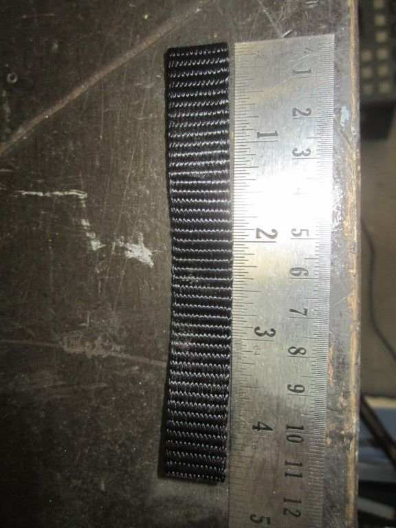

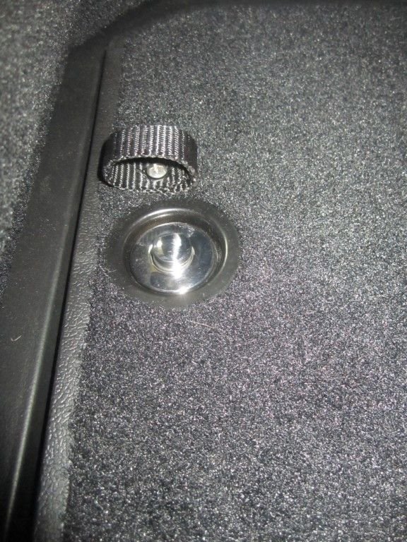

For the compartments, there is supposed to be a push-button latch with a little loop of material for a finger pull beside each one.

Not the correct material for the loop but basically like this

Small dog lease was just the right size to make new loops from

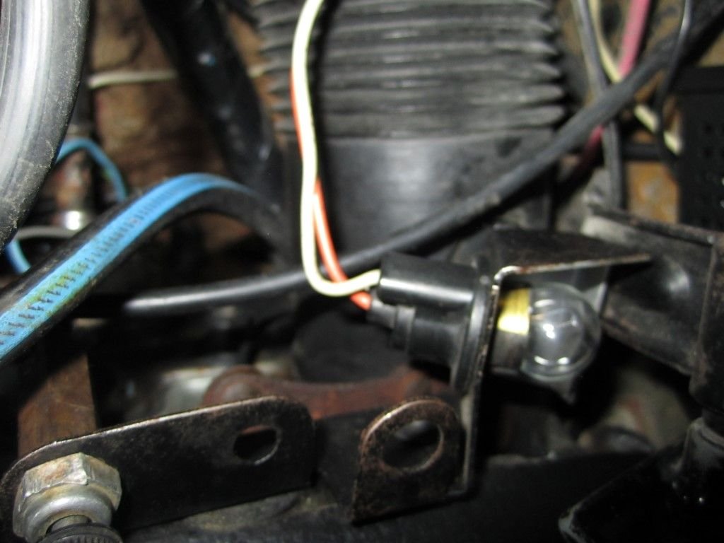

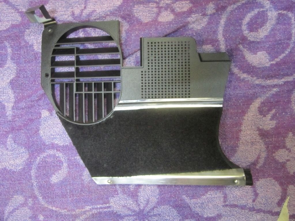

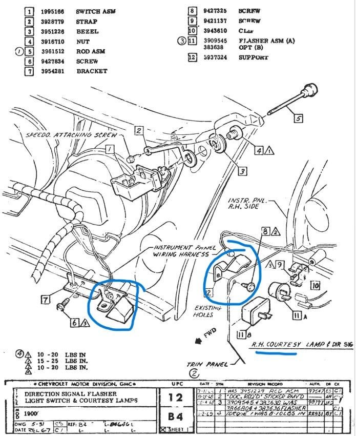

These are from my 72 but it should give you the idea of where they were located under the dash. The drivers side is on the bracket where the trip odometer reset cable is, and the passenger was screwed to the kick panel up towards the top front corner. I'm guessing 69 would be the same or similiar

OK, on the driver side that bracket is below the speedometer when I pulled the dash out I didn’t count how many Bulbs. I pulled out of the speedometer, so one of those lightbulbs must’ve been for the courtesy light ,but I know the bracket you’re talking About, The odometer reset cable wasn’t mounted in the bracket either like it supposed to be. Thanks again, passenger side should be a piece of cake!

The gauge lights will all have single wires, ground is through the gauge housing, the courtesy should have power and ground

OK found the Wires for the courtesy lights, one white one orange, No socket or bulb both wires on both sides are cut Bubba strikes again! and both wires are hot,I See the socket on the passenger side kick panel. Mine doesn’t have one there.

If the car had A/C the passenger light might be mounted to the duct box instead of the kick panel

Drivers and passengers side on a 69 look the same as the later ones
