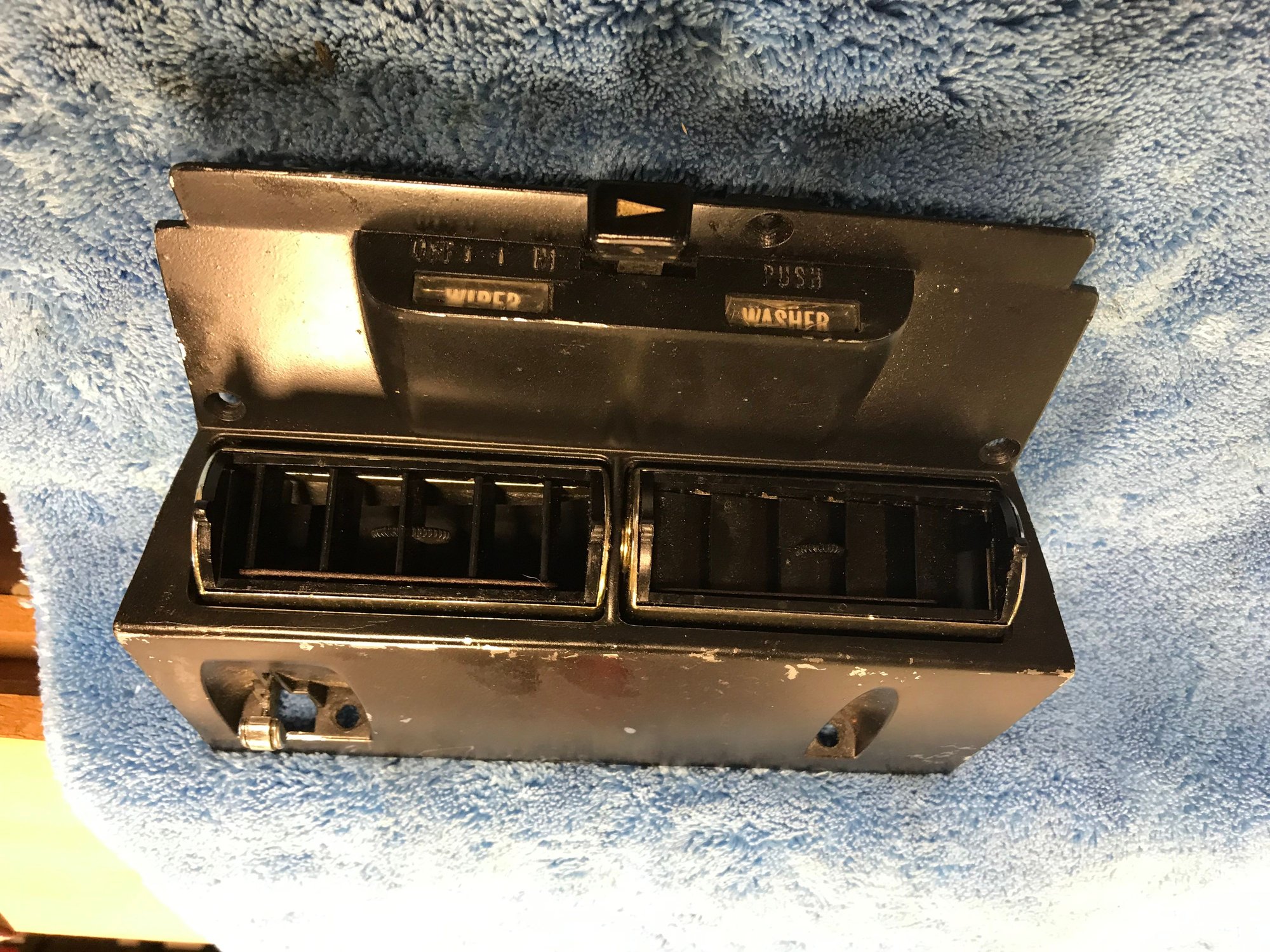

What is piece called? Any idea what year(s) this would be for?

AC Bezel and vents (deflectors) I think that is north of 1970 production at least due to the washer /wiper controls. Earlier C3s did not have the “wiper” “washer” windows.

It is pre 1978. My wiper **** is in the dash above the headlight switch.

Agree. I was thinking 73-77 as a guess.

The wiper switch housing/center air conditioning assembly pictured by the OP is a 73-76 part. It installs in the top of the center gauge bezel. It will fit 68-72 also, but the appearance of the 68-72 assembly is different. 68-72 had "Washer" and "Wiper" cast into the housing, instead of having the opening with the lens in it with the words on it. The wiper button with the arrow on it is correct for 73-76 also, while 68-72 wiper buttons said "Washer Push" on the button. On cars without air conditioning there is a panel across where the two vents are that says "CORVETTE" on it.
77 and 78-82 used a completely different center gauge bezel and the wiper switch was part of the steering column in 77 and on the far left side of the dash in 78-82.
