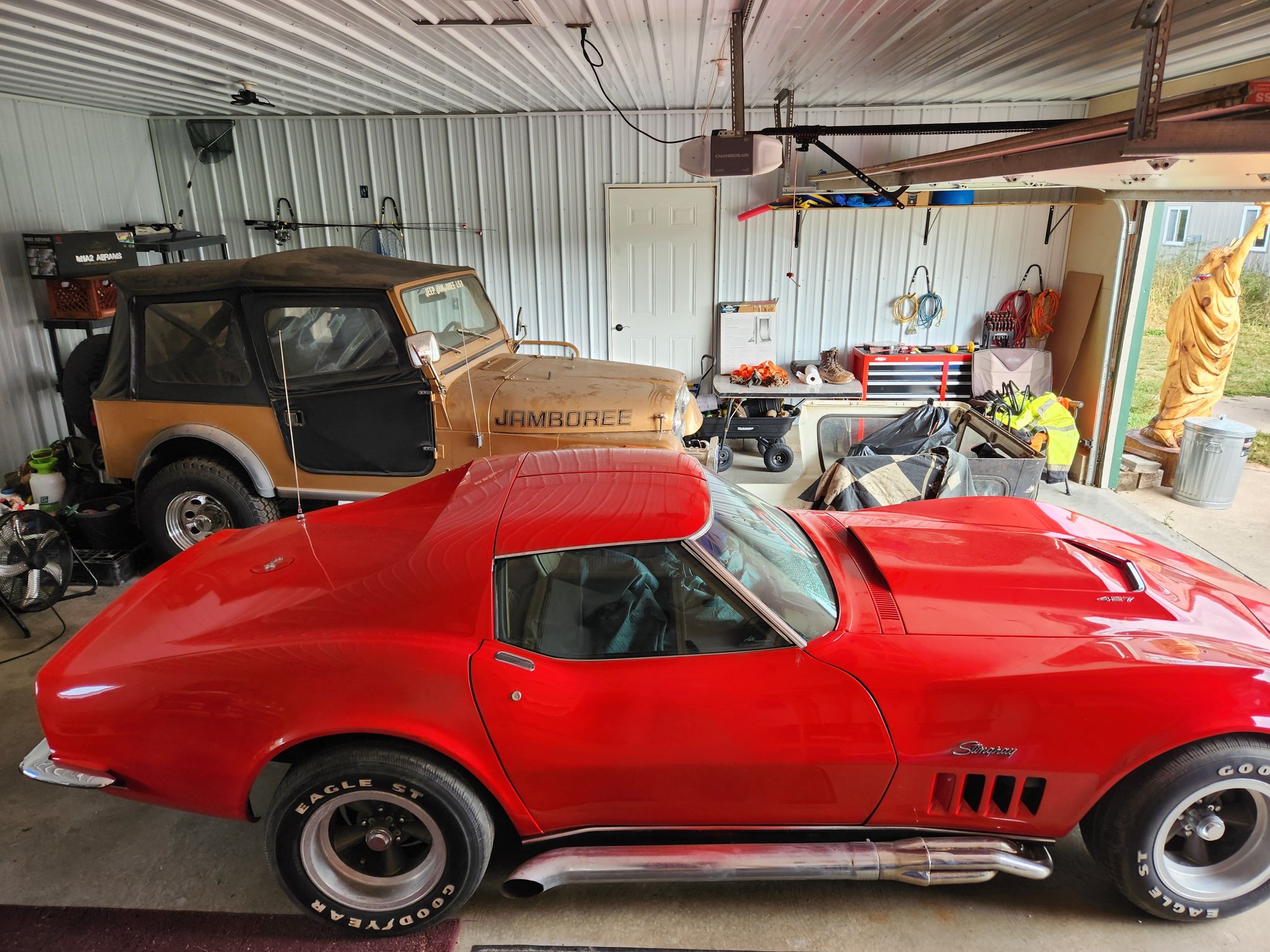

This is the 69 I bought from my brother's estate. It was a barn find he picked up. The front end is a shark I believe. Note headlights are in grill not on the fenders. Could that be factory? 1969 427, 4 speed. Still needs some work but he had it running before he passed away. Then the day of his celebration of life a family friend hooked the battery up backwards, but that seems to be a problem of my getting home to find fusible links and testing a few electrical parts. Do I need to buy a new front end as well??

If this is now your car, you don't have to answer to anyone on how it looks or what you do. If you want to return it to original, go for it. But it certainly is not "wrong" to drive it as a customized C-3 - there were a lot of them back then and you have a "time capsule" of that era. I dare say it will get more attention in custom form.
My suggestion is FOR NOW, get the car safe and reliable (new brake lines, tires, radiator hoses, whatever else has deteriorated) and get it on the road. Get to know the car and run up some miles, THEN decide what to do, or not do, about the nose. You may grow to love it, you may grow to hate it. Either way you'll have some fun getting there.

The headlight placement is not factory - for all C-3 Corvettes ('68-'82) they are a pop-up design located in the top of the hood surround above the bumper area. If you want to return to a factory look, then, yes a new front end is in order. This won't be cheap as you'd need to replace the chrome bumper, support hardware, headlight buckets, and all of those mechanisms as well. Who knows the history of the front end and why it was changed -- could be due to a collision that could cause further fitment issues of the necessary parts.

No 69 Vette ever left the factory with that nose and headlights. Aftermarket, for sure. Whether you change the front end is up to you.

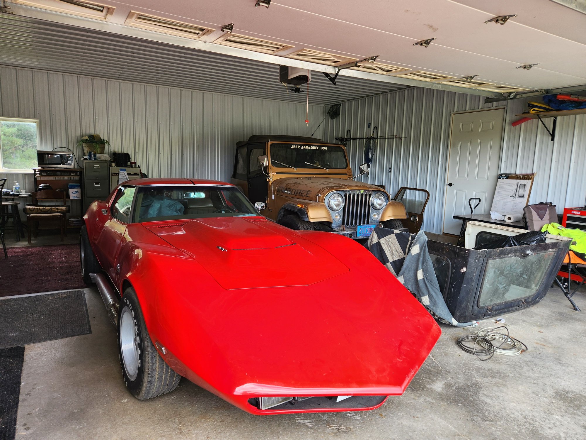

That Mako nose looks great, I would leave it. Its a rare look so you will be an original at any cruise in or car show. As for the wiring once you get it in the air you should find the melted wires pretty easily. You can check the wiring under the hood on th edrivers side now...it has a few fusible links near the horn relay. Thats an important part of your wiring as it acts as a buss bar for the interior power as well as the starter have a power line going to the firewall socket
