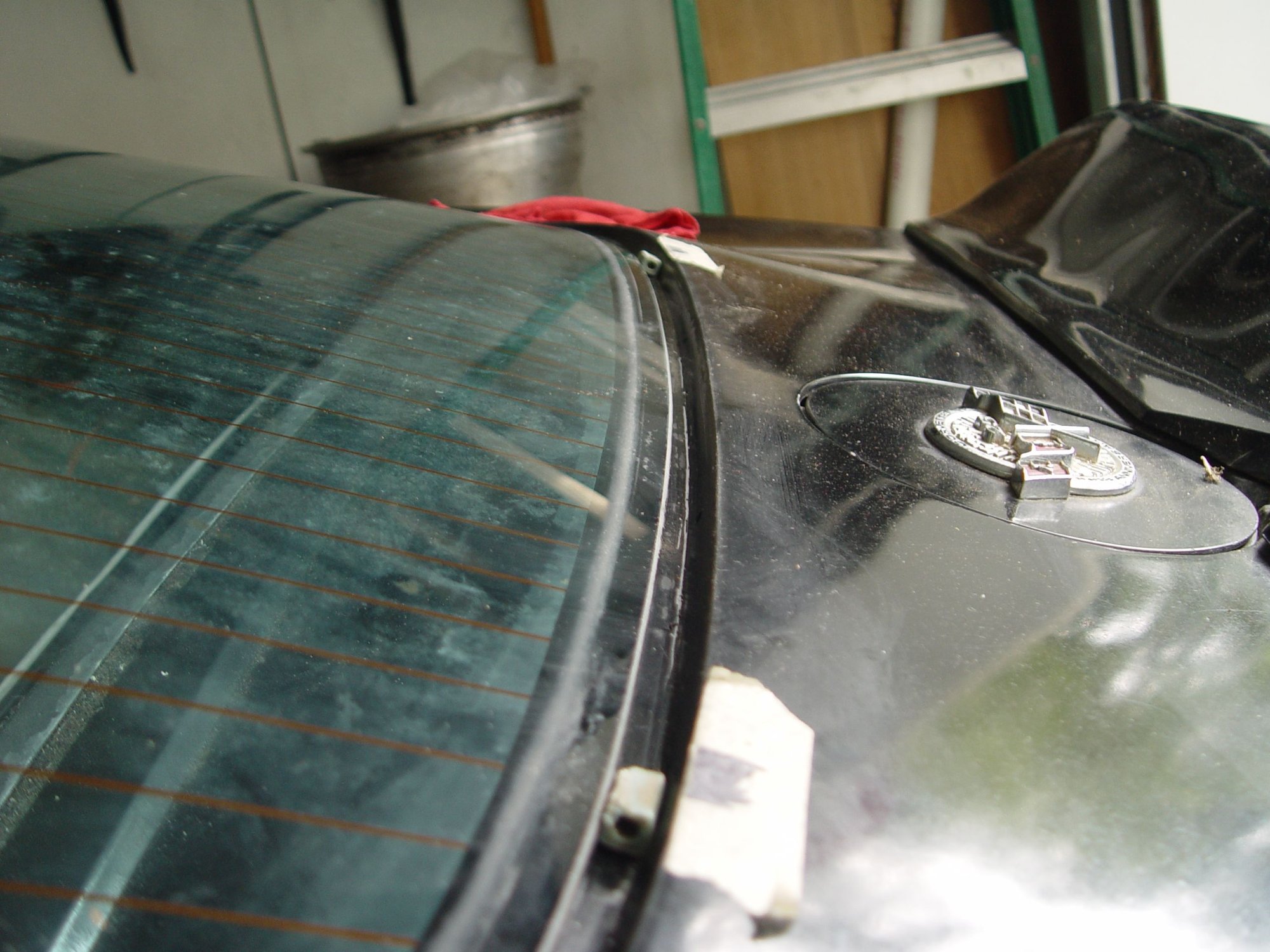

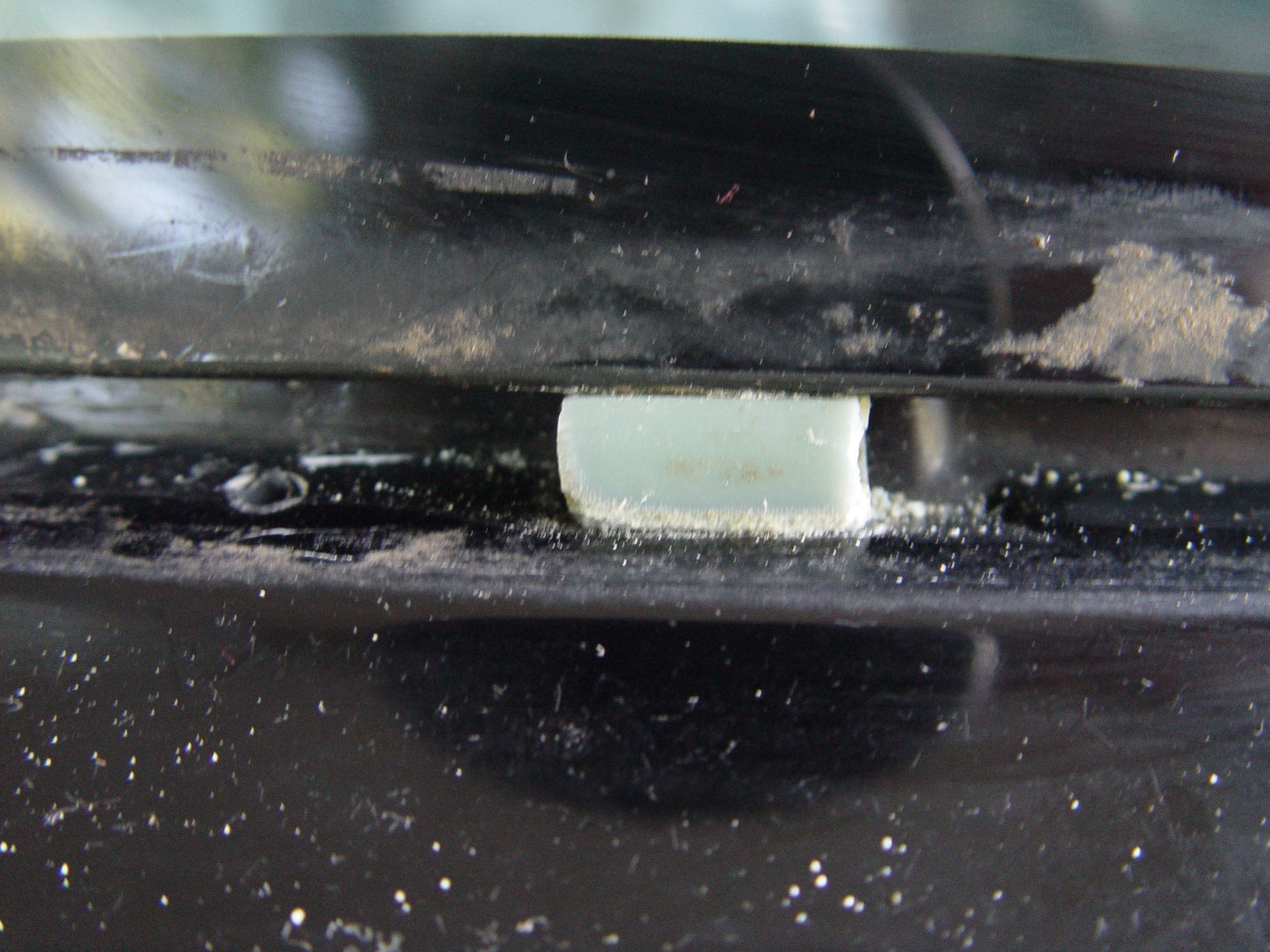

I see this latest 78 adventure began in January. This past weekend with temps in the 70s, I got out and finalize removing butyl (or whatever is was) from the body rear window frame. I also "fitted" the rear window with the original blocks. But, i quickly realized fitment isn't easy. So questions remain and hoping those that have been here before can provide their experience. You'll see from the images of where I am at.

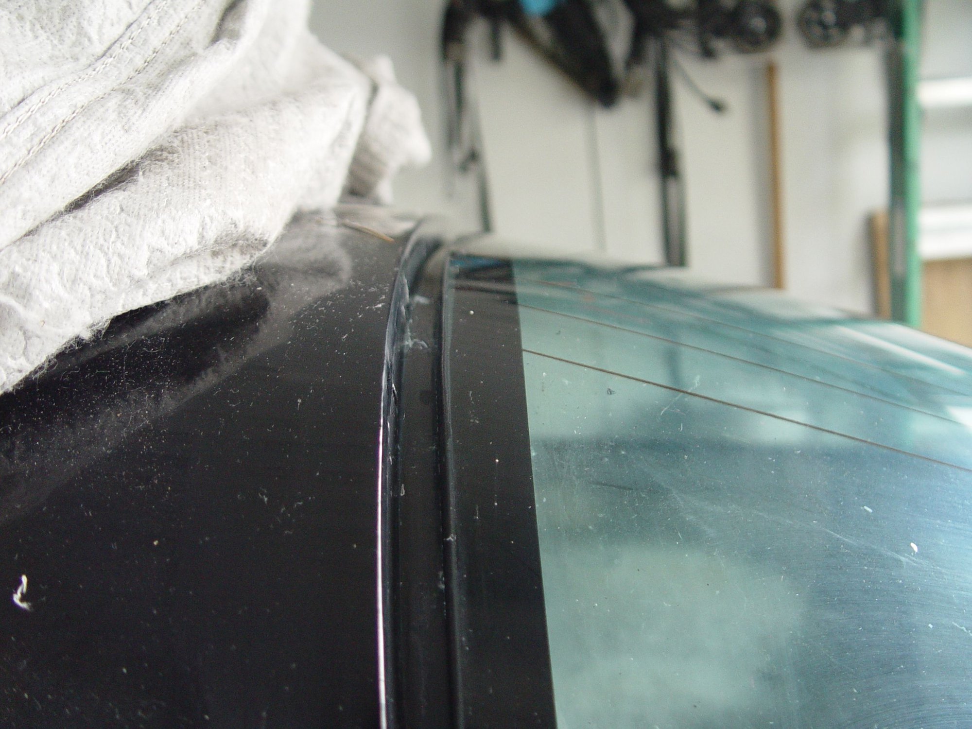

With the window in place I see gaps.
  • Should the window edge rest on the blocks?
  • Or, at the bottom, the intent is that they do not rest on the blocks but provide a spacer to push/close the gap at the top.
  • It seems the top blocks, the window ledge rests, while at the bottom they work to "push" the window forward and close the gap at the top?

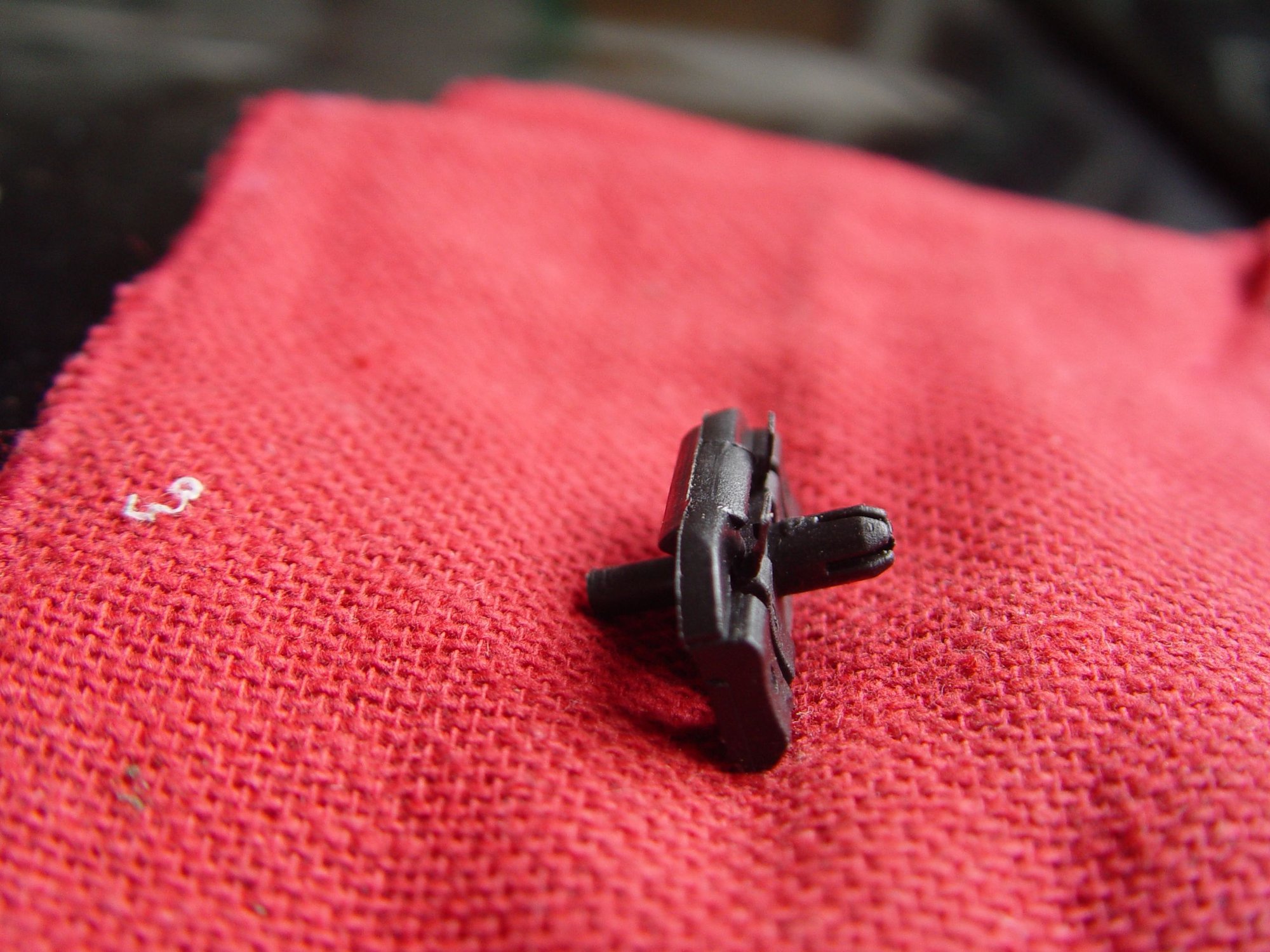

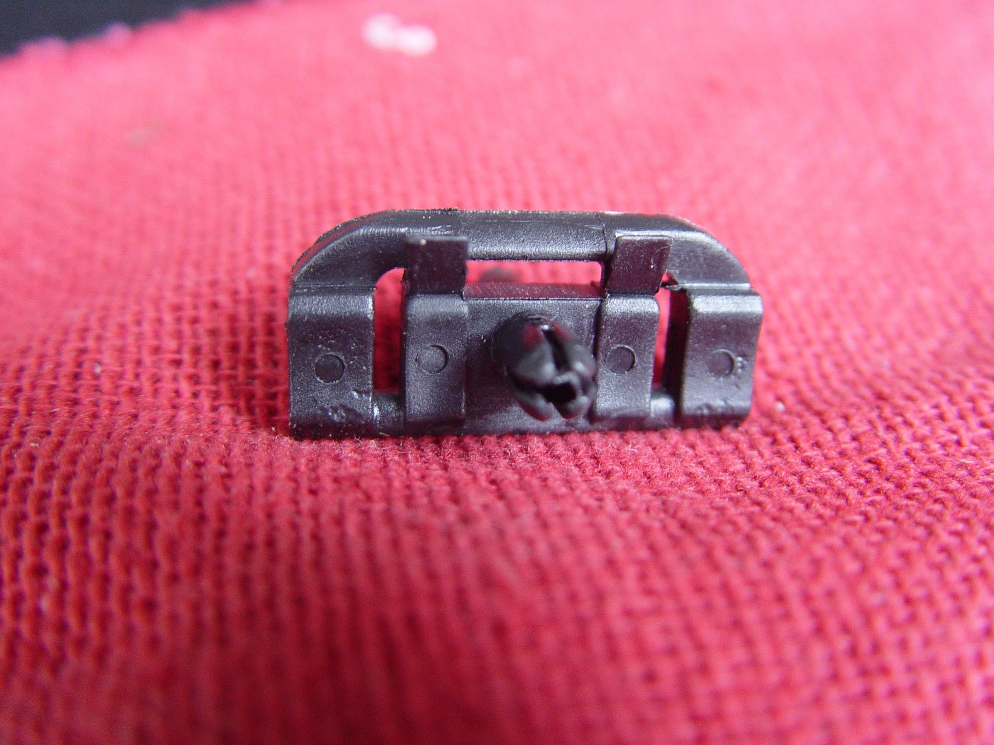

  • You'll see the trim tags not in place which will consume space and tighten that gap
The rear window in place
Window and the blocks...these are the original blocks or spacers

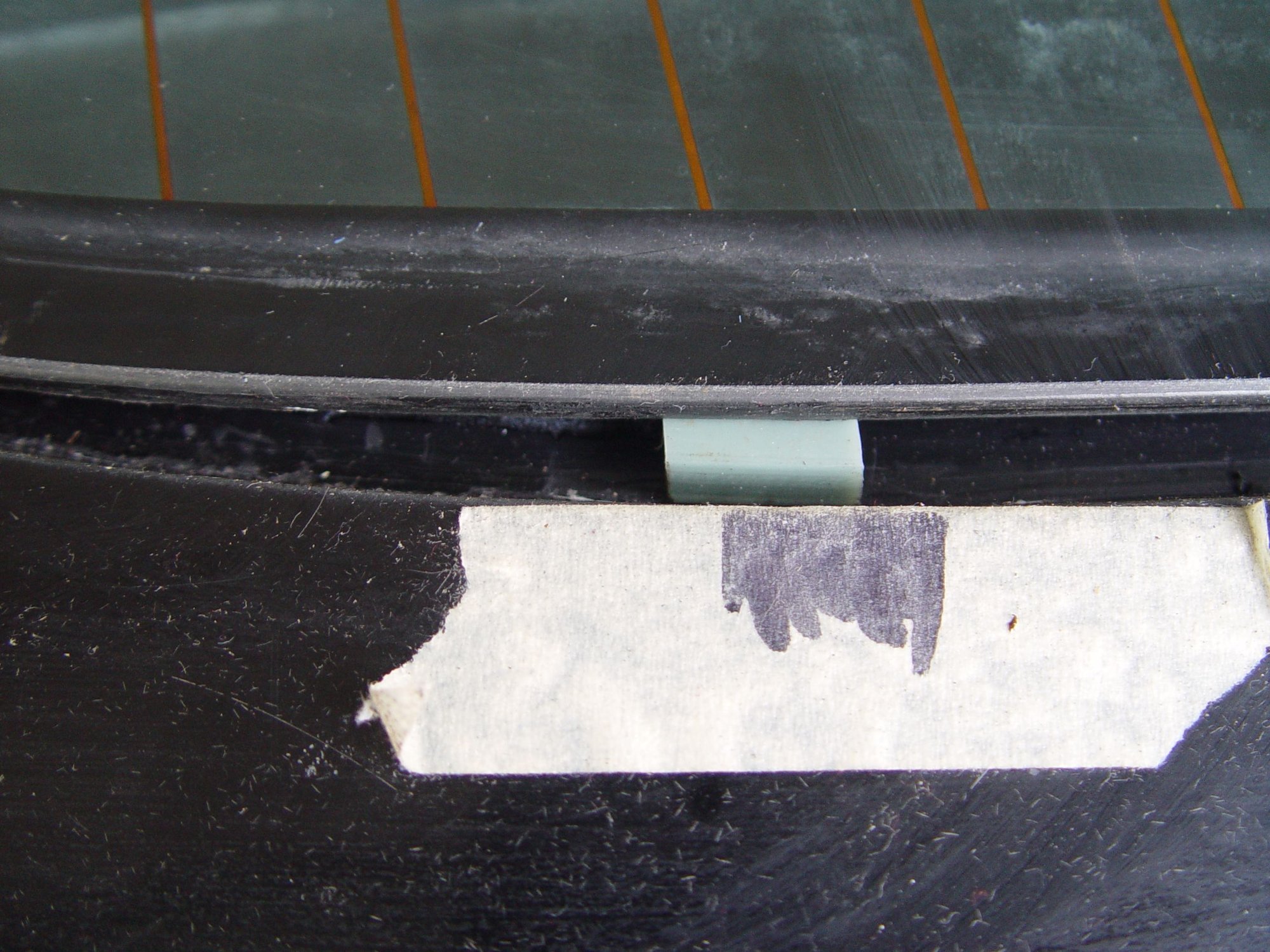

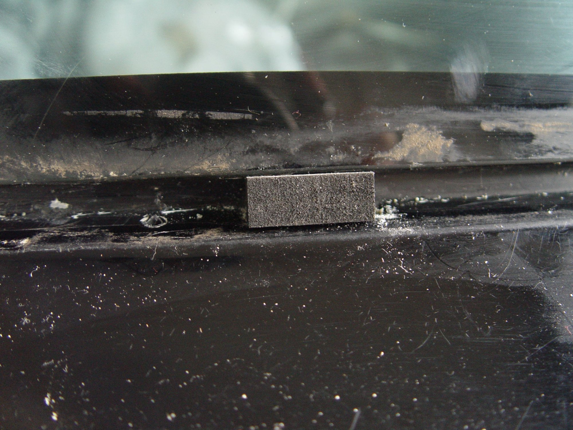

I appreciate the detailed explanations...helps to visualize the situation. I figure that the blocks on the side, with the window resting on them provides that gap side to side. Likewise, the blocks at the backend, with the glass edge laid against the edge, manages the gap at the top.

The old butyl, was removed from the inside edge of the window and not the edge that faces downward. The butyl on the body (bulk of) was removed from the edge facing upward. I'm speculating here, but if the butyl is set on the body, it would seem the glass edge would push it downward, or roll as Rick describes it. Anyway, I played with the blocks. But a question back to kanvas, the trim clips: it seems that plug facing outward needs to be removed?
Here are some images of the blocks and their spacing. After moving around, it seemed the Zip blocks worked best on the sides to "elevate" the glass edge while the old blocks at the rear, provided a space for the gap at the top.
The blocks
The gaps
The trim clips
