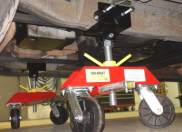

There's this type as described above. That run about $320 plus shipping for 4.
Or this type that may be what you're looking for as the attach to the frame.

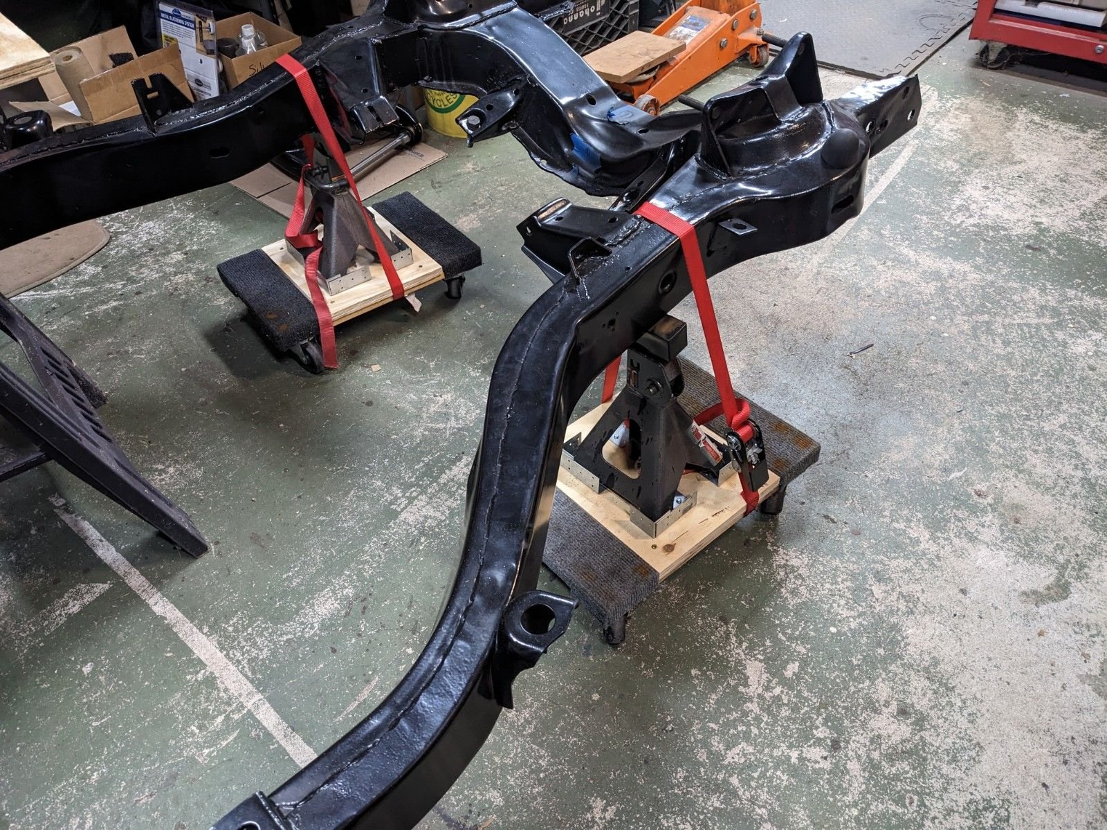

I just put a square of wood on a set of car tire dollies (to cover the "dip") and place jack stands on them to hold up the chassis. Works fine for moving the car around my garage but probably would NOT be the way to go with your car a commercial garage...
