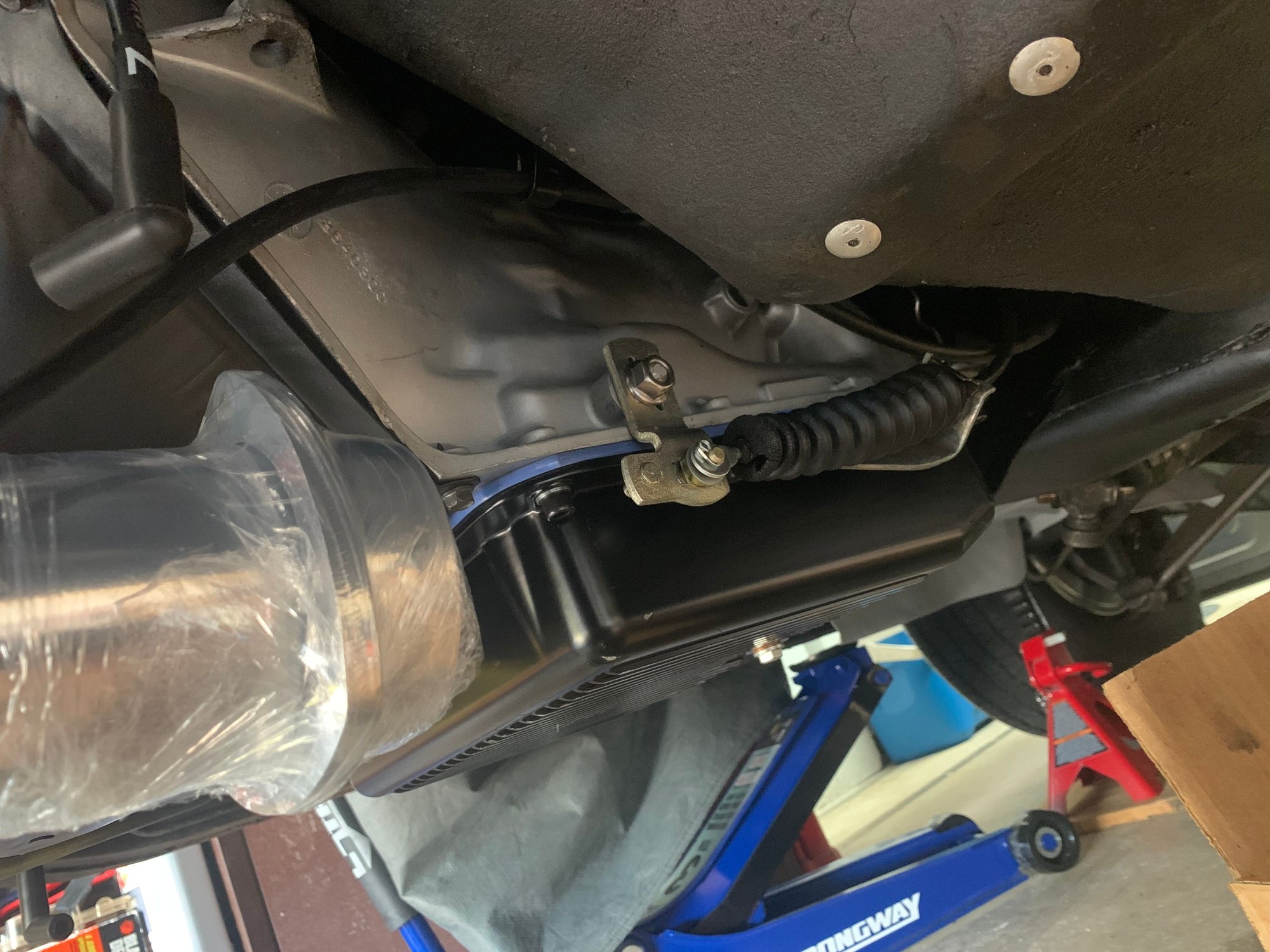

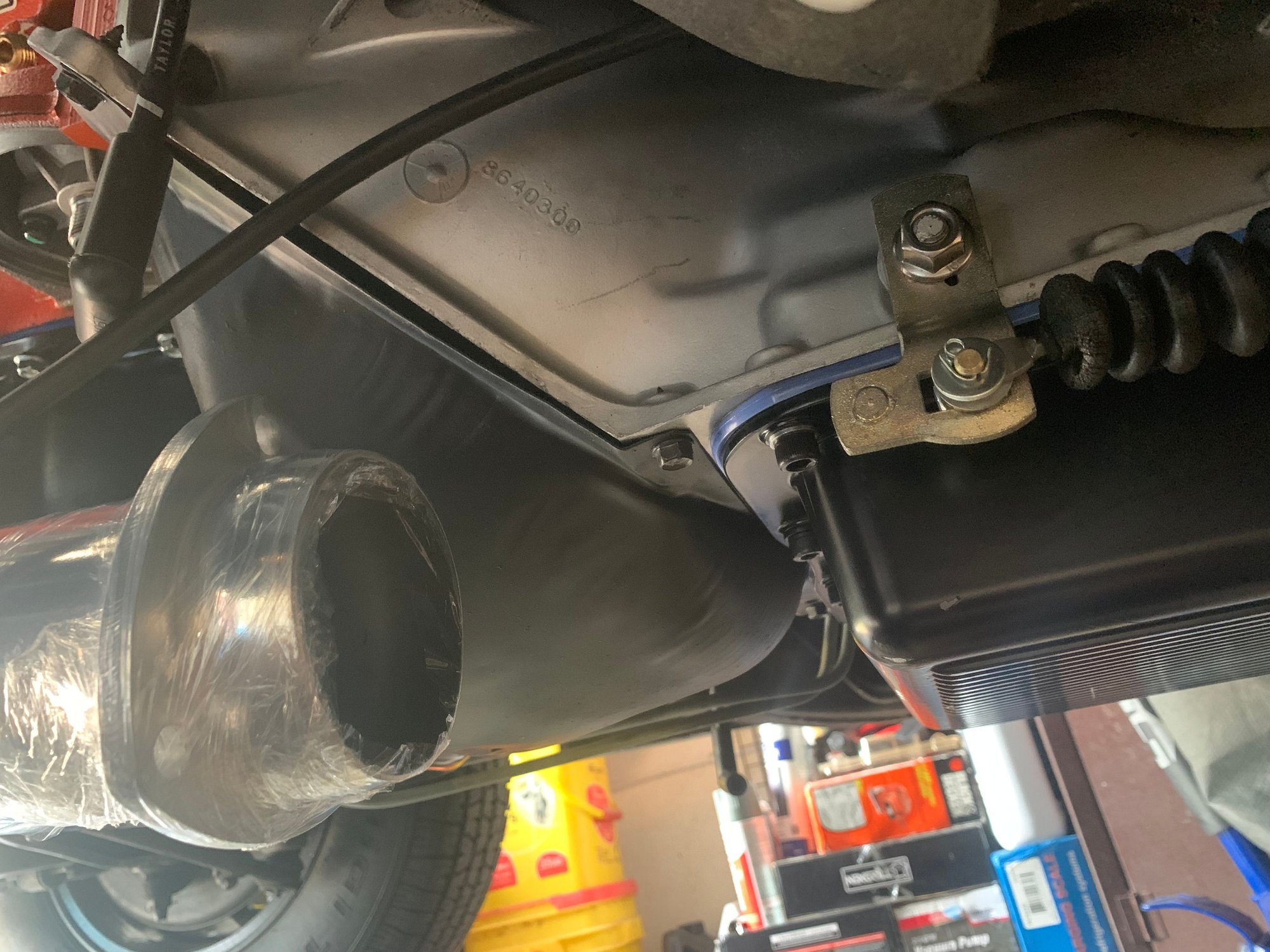

Hi, how close do the Doug’s D350 clear the transmission pan around the shifter linkage, I just purchased a set of Hedmans #68306 and it does clear the pan but awfully close? I have a new BluePrint 383 with 1/2” raised port heads haven’t gotten to the passenger side yet. Anyone please feel free to chime in.
