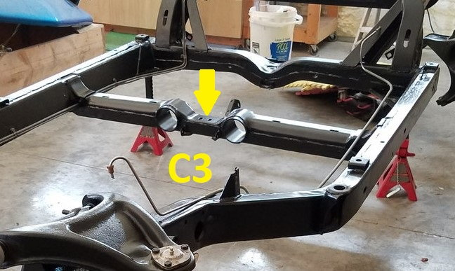

It’s a 78 automatic chassis which I wish to convert to manual (Muncie) I am told this convers the auto crossmember to take the manual mount

I think this is what you're looking for. From my 68 AIM. Let's see a picture of the top, and front, of your crossmember. Might have to weld on the 2 little tabs for the horizontal bolts. No biggie.
If you want pictures of an actual crossmember just say so.... I replaced mine and have the old one out.

A picture of your crossmember would be great thanks

Not mine but a picture of a c3 crossmember from a conversation on the c2 forum.
