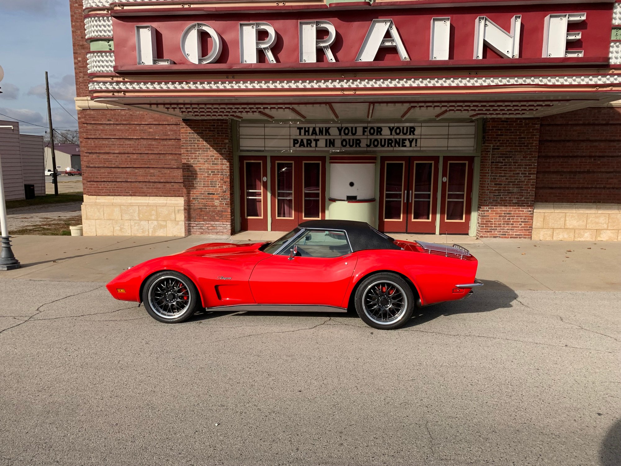

My 73 has a hardtop and every time I hit a bad bump the hardtop makes a loud cracking noise. I installed a spreader bar thinking that would help. It drives me crazy.

Beautiful car man!

Thanks,I love driving it but the top creaking drives me crazy. I should not compare it to my 14 convertible.
