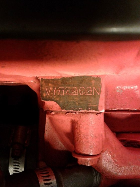

I have what I believe is a 1976 small block 350 replacement engine which has the dipstick on the right side (passenger side). It has a 3970010 block casting number with casting date J196. Engine stamp pad is V1022C2N which so far nobody can identify. Likely my engine was originally from another car or truck and not a Corvette which might explain a SB gasket mix-up.
Engine code C2N is problematic, should not have the number 2.
Here is a picture of my engine stamp....wonder what else could it be?
There are other references to C2N on the internet and it appears in all cases nobody knows what it is. Also the other numbers are stamped over it and appear to be too long for a partial VIN of 6 numbers. Do the last 6 numbers match the last 6 of your VIN?
No does not match...I guess with a replacement crate engine they may be able to put any code on it. Since there is a VIN like stamp I though it might be an engine taken from another vehicle. It is very strong and acts like it has a cam upgrade as it really goes at higher RPM's. I will check for a drivers side dipstick plug that was mentioned.
Or perhaps the previous owner borrowed an engine and had a good stamping kit....the car was from North Carolina after all.

I have never seen a engine stamp like that where it's been stamped over other numbers and letters
Notice the broken corner on the smaller pad as well. Likely bought from “Hot Engines Are Us”.

I believe your thinking of "Midnight Motors sales".
But seriously. If you were doing a Midnight restamp. One, you certainly wouldn't miss by this much! and Two, look how straight the over stamp is. This was done with a gang stamp.
Midnight motors isn't likely to have such a tool. This looks for all the world like sloppy factory worker work. Not Midnight motors.
And look real close at that lower left corner. That's not broken or chipped. That's as cast. And perhaps why the second stamp was put on a bit high. But then misjudged and went a bit to high. Once stamped, clearly with a gang stamp. The worker said, oh well, close enough, you can still read it. And down the line it went.
Yes but the overstamp should start with a 1 for chevrolet followed by a number for year and a letter for the plant followed by the last 6 of the VIN.

I don't know. Mine reads 17S then my 6 digit vin.
are you certain they all read 1, then a letter? I'm certain mine doesn't. And mine clearly isn't over stamped like this.
of course all of this means very little, other than its a non original engine.

Because of trying to figure out my whacky 1968 VIN engine stamp (171428087), I have been collecting pictures of early year C3 Corvette stamps over the years. Do not know if they are original engines or not however in my collection most SB are of the 1XSxxxxxx format. There tends to be a correlation between the year of the car with the second digit as there are 17S (early 1968?), 18S (1968), 19S (1969), 12S (1972) stamps. But not in all cases...a 1970 car has 70S and several 1971 big blocks start with C11S. And then there are a few that had all numbers and 7 digits. But no other VIN over stamps of 9 digits in my collection.
The mystery continues....
