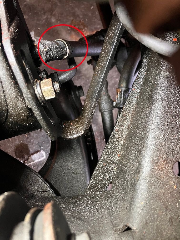

All I did was go to put a few gallons in the tank. Drove up to the station a few miles away and just 20 or 30 feet from the gas pump, a huge plume of white smoke came our from everywhere and 15 seconds later it was gone. Power steering fluid went everywhere. Fortunately the drive home was only about 3 miles.
Any chance the pump was damaged? I heard no noise coming from it but I just thought I ask. Looks like the return line failed quite dramatically. Wouldnt surprise me if they're all the original hoses. Im going to change them all anyway but the pump is my only concern ATM.

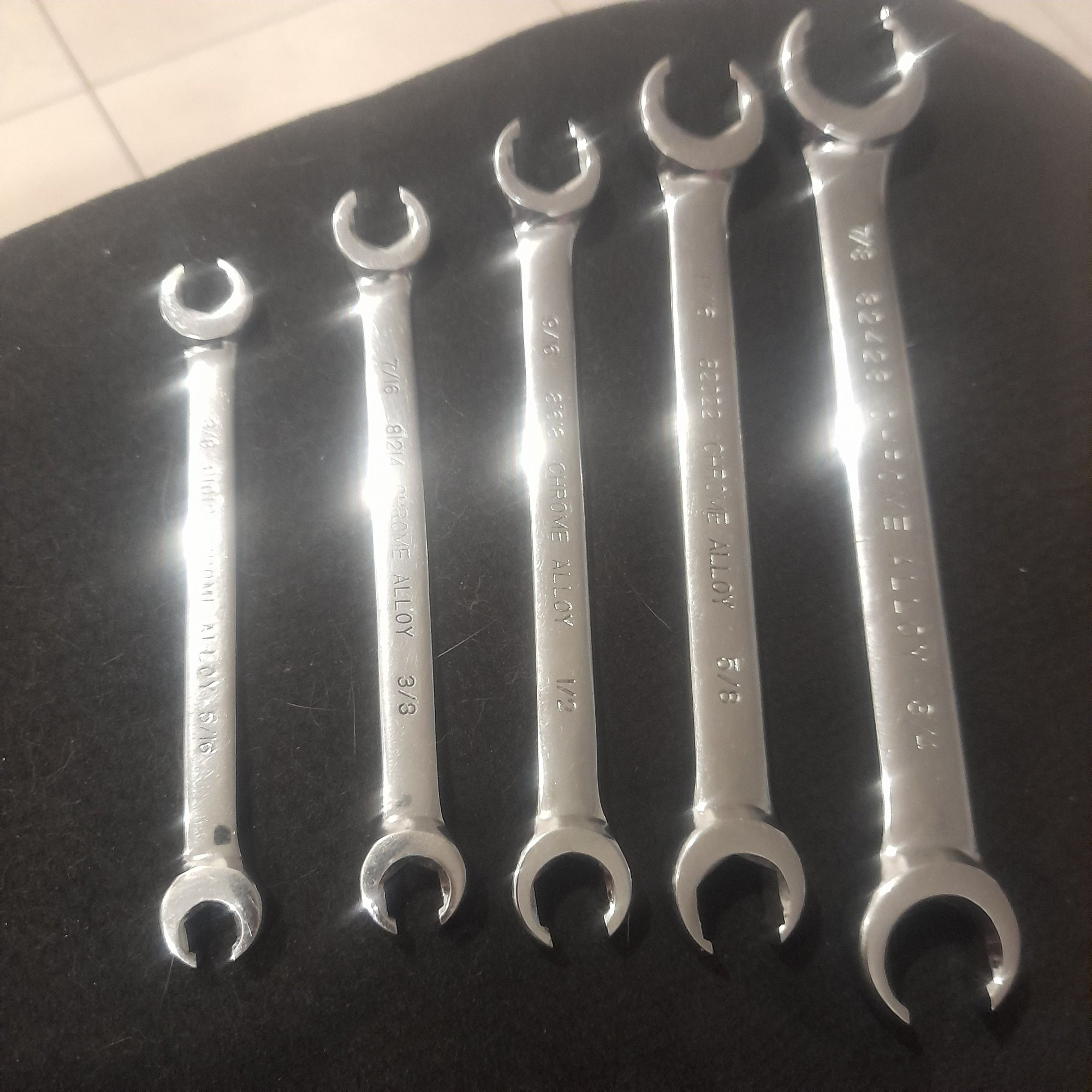

Don't order a set of 4 hoses. Order 2 sets. And purchase some really nice flair nut wrenches as well. Your going to use them a lot if you keep your C3.

These. If you don't already have them. You need them.

The return line is the only line not under pressure. It's usually the last rubber piece to blow.
You will find out once you get the front up on ramps.

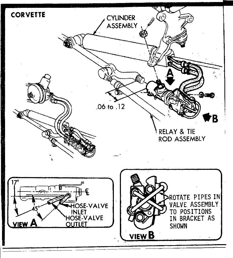

Find a drawing on the net showing exactly how each NEW hose is to be routed. I would do one at a time.
Note that two of them crisscross.
Not that one end of a line goes in on a angle. Do Not cross thread that.

This might help:
Old Feb 8, 2024 | 06:05 PM

Got the return hose replaced yesterday. The clamp at the pump side was a crimp connector, similar to what they use on PEX tubing or something like that. The other 3 hoses dont look any better so I'll change them also. I think they are original but even if they are not, this car sat for 22 years so they are at least that old. Anyway, how much total PS fluid does this system need?
