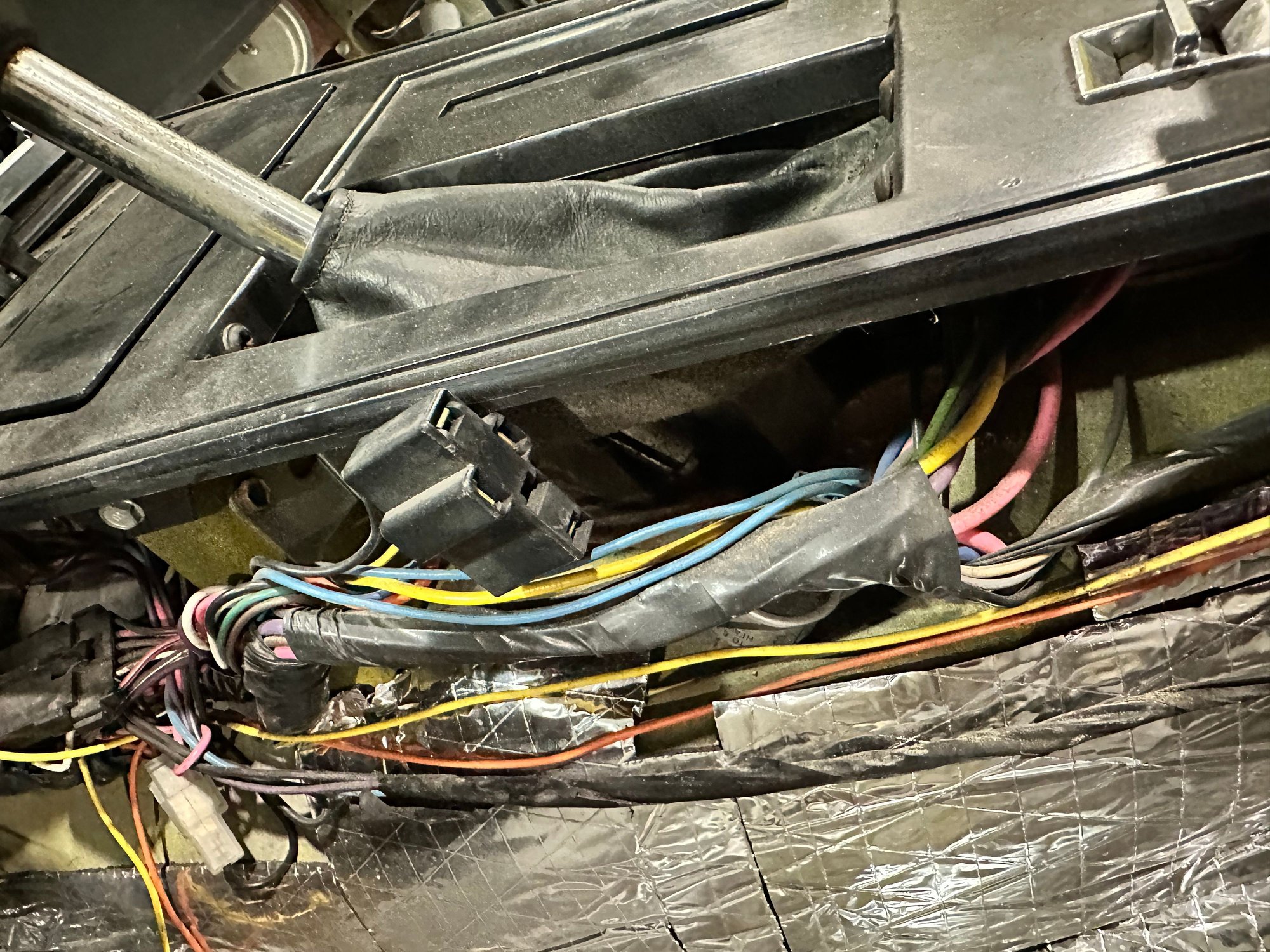

What plug is this?

What is this for?

Probably for the blower switch

I cannot see all the wires on the back side of that connector but if they are Black, Yellow, Orange, Dark Blue, Light Blue, then it is the connector for your Anti-Theft relay.

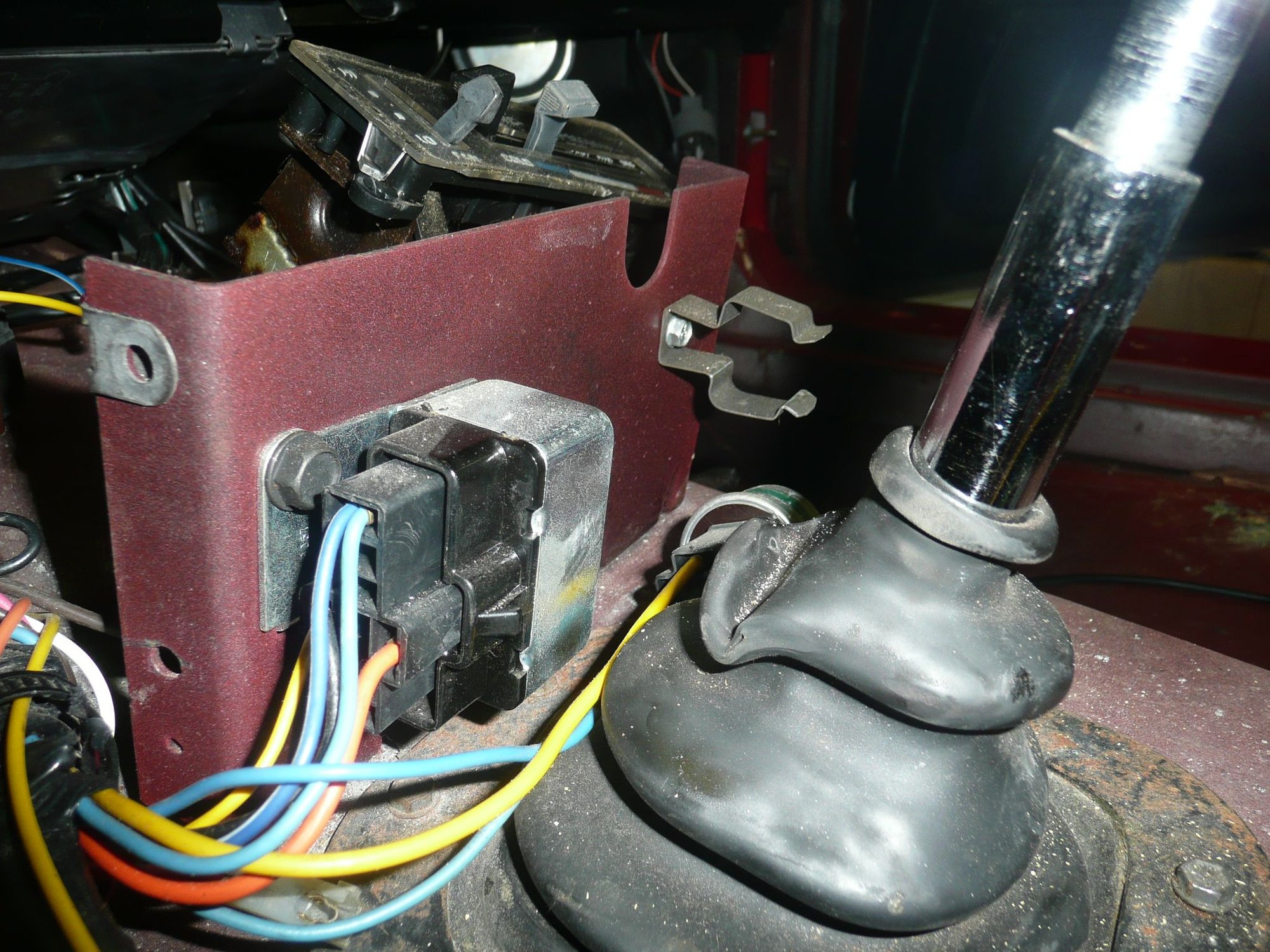

Looks like this one. I believe it's the anti-theft relay. This is from my 79'.

Factory alarm relay.

Some guys unplug it to stop battery drain when the circuit is active. With it plugged in T-top switches need to be disconnected if you wish to activate the alarm with the tops out.
