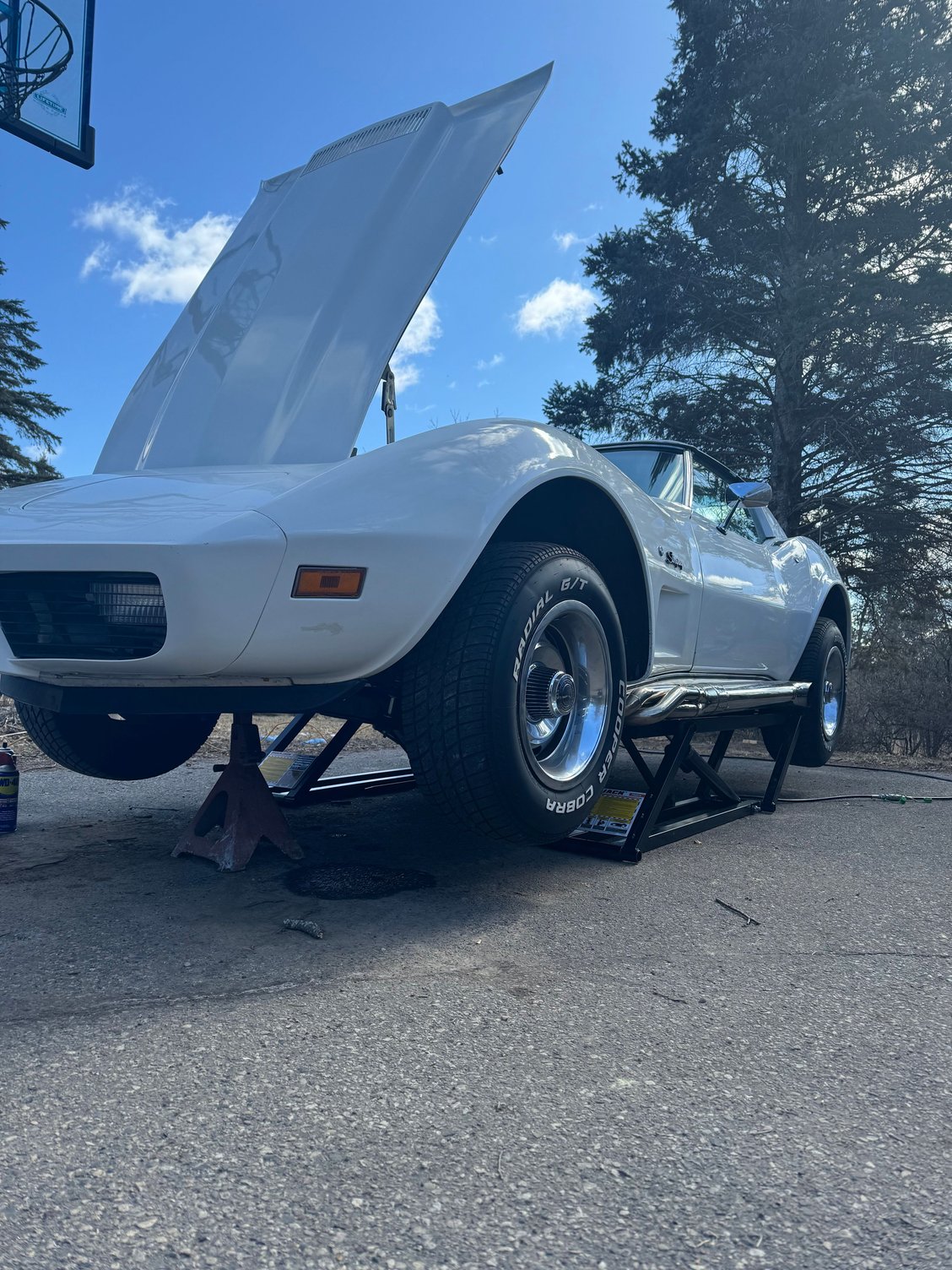

Just lifted my 76’ with Doug’s headers and side pipes for the first time yesterday. Looks very similar to the ones you have on your car.
I’m using the 7000 lb version with the taller blocks that come in the kit. They get very close to the pipes, but the blocks touch the frame before any contact is made. With the jacks all the way down I have plenty of clearance to slide the blocks in from the side, so having clearance even with a lowered car shouldn’t be an issue.
Two things I didn’t like about it though. First I used the thread sealant supplied with the kit, and almost every single fitting leaked! Save yourself the headache and use at least teflon tape if not both tape and the sealant on the threads.
Second gripe is that the blocks have to sit at their closest position to reach the factory C3 lifting points. If you are planning on lifting any other vehicles I would definitely recommend the 7000 lb model, but if you’re only lifting the vette the 5000 lb model would be a better fit. I doubt an extended wheel base model would fit underneath a C3.
Well worth the investment

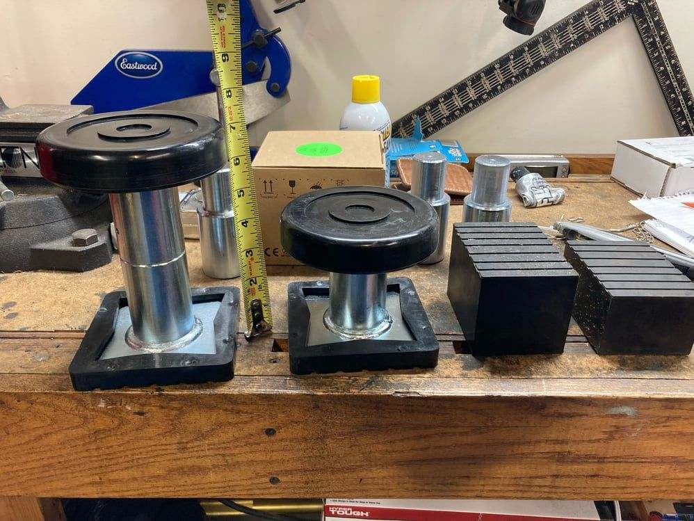

Maybe for those with side pipes..an suv adapter would help..for clearance as well?
https://www.corvetteforum.com/forums...er-and-c3.html

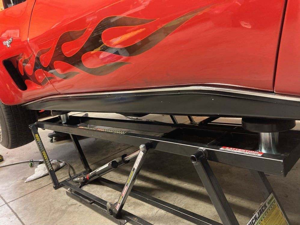

I use the SUV adapters for clearance with my sidepipes. Due to clearance (BBC), I need to run the car up on 2” ramps prior to using the Quickjack. Quick Jack says you need an inch of clearance to build pressure. If I just used the blocks, I don’t get that clearance. May try it anyway next time I use the QJ.
Don’t remember if I have the 5k or 7k unit.
