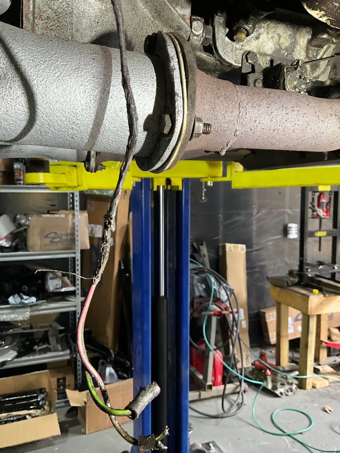

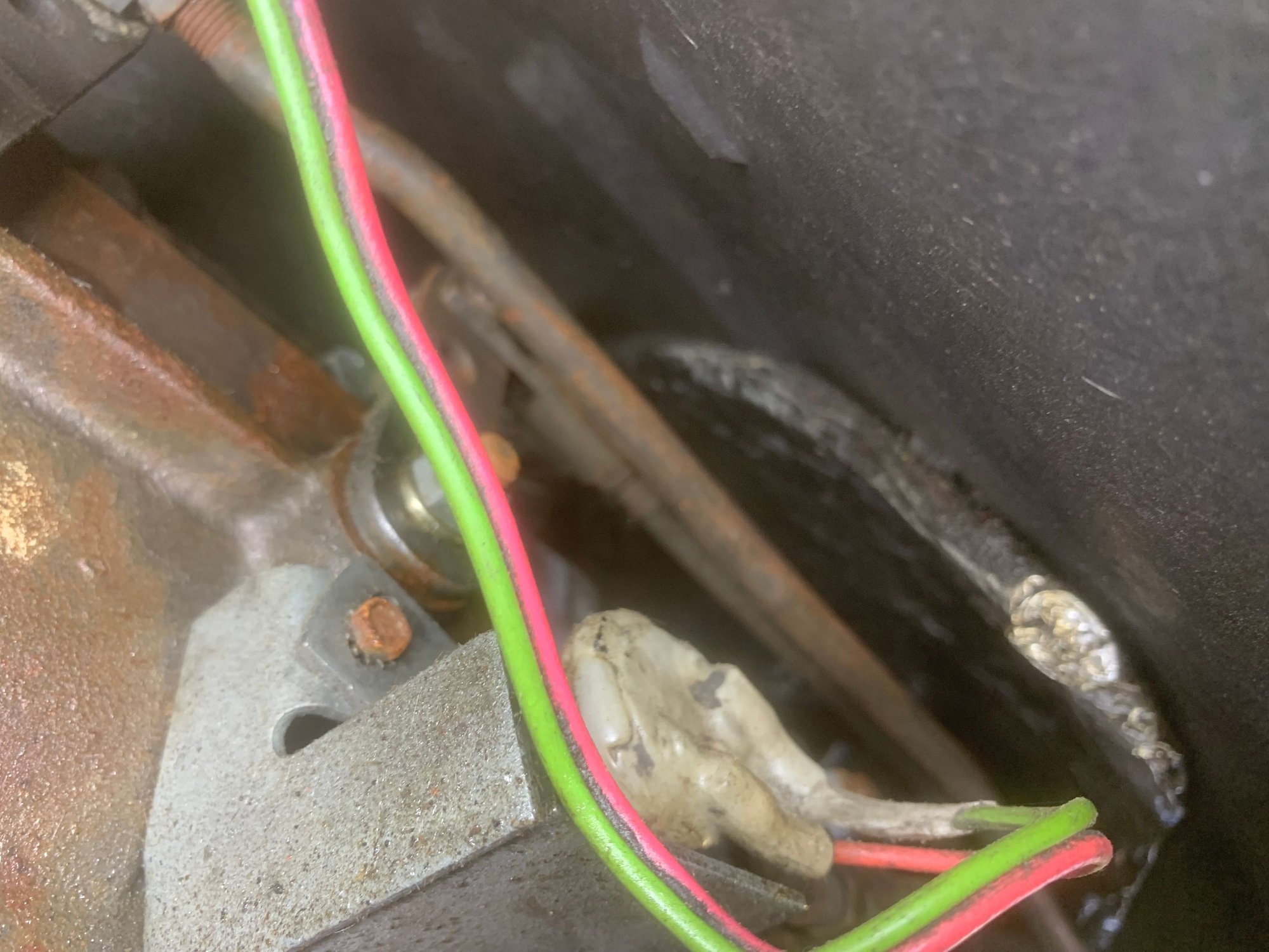

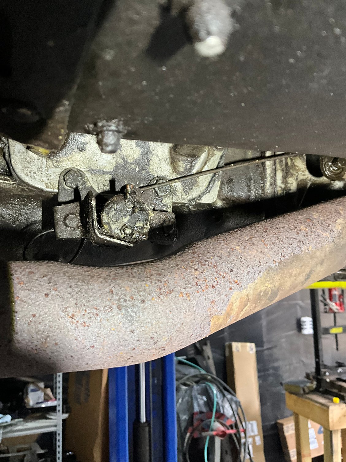

Hello gentlemen. Yup still working on my 73. Started as a head swap but it just keep getting better, anyway can someone tell what this is. Is it located on the transmission. Manual transmission , the wires that went to it are toast and not connected any longer. Any help is appreciated

Back-up light switch.
https://www.zip-corvette.com/68-78-b...ht-switch.html

The wire from the switch attaches to a plastic wire connector located under the power brake booster, if Bubba didn’t remove it. If you order a new switch, be sure and get all the parts that go with it. There are tiny metal locks that keep the switch arm on, just look in a vendor catalog that has a good detailed illustration.
