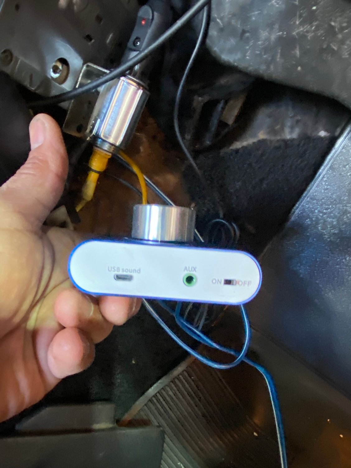

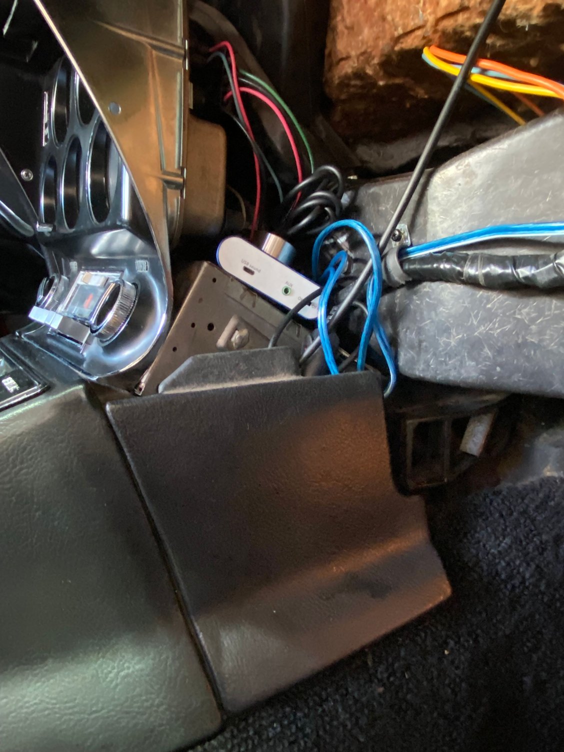

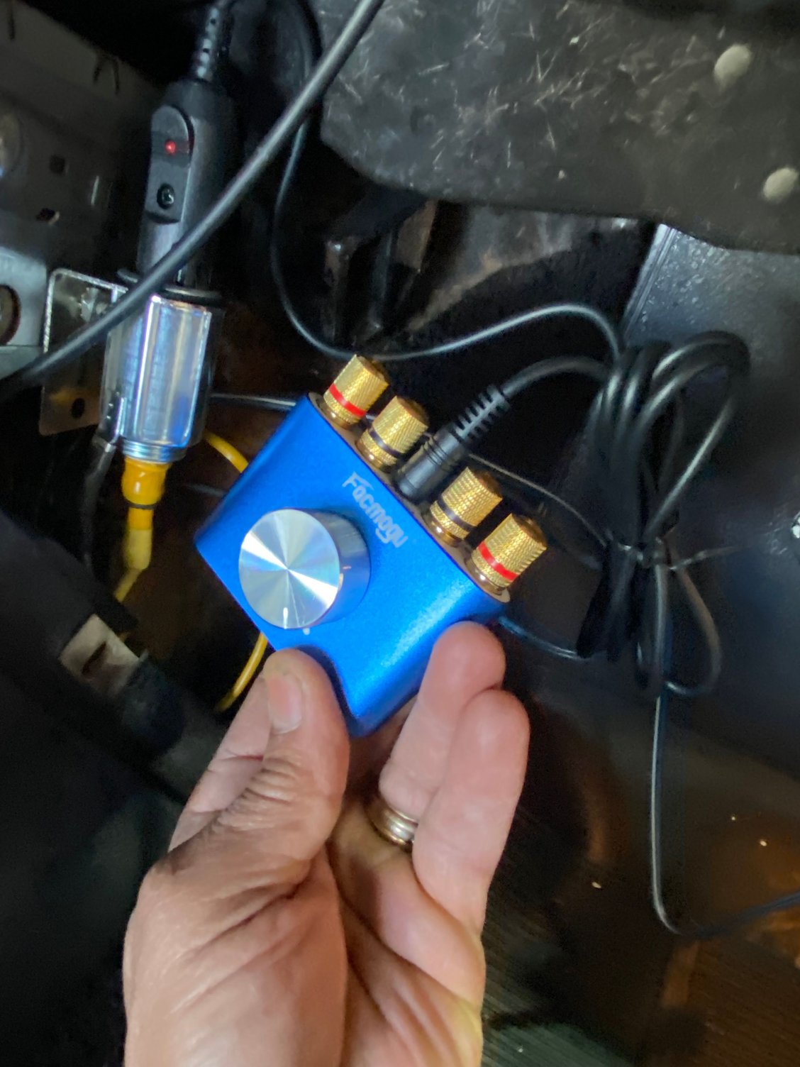

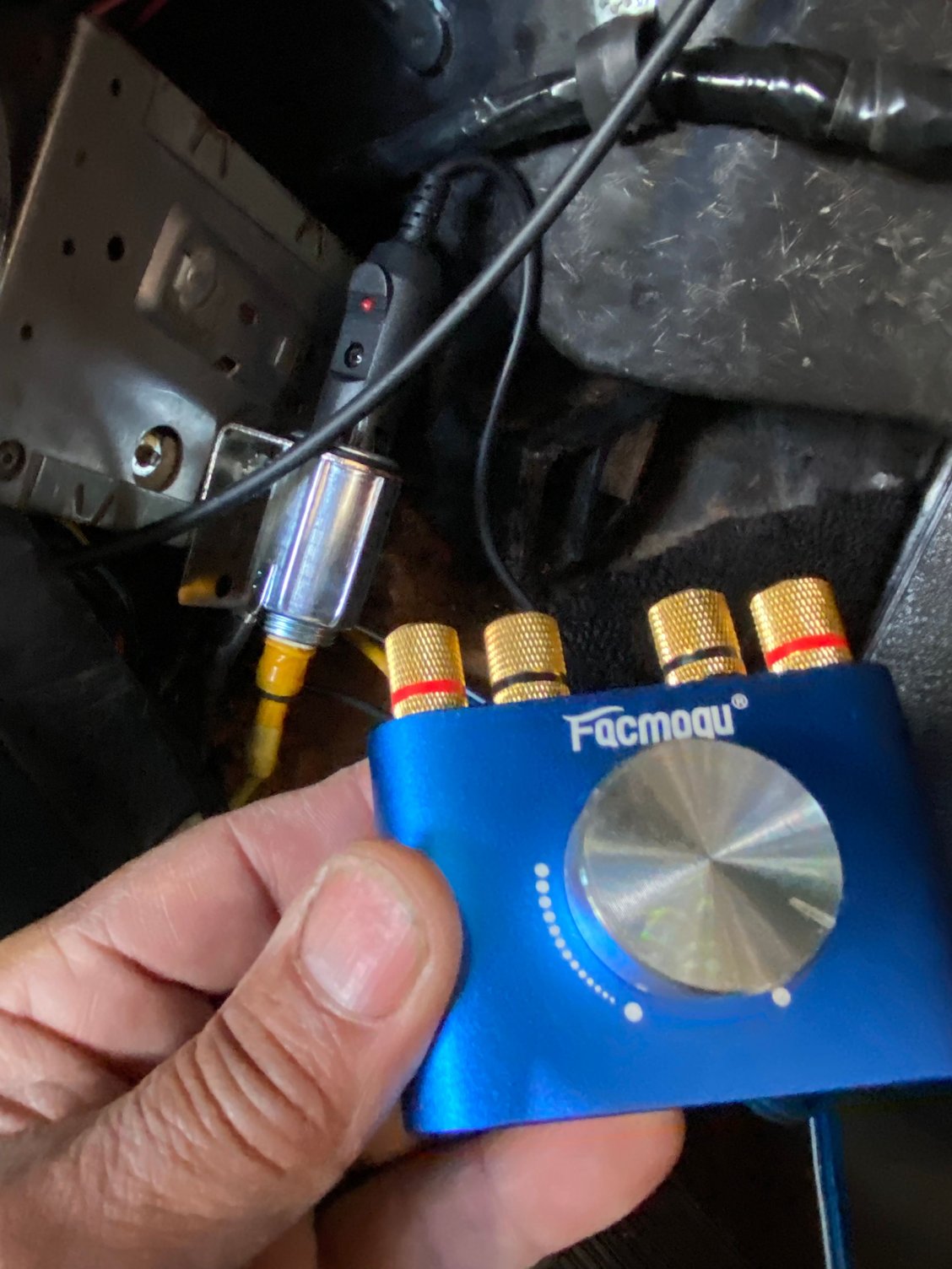

Not in the storage compartment but here’s exactly what you are asking about. I used existing front speakers.
Used electric power for the existing radio, the existing radio is non functional. A constant battery 12 volts could be used for the storage compartment setup, just pull the plug.
Small 160 watt Bluetooth amp, nice speaker connectors.
Fits nicely. Sounds good…. I plan on replacing the existing speakers for a new pair.
