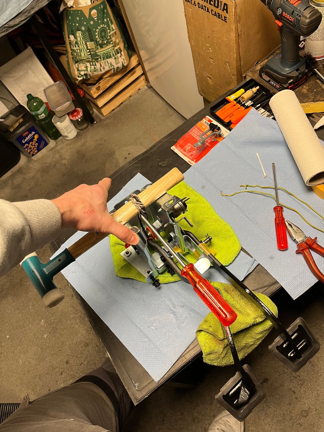

Thank you, this has helped me a little. I was wondering which is easier the curved part around the pedal or the small hole on the other side. Four hands are certainly an advantage, I thought so too, otherwise it always slips without fastening.
Update:
The spring has a lot of tension, here is how I have tensioned the spring with the leverage effect over the hammer and with a wire. Hope it helps other people.

Definitely the curved hook around the pedal. I didn't use a hammer handle but yours seems to work well. I think this is one of those things for which there was probably a jig and special tool in the factory but something we just have to try things until we find something that works for us. Good luck.
