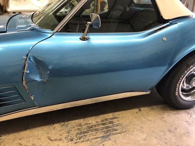

Thanks for the reply. The door was open and got pushed all the way back to the front fender while rolling out of my shop. The metal was bent in the front part and the hinges were broken also. I had to cut the hinge pins out to get the doors off. The door pillar also suffered some distortion which will need attention. The fiber glass is cracked and crushed in but possibly could be repaired. Doesn't look so bad in the picture, but there is some underlying ugliness. I thought about cutting the damaged part of the door and replacing it with a matching piece from another door shell. Just thinking another door would be easier.

That’s a tough call. I would not be afraid of replacing the portion of the damaged skin. The key, as you have identified, is now much the steel substructure was damaged and potentially reparable. If it were mine, I’d surgically section out the damaged skin, then assess the steel to see if it is worth the time/effort. Buying a replacement door come with its own baggage so if you have the ability, I’d get out the respirator and the saws.

I agree, but would start by repairing the pillar distortion. If he doesn’t get that right, new or old door, it won’t fit right.

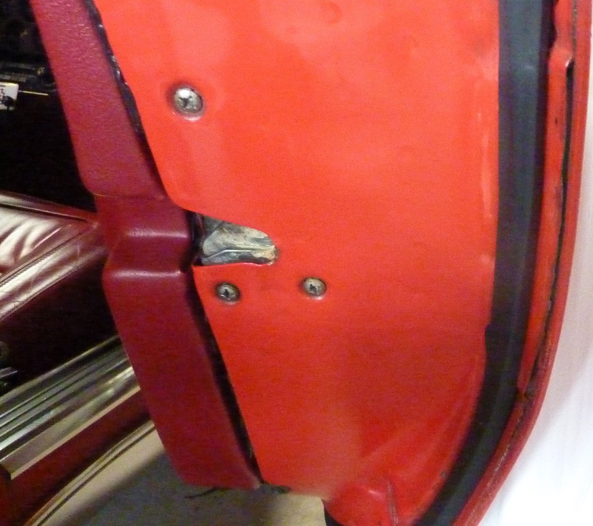

Originally Posted by 69L88
. Side impact beams came into effect in 73 and I understand that the interior panel design changed in 78.
Look closely and you can spot the side impact beam in this 73. It lies just under the skin and next to the weatherstrip. Whether that makes a difference for a pre-73...I don't know.

Yeah. I know. I'm going to have to think on that for a while. It's not horrific, but there is a noticeable crease down the middle of the pillar across the hole that is used to run the power window wire to the door. I've got some ideas, but none are easy. What a pain!
I
That's good to know. If I have to get another door, I'll definitely measure the door width to make sure it isn't slightly wider than what I have.
