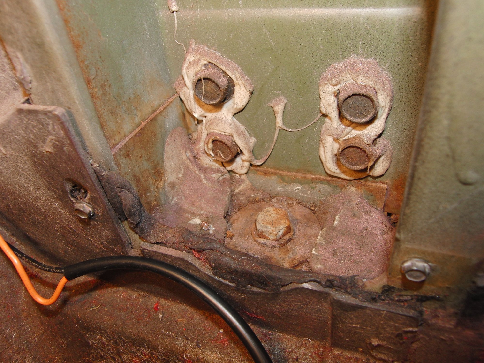

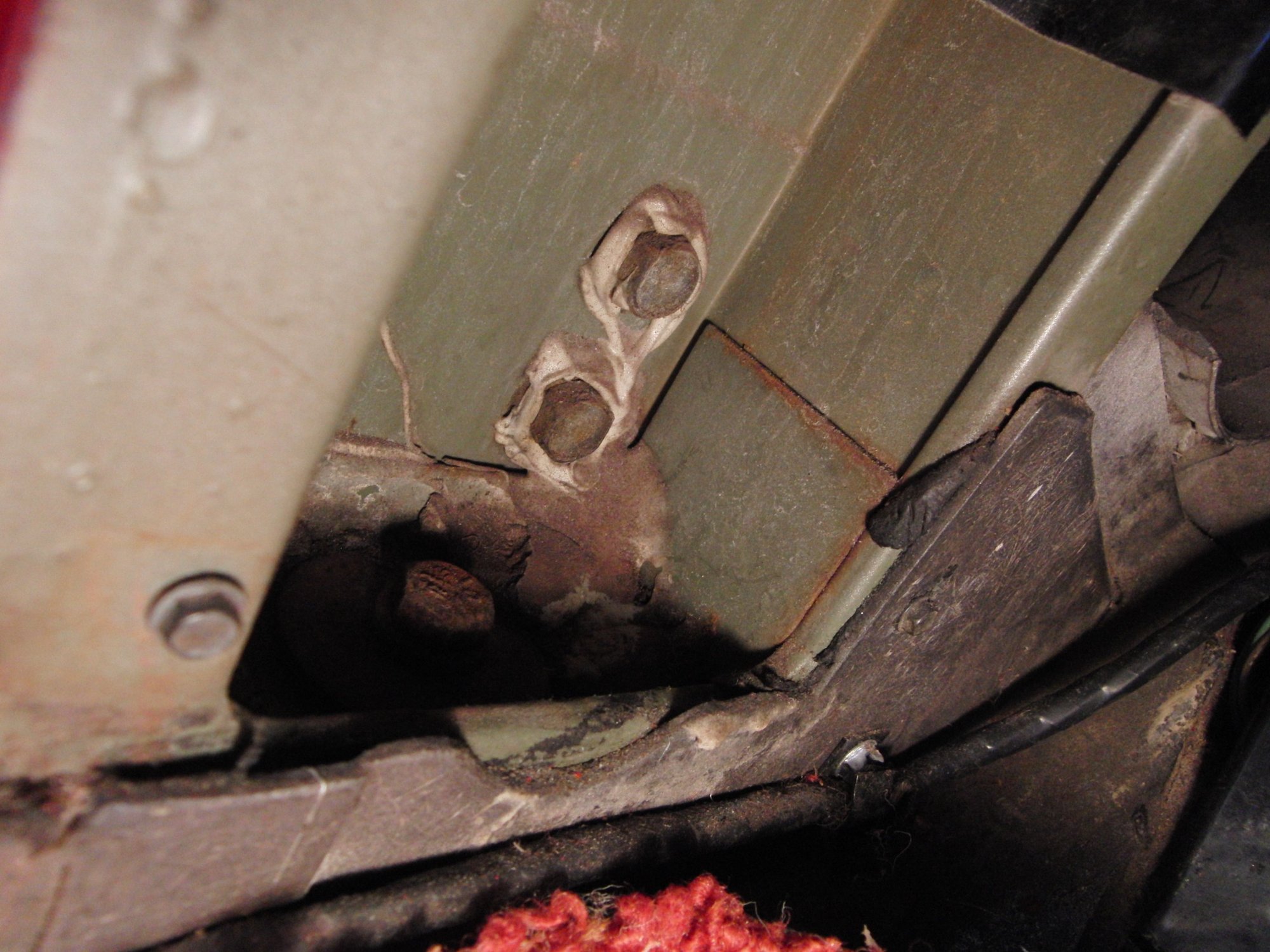

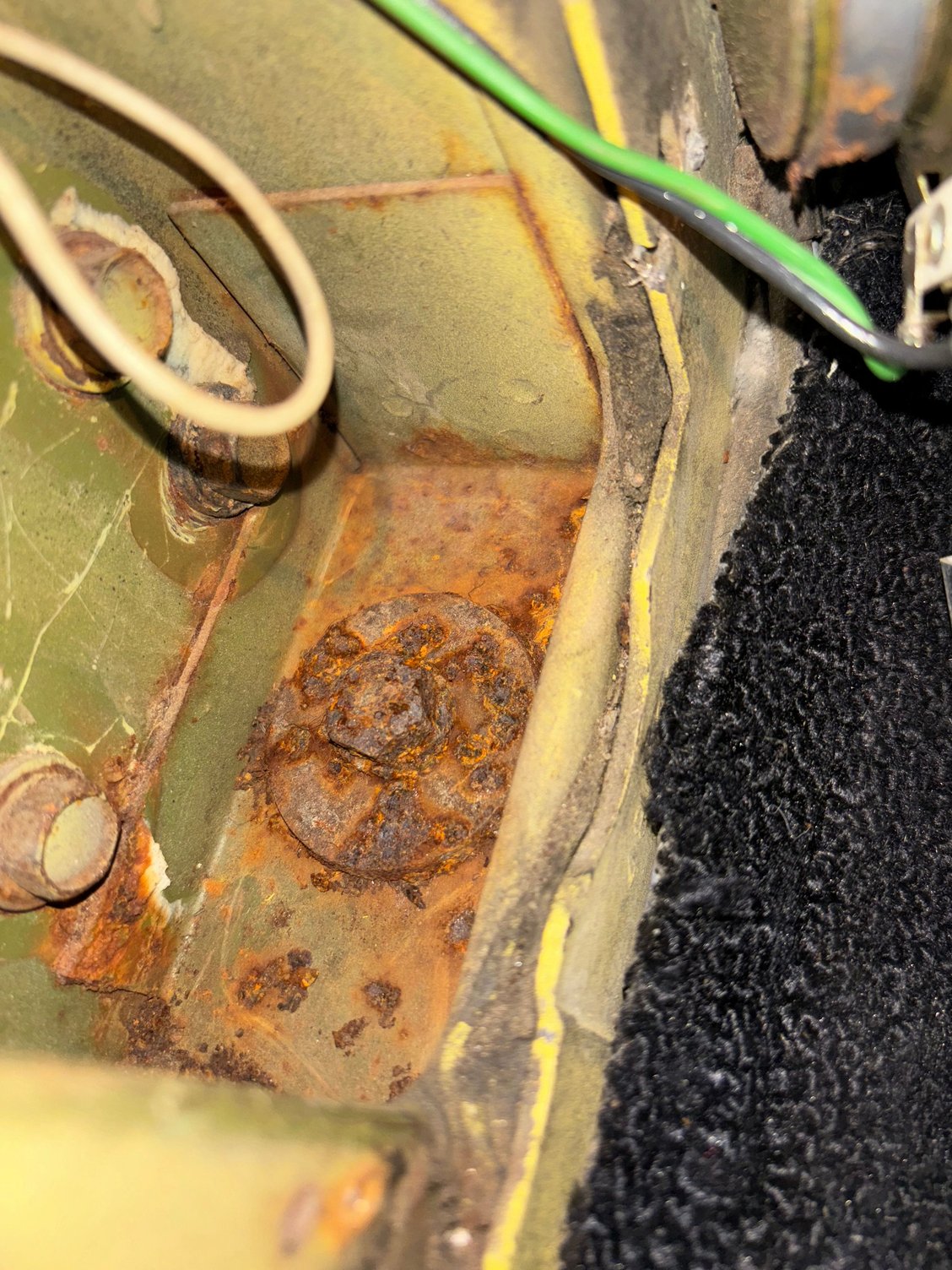

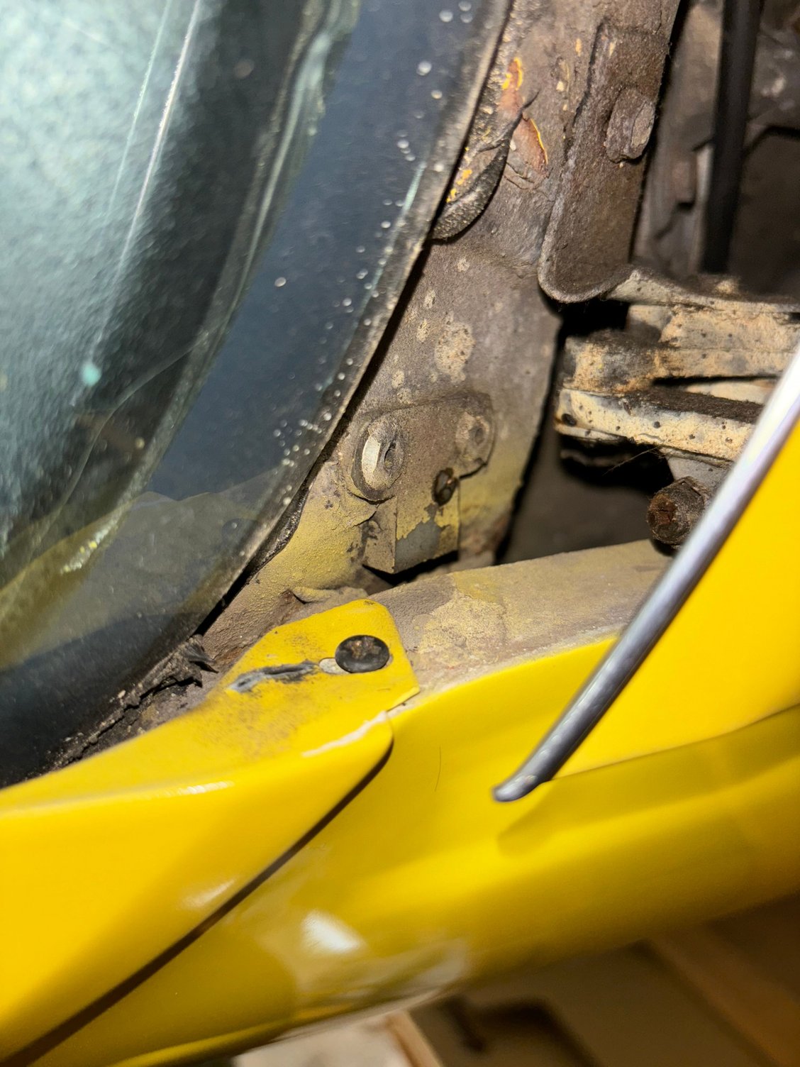

Hi All. Always wanted a C3 and am currently considering a purchase of a ‘69. I was provided the attached photos of the birdcage behind the kick plate. Passenger side has some sealant perhaps around the bolts which doesn’t appear on the drivers side. Not sure what I’m looking at here. Any thoughts/comments about the sealant and/or rust condition appreciated.

Rookie answer......
That may be factory caulking. It looks as though the areas need only a good cleaning and some rust preventative paint.

Looks incredibly good! Outstanding! Think of the age of this car, this is truly what your looking for!
BUY THIS ONE!

Absolutely nothing to worry about with that one. What do the windshield pillars and header frame look like?

I agree. While the area behind the kick panels looks pretty good, the windshield header would be the deciding factor.

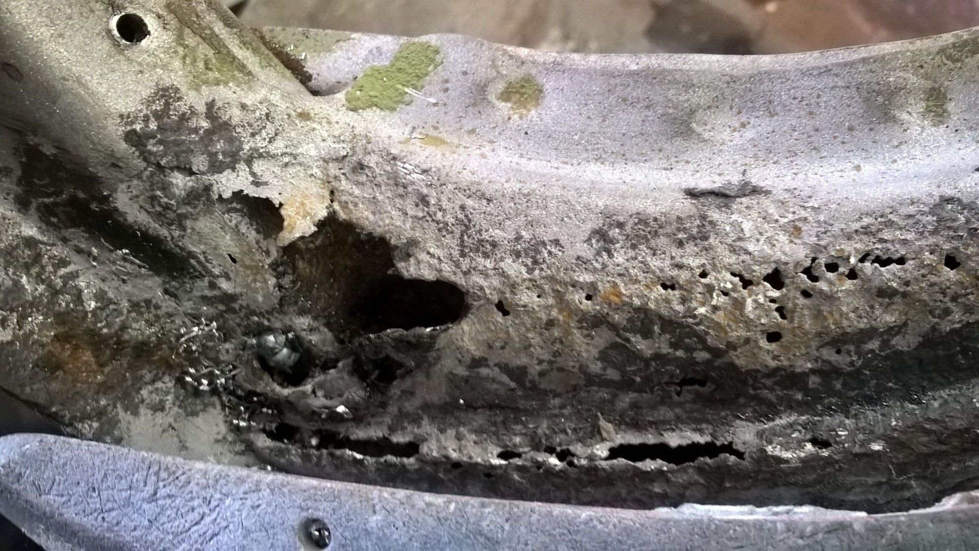

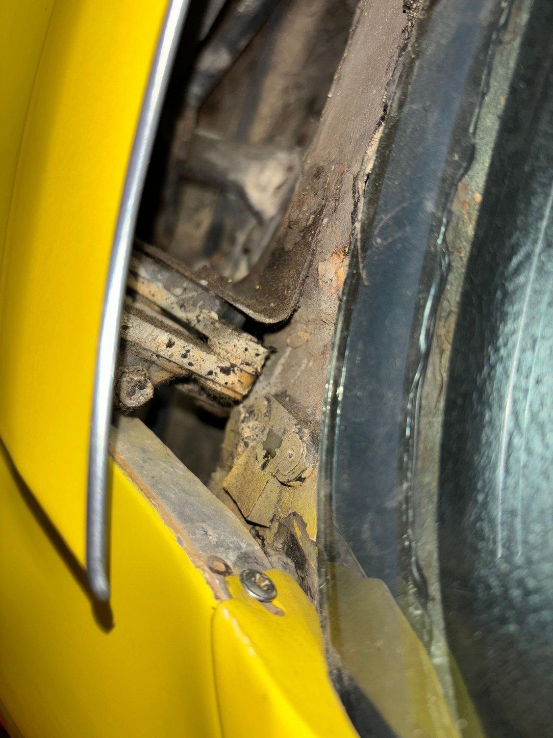

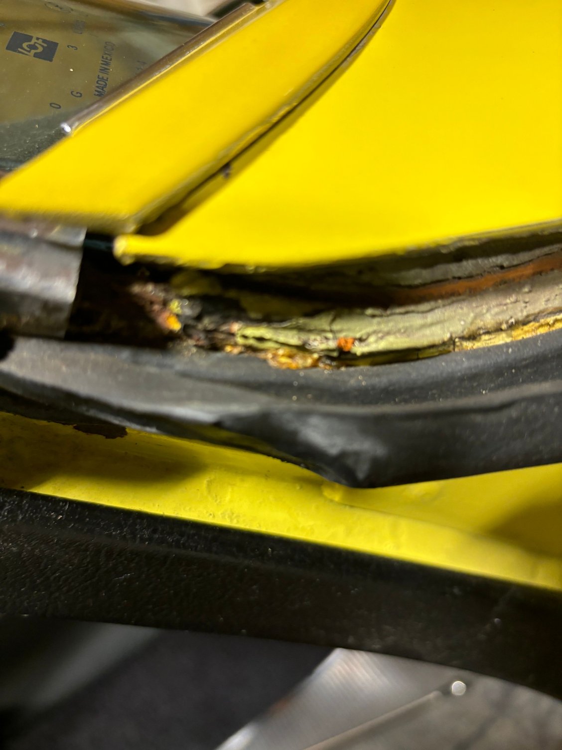

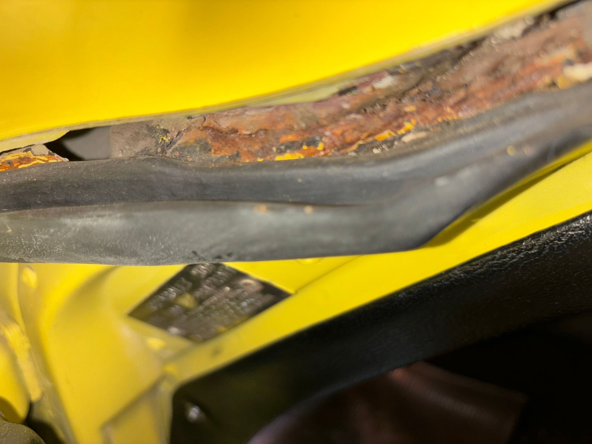

Here’s the info I got regarding the pillar/windshield area. Seller noted some rust. Thanks again for all the help.

Looks rotten to me. I'd keep looking. At least get a usb camera and look up from there....may be able to get a look at the upper birdcage..... and get some pics of the underneath too.

I’m not overly concerned with those photos. Is the seller willing to remove the interior trim on the A pillars and the header trim at the top of the windshield?

The first two pics of the last set would tell me to move on, I can fix a lot of things, and deal with others, but that kind of rust is called cancer for a reason. Unless this is a screaming deal I would keep looking...

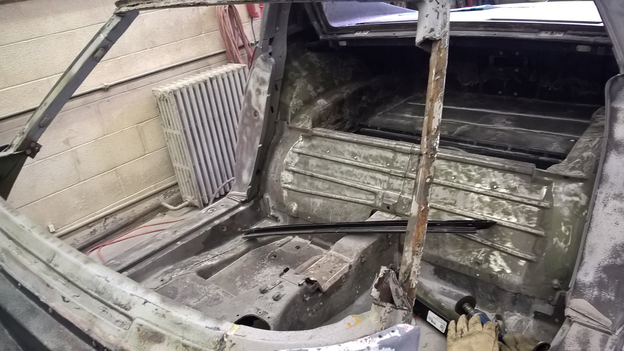

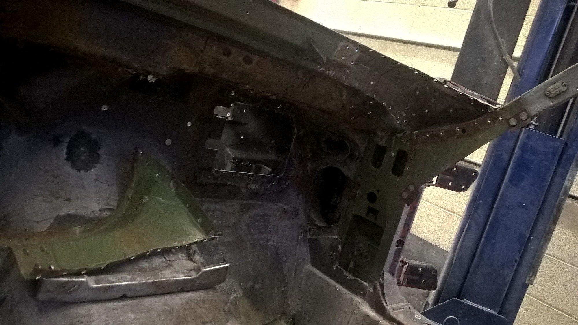

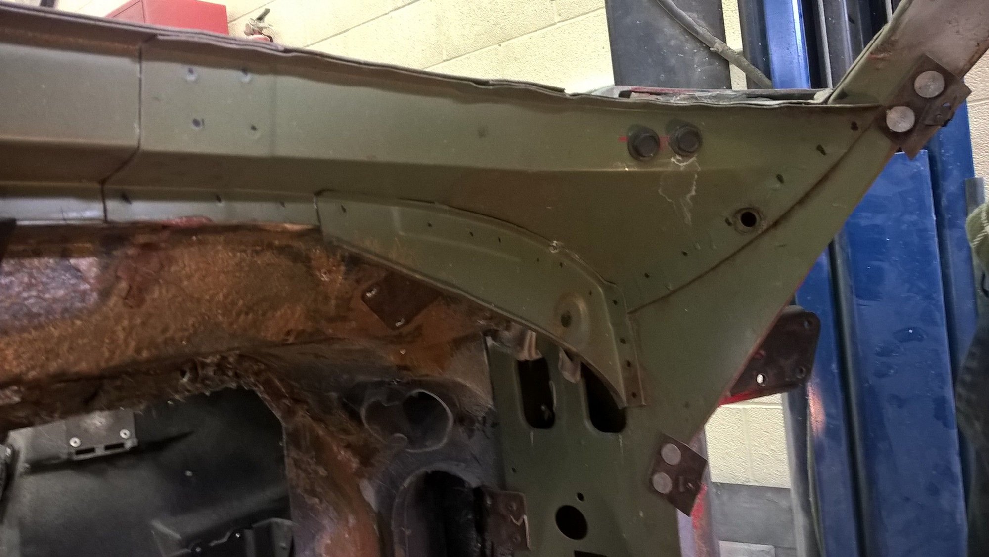

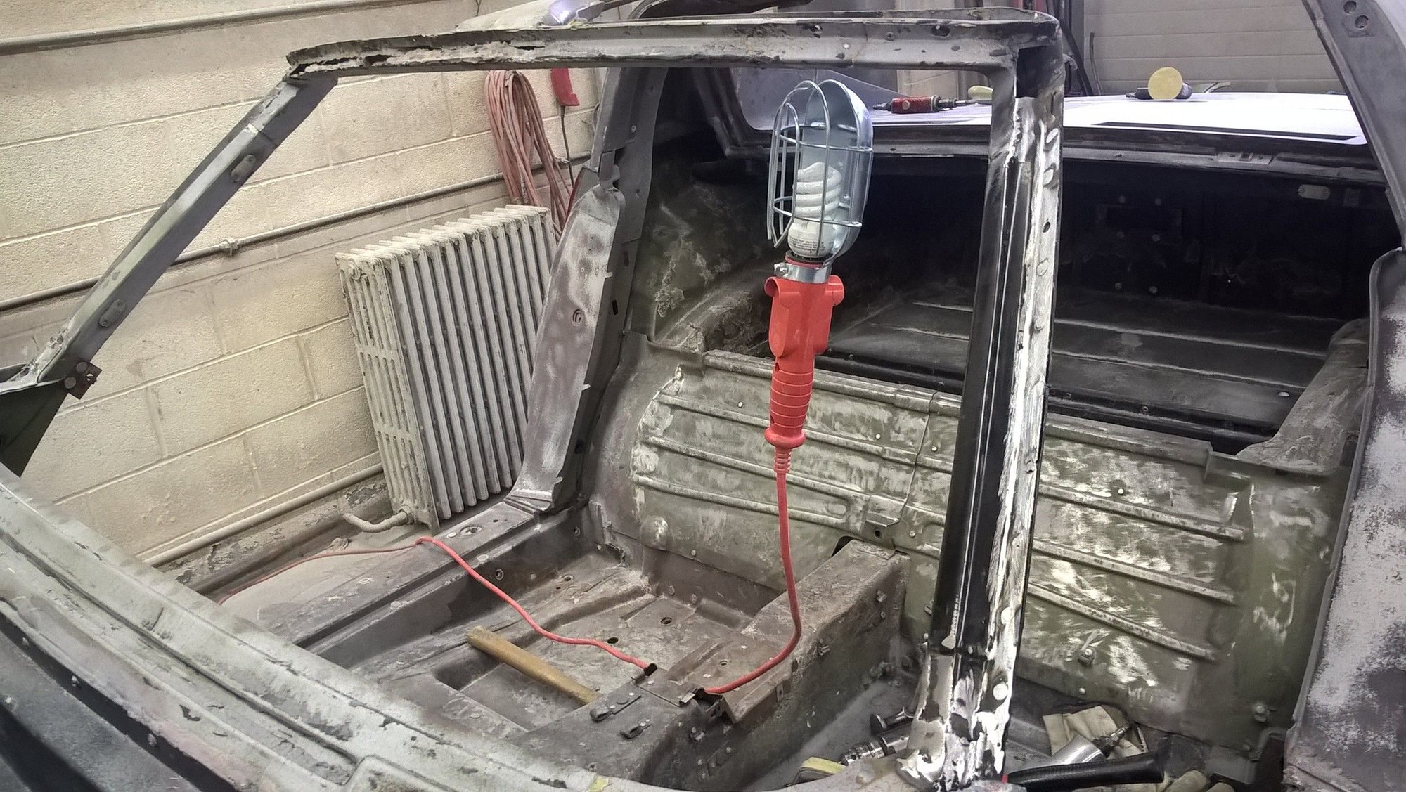

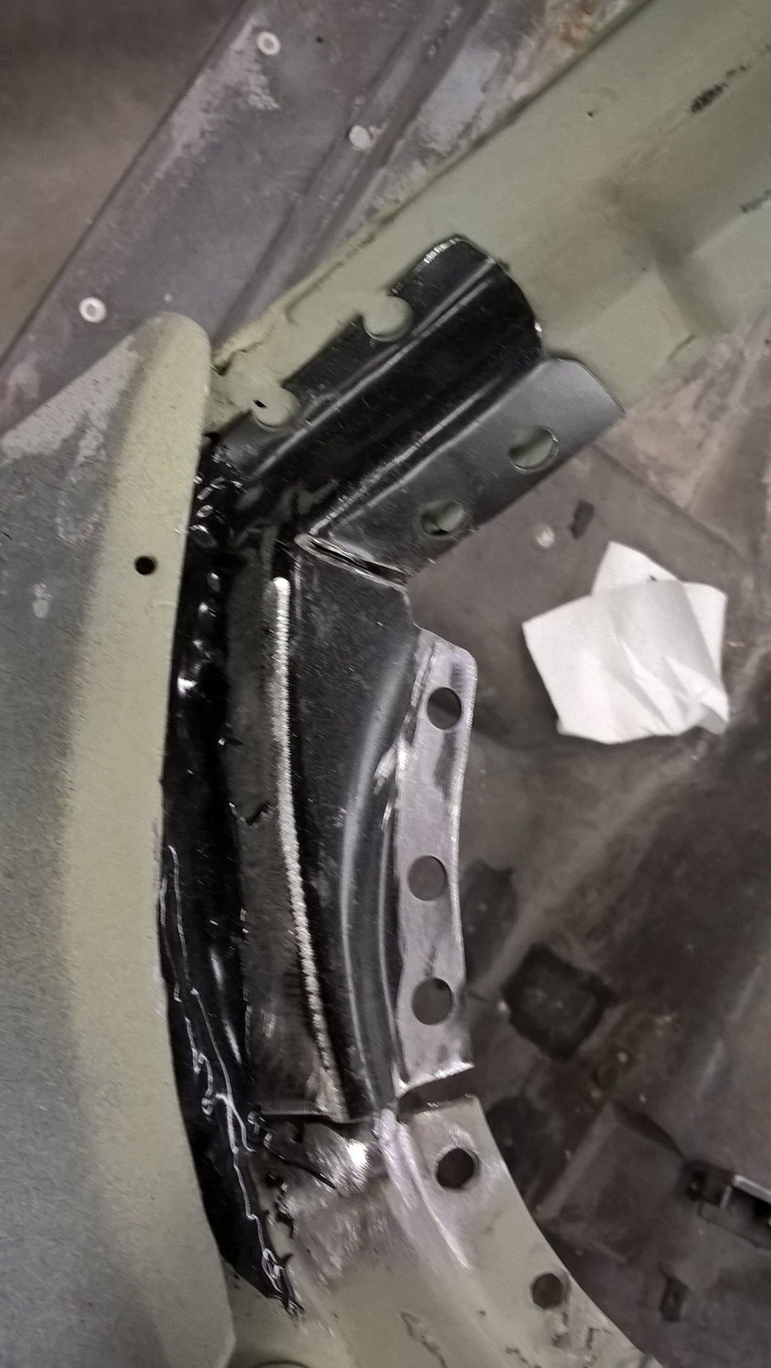

Not to be the voice of doom, but my #2 body mounts looked even better than that, but I had extensive rot in the windshield frame. It would be very invasive to inspect enough of the birdcage to be absolutely sure there was no rot, but not sure how you do that. I will tell you unequivocally, after the extensive work to repair mine, I would not buy another unless I was sure. Below are a few pics of mine.

The way the windshield chrome traps dirt & moisture in that cavity I expect the majority of C3s to have windshield frame lower corner rust.
Trying to find one with zero in the w/s frame area may be like looking for the proverbial needle in the hay stack.
How perfect do you want it to be? How much extra are you willing to pay?
Are you going to leave it outside or drive it in the rain?
The w/s lower corners can be fixed from inside the car without touching the paint or fenders. It can be done. If you need it "leak-free".
But more than likely the t-top seals will leak anyway, LOL

Leigh is right, as you can see in my pics my lower corner rot was fixed from the inside. Just be sure to plan accordingly if buying a car with this unknown.

If the car is nice to your specifications I would not let it stop you. There is NO way you can sure how much w,/s frame rust there is unless you pull the glass windshield. Everyone I know who has done that, has been surprised how much rust is in there. I would go so far as to say they all have some, unless it has never been in the rain.
You do have some rust stains in the #2 mount area, so guess where that water comes from? Above.
That part of the frame is not a structural issue unless the rot is really bad, and your is not bad at all.

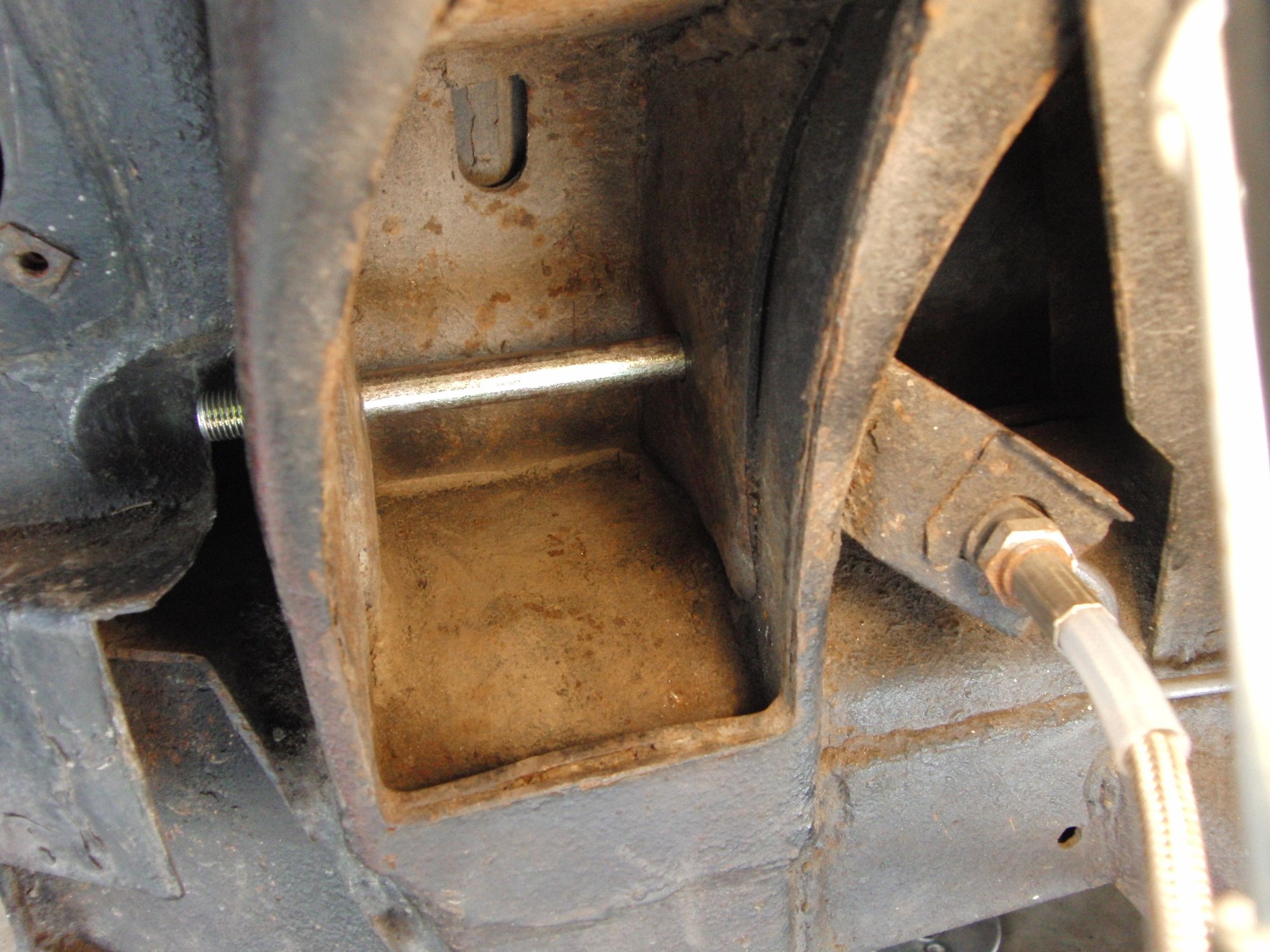

Fortunately you can inspect all the other typical rust areas, all in the lower main frame. Those are definitely structural so make sure those points are good. But fortunately they are easily inspected on a lift. #4 body mount behind tire. #3 body mount in front of tire thru trap door. #3 mount and frame area directly beneath it. Also for 2-3 feet in front of that.
If those areas are solid, and as little rust staining you have at #2, I would go for it and not worry about the w/s.
