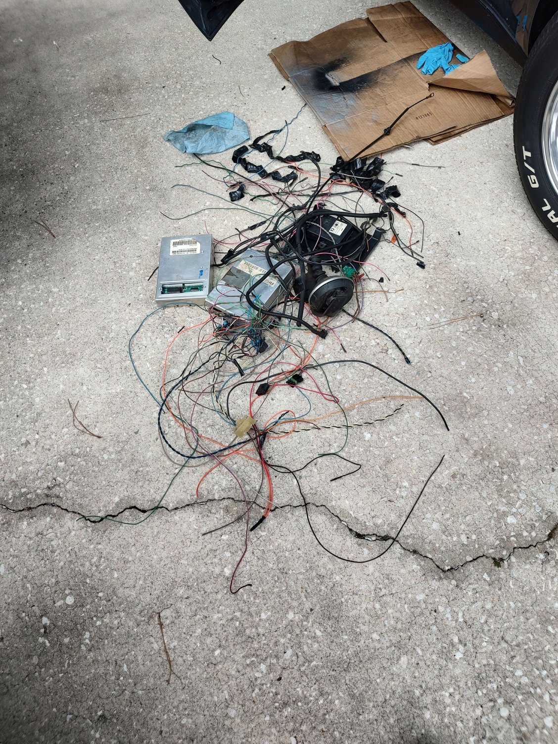

If the 81 is wired like the 82 you just can't remove the ECM wiring without affecting non engine management electrical. You see on my 82 the dash and non engine management harnesses run to the back of the car were the dash, non engine management, and engine management harnesses connect. And some of the engine management wiring is merged with the rest of the vehicle wiring, it just doesn't unplug.
​​​As you see some of the engine management wiring was removed separately from the dash and vehicle wiring. I hope that clears things up for you.
