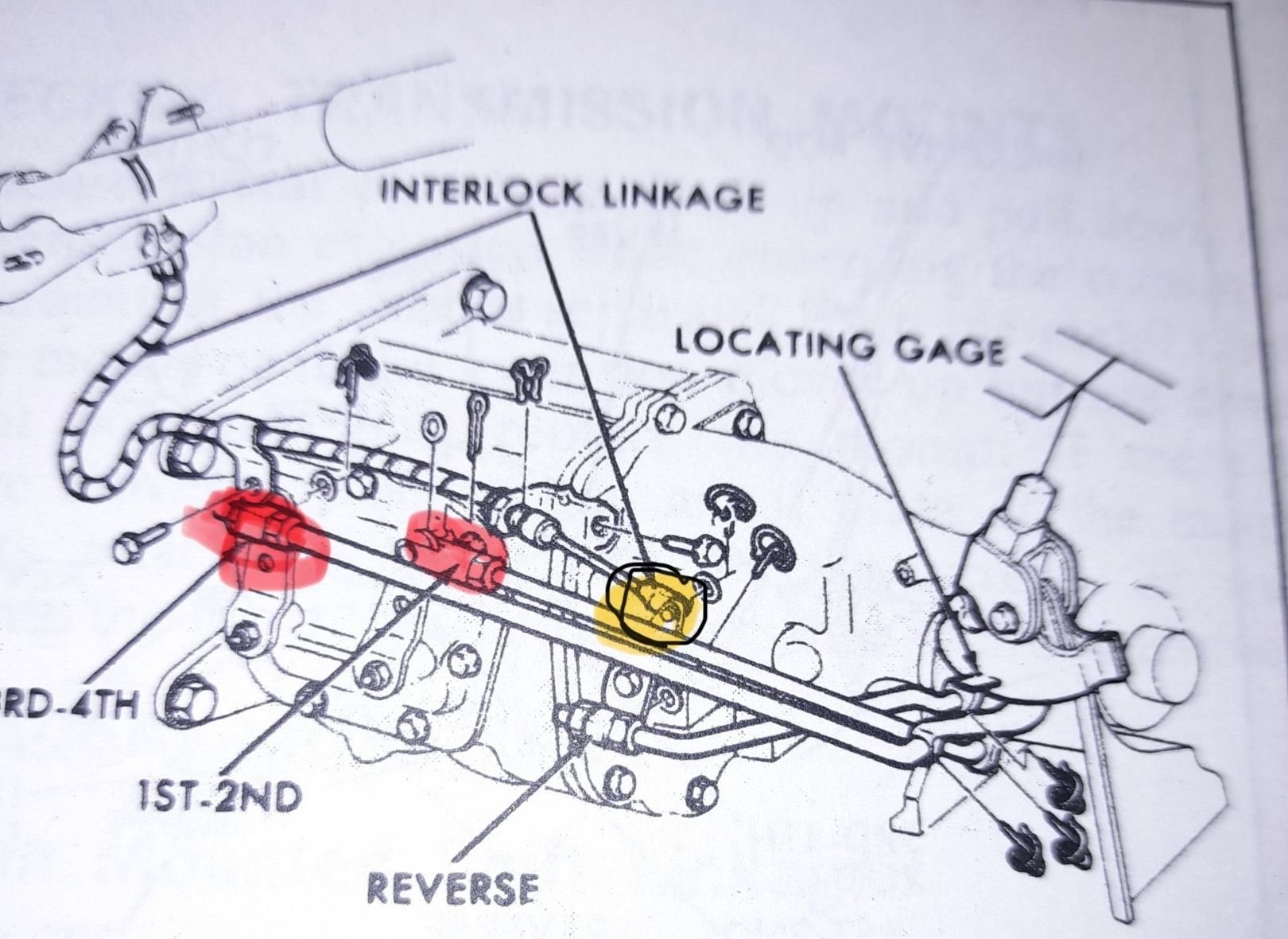

Here's some samples from my 77 factory manual. Your car should be similar.
Note: locating guage.
this isn't everything of course. But should give you an idea.

First...I ordered the Service manual.
Second...thanks for all the replies and 4-Vettes, thanks for sending the pages.

I don’t have the rod. The reverse tab appears to be from the interlock setup in yellow. The other two don’t have the adjustment at the gearbox but back by the shifter. Did bubba work on my car?

1968 doesn't use the interlock cable as the ignition lock is on the dash. 1969 - 1982 the ignition lock is steering column mounted and requires the shifter to be put into reverse in order to remove the ignition key.
If the shift rod adjustment is back by the shifter body itself, you have an aftermarket Hurst shifter.https://www.holley.com/blog/post/how...speed_shifter/
