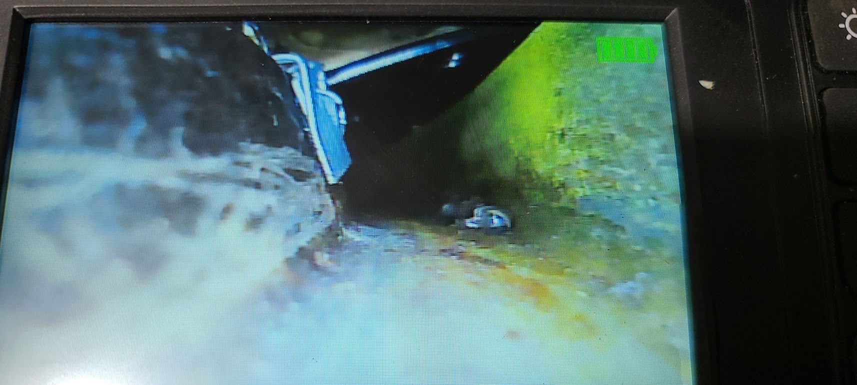

started off with a pick and everything felt and sounded solid. some rust flaked off but no holes poked through!
lifted up the chrome top trim enough to sneak in an endoscope. it's about the 3rd time i've used it and it's been more valuable than the $30 i spent on amazon for it.
besides one bug shell looking thing the rust on the inside didn't look bad at all. the black on the left side, does that look like maybe someone treated some surface rust before? I believe the windshield might not be original so maybe through the process of changing it they discovered a bit of rust and cleaned it up but didn't remove the interior trim panels?
Either way I'm super happy I was able to check it out for peace of mind and will pick up some Eastwood Internal Frame Aerosol and coat as much as the nozzle will let me get access to.

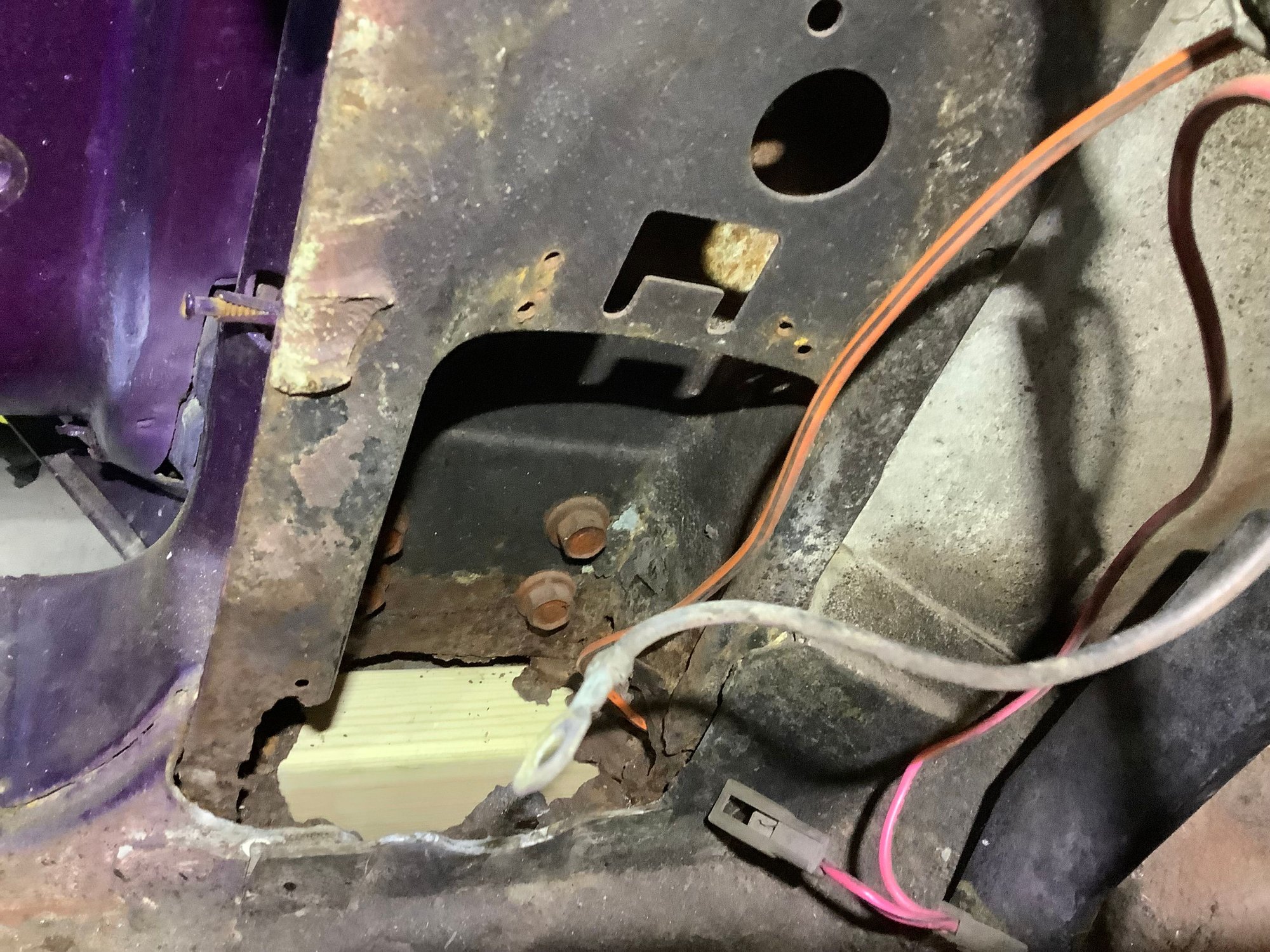

Drivers side that had worse looking rust from underneath trim panels:

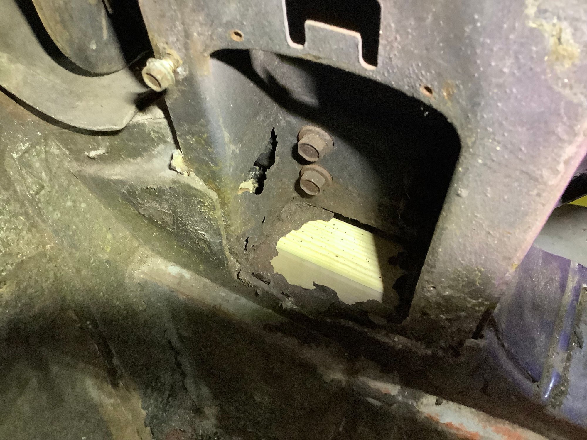

The one passenger side pic I was able to take:
