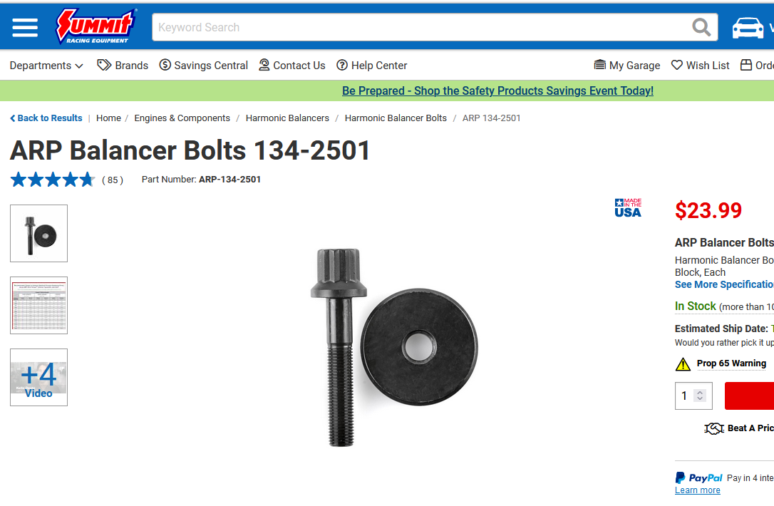

After reinstalling the balancer on my 69 SBC, I noticed the bolt I took off (and was going to use) had some rounding on the edges. So I've decided to get a new one and not take any chances. Interestingly, the factory assembly manual for a 69 shows a bolt (9428643) a lock washer (138494) and the washer (3739422) but apparently the guy who was working on the engine before me did not use the lock washer. So I am looking for a good replacement and came across this one:
945G Mr. Gasket Harmonic Balancer Bolt & Washer Set - JEGS
Its a grade 8 bolt and looks like the head is thicker to reduce socket slippage. Does this look like something I should order or should I just go with the stock pieces? Also, should I put a dab on blue locktite on the bolt or no?

No, this is what you want:
https://www.summitracing.com/parts/arp-134-2501

Here is what's going to happen jpatrick.
It may not be tomorrow, or next week or in five yrs. But eventually you will be turning over the entire engine assembly with the plugs still in and BANG.
You just snapped the bolt off in the crank.
Good luck getting that out. Your worst nightmare just happened.
That bolt is in place to hold the harmonic balancer on. That's all. That's its job.
But we all know it will turn the crank with a breaker bar. So we all abuse it.
If you purchase the above, you will NEVER have to worry about breaking it.
No lock-washer needed. Just a drop of Loctite Blue.

Thanks for the info! Do I still torque this down at 60 ft/lbs?0

ARP has their own torque (at least for the LS series). There should be instructions in the package.
I got one for my 99 when I replaced the LS1 balancer. The ARP bolt torque was a lot less than the GM factory bolt. You need to look for what ARP says. They even sent a little pack of their special lubricant with the bolt.

The balancer bolt is 7/16" X 20
Here are the ARP torque specs for their bolts:

So by that chart, the 7/16 diameter bolt with 200,000 lbs torque rating, it appears I need to torque to 80 ft/lbs.
Should read 200,000 psi tensile strength not lbs..
80 ft/lbs is how I read the chart with using their "fastener assembly lubricant" when installing.

Remember that the Harmonic Balancer is a "press-fit" and requires a special tool to install the unit.
I wouldn't be too concerned about the bolt torque, 70 or 80 will work. The bolt just holds the balancer on.

Agree with above post. Early 283 & 327 small block chevys did not even use a balancer bolt. The dampers were simply pressed on. Only the high perf. engine crankshafts were drilled and tapped for a bolt. Your 70-80 torque is more than enough insurance.

Thanks all - had the balancer rebuilt by the Damper Doc and used a special tool to put it back on. Even with the tool, i only went on so far and I had to use the old bolt and washer to get it all the way on. I agree, that balancer is not going to fall off on its own. I was thinking I would put the bolt on using the suggested 75-80 ft/lbs of torque but I know that will not be so easy. Getting the old bolt snug up at 60 ft/lbs was hard enough.At least I know the bolt should not snap during the attempt!
