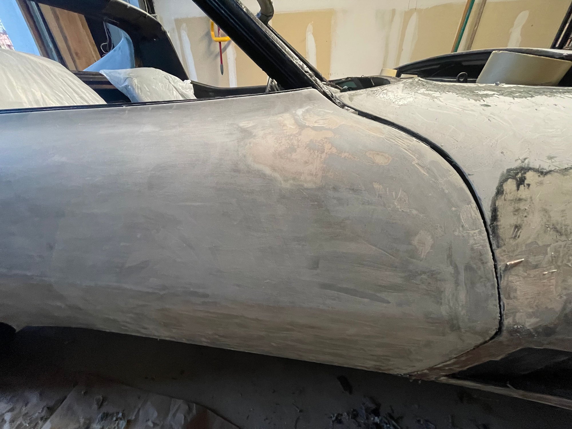

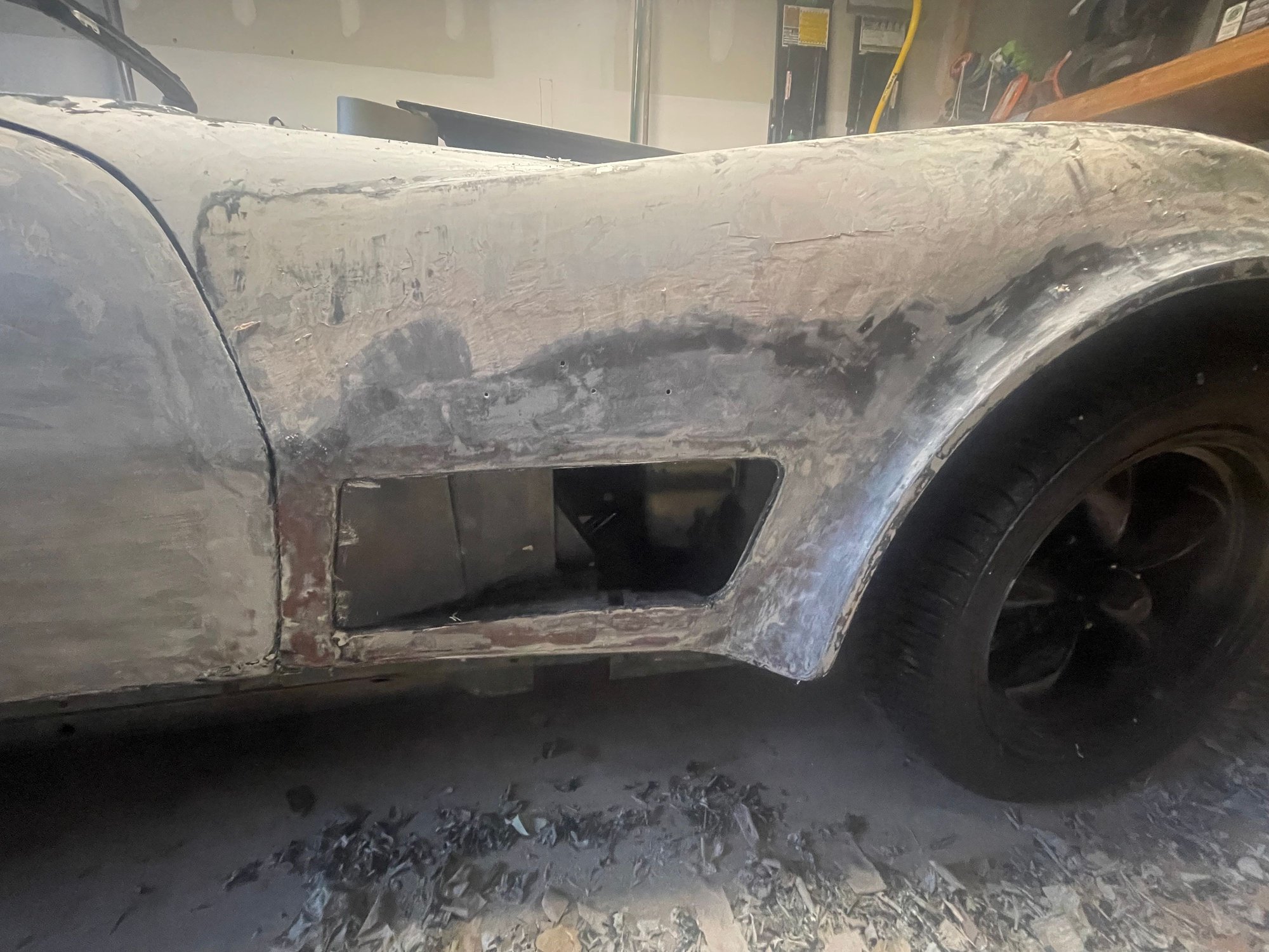

Hey,
im stripping the paint with a combo of using a blade and also paint stripper where it’s difficult to just use a blade. As I’m working on the fender I was wondering — what is the pinkish material? Am I supposed to strip it? I feel like I’m just not sure how deep I should go. I had none of it when I stripped the t tops. Also the top part of the door had it. Not sure if I should just fill this or strip it since it seems pretty thick. Thank you and see pictures especially top of fender and top of door on the right.

Looks like it might be bondo from a prior repair
since you’ve been using a stripper, you’ll want to remove all of the filler to avoid problems with the new paint. Plus, removing the filler will reveal what kind of repairs were done before.

thanks. I’m concerned that if I completely remove it, i will not know how to create the same contours again. How does one recreate it so it looks similar to the other side and overall good?

If you've never used bondo (filler) you'll probably have to take it to a body repairman to get it back correctly.
If you have the desire (and the time) to do it yourself, you can do as good a job as anyone in restoring the contours and getting it ready for paint. You can do it with a few hand tools and sanding blocks. Applying the filler is easy and if you make a mistake, you just sand it off and re-apply. Let us know if you want to tackle this and we can give you more specific guidance. Watch some videos to gain some basic understanding and develop your plan.

Thank you. Yes I will probably tackle it myself like anything else I did in the car so far I did some bondo in the past to fix a bumper in my Honda and it came out really nice, plus I have tons of woodworking experience so sanding is not an issue. I did look from the engine bay side and I see a seam, so my guess is that the fender was replaced and the bondo covers the seam.
So you think I must remove the bondo and not just try to fix the existing mess… which filler should I use, do I just try to follow the body line and then block sand it? Do I need a putty glaze and if so, which one?

The seam you see from the engine bay is most likely a factory seam. There is a bonding strip that runs the full length of the fender from the door to the bumper that is the factory fender/surround joint.
You are at a point where a couple more hours of sanding will allow you to do a thorough assessment of what you are dealing with and ensure you have a the best chance of a long term successful paint job. The presence of that much filler is a red flag that may be covering up damage that was not correctly repaired.
There are many choices for high quality body fillers. 3M Marion Platinum is an excellent choice.
I have never been a fan of putty. Sand out the body filler, then apply Morton Eliminator polyester based primer surfacer. Work with the Morton until you are ready for paint.
