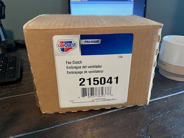

Just FYI, two weeks ago I installed new water pump on my 1978 L82/Manual/AC, my original Fan Clutch was also failing. Spoke to Kirkconnell Corvettes and they quoted me around $300 to rebuild my unit and take 2 plus weeks. Kept my original and found a Heavy-Duty Fan Clutch a friend of mine installed on his 1977 last year from Carquest. Picture of package attached, F/C cost me $73, they found me their last one on the Westcoast. Installed the unit and so far, working very well. I was impressed with the quality of the Fan Clutch went it arrived, nice weight, and matched up with my original pretty close. I still plan on rebuilding my original in the future. I also heard Corvette Central has a nice quality aftermarket Fan Clutch if you ordered one from them.
