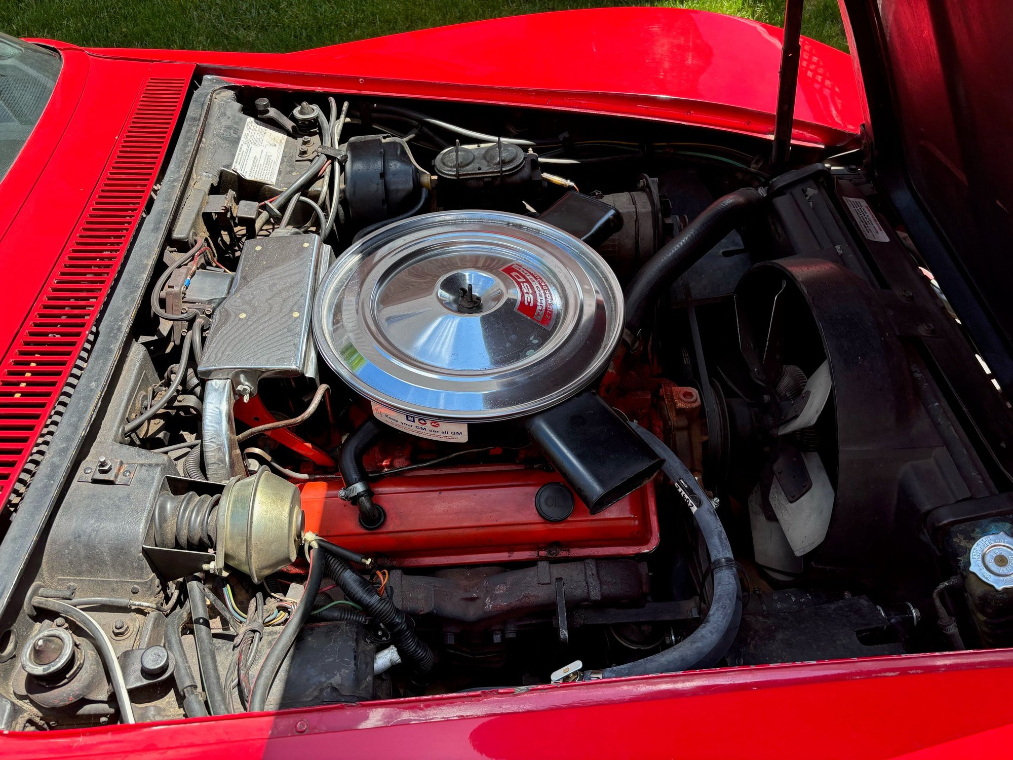

I just picked up this 1971 Coupe from ndmick last weekend. Trailered it home 700+ miles from SC to NJ. The car is in great shape but needs just a little TLC to make it perfect. The car has a front and rear coil over setup from Van Steel, as well as a Borgeuson steering box. I have to determine the paint color (some type of resale red) so I can try to find some touch up paint. Then I have to tinker with the carb as it is loading up. I think it was rebuilt by a member on here named Lars. My goal is to have a nice driver that I don't have to panic about taking out onto the roads of NJ. I want it to look as original as possible, while making some concessions to drivability and enjoyability. Here's the first pic when I got it home. This is going to be a long process of fixing little things as I go while still enjoying the car. I look forward to sharing this journey with everybody.

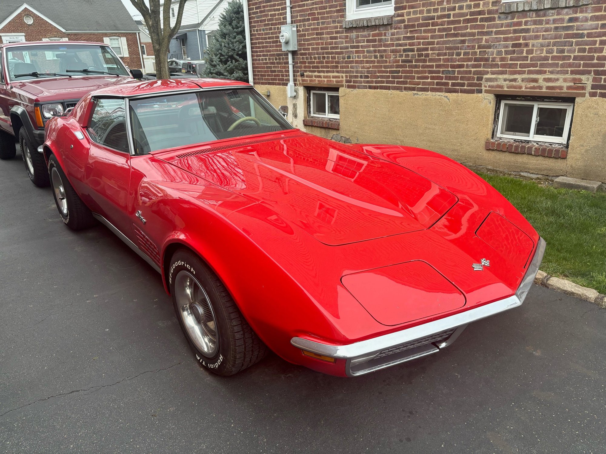

I was able to take it out for a little bit on Sunday and got a few pictures. I put the factory steering wheel back on. It was all gummed up but some rubbing alcohol took care of it. I fiddled with some of the fiber optics as well. When the car was repainted, they painted over the sensors in the light housings.
There are a few spots on the nose that I have to take care of once I get some touch up paint. That is going to be something I do sooner rather than later.

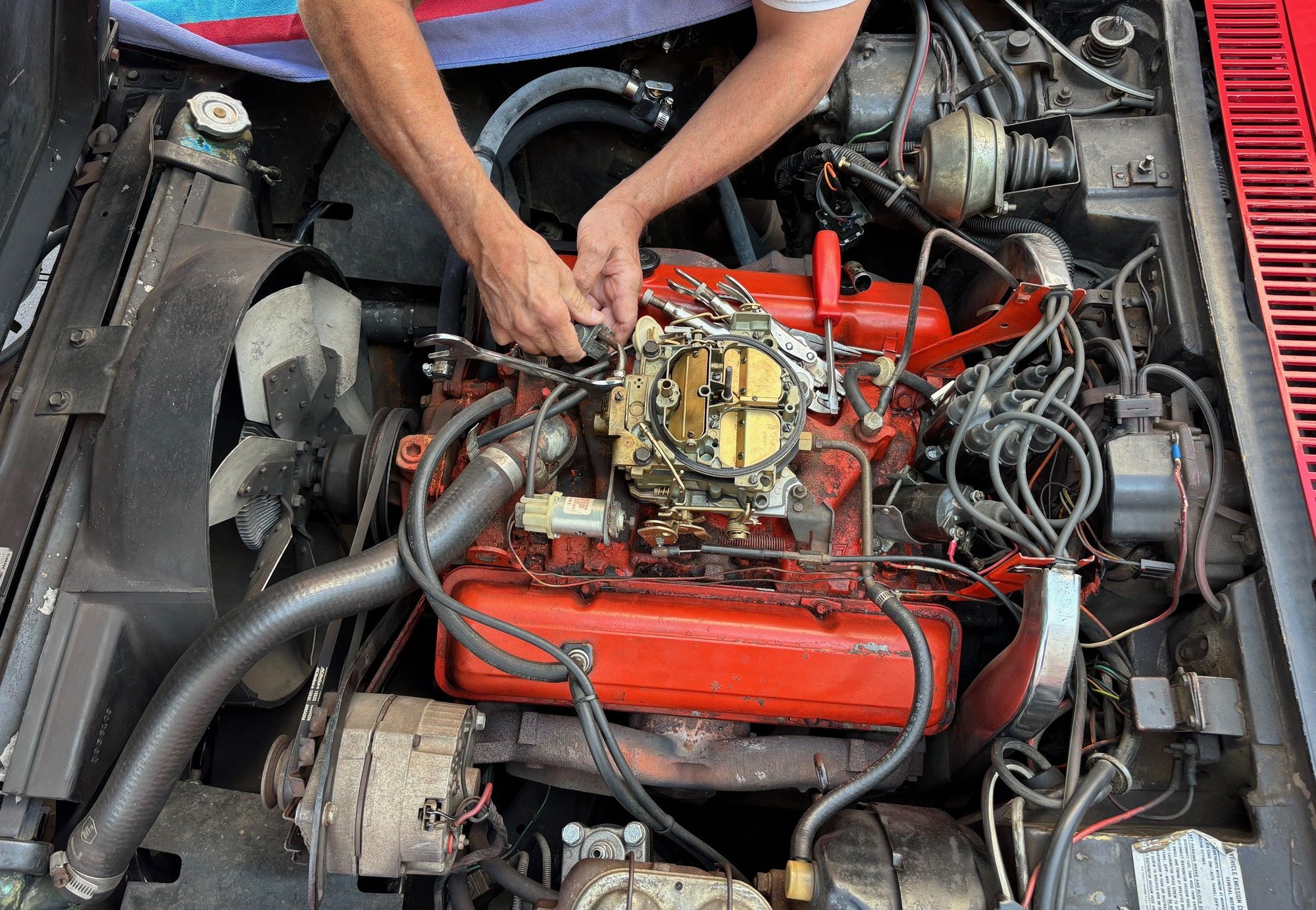

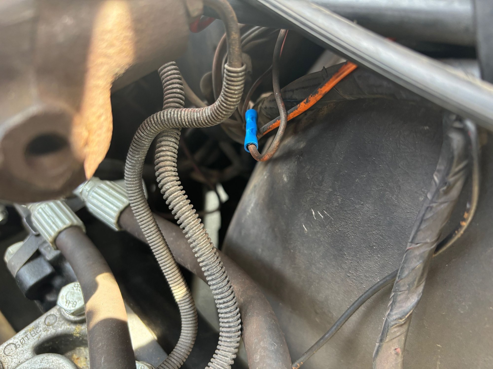

Apologies for the delay but I have been dealing with a few things all at once, and still trying to drive the car as much as I can. I seem to get more smiles per gallon than I do miles per gallon. I ran into a little issue about two months back when I noticed that the alternator was not charging. After doing some digging we noticed that one of the fusible links had burned up and after a quick patch we were able to diagnose that as the problem. I still have to replace the horn relay and figure out why my ammeter is not reading.
After doing that I had been driving the car locally to get the feel of it and see what else it may need. About three Sunday's ago I was out for a ride and after about 25 minutes of driving locally, while sitting at a stop light, the car died on me. It would not restart and I had to push it across the intersection and let it rest. I figured it may have vapor locked as it was well into the 90's and humid. After sitting for about 20 minutes it started and I made it part of the way home before it died again at a light. Fortunately I was able to restart it and make it home. When I came out a little while later, it started and idled just fine.
I have decided to take a dive into the fuel system and have noticed that the hard line coming up from the pump was kinked right near the carb and the nut was rounded off a bit. I've ordered parts and will be doing some more work this weekend.
Temporary fix on the fuse link.
Cooling off in the heat.
Getting started on the repairs. My dad is in his element working on this with me.
