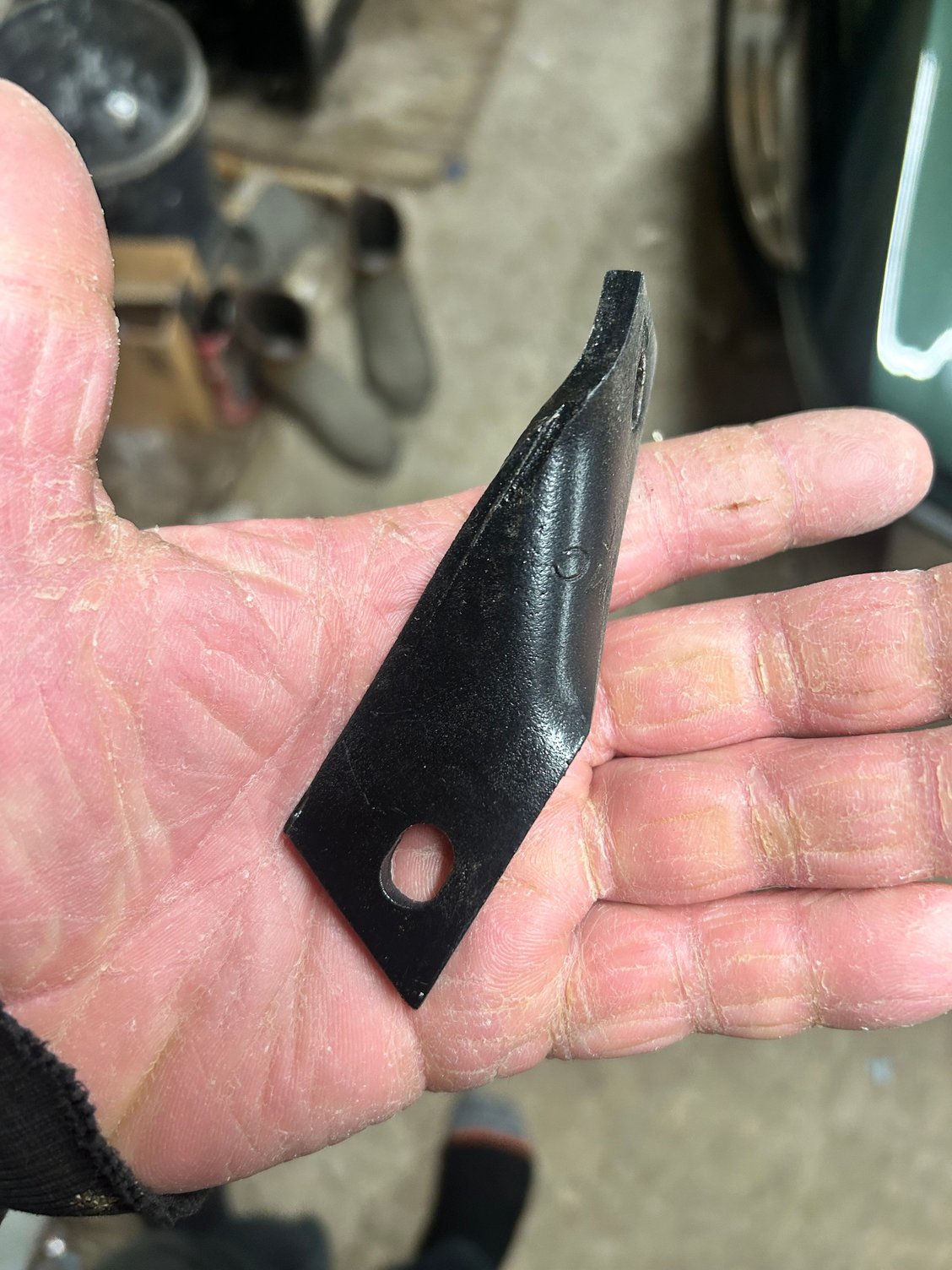

I’m putting my 69 back together. I was looking at the diagram apparently these cars take two twist brackets. My car only had one.
I can’t remember what side the one I had came off of. Is there a way I can identify which one I have so I can just get the correct one the first time with out having to buy them both.
this is the one I have

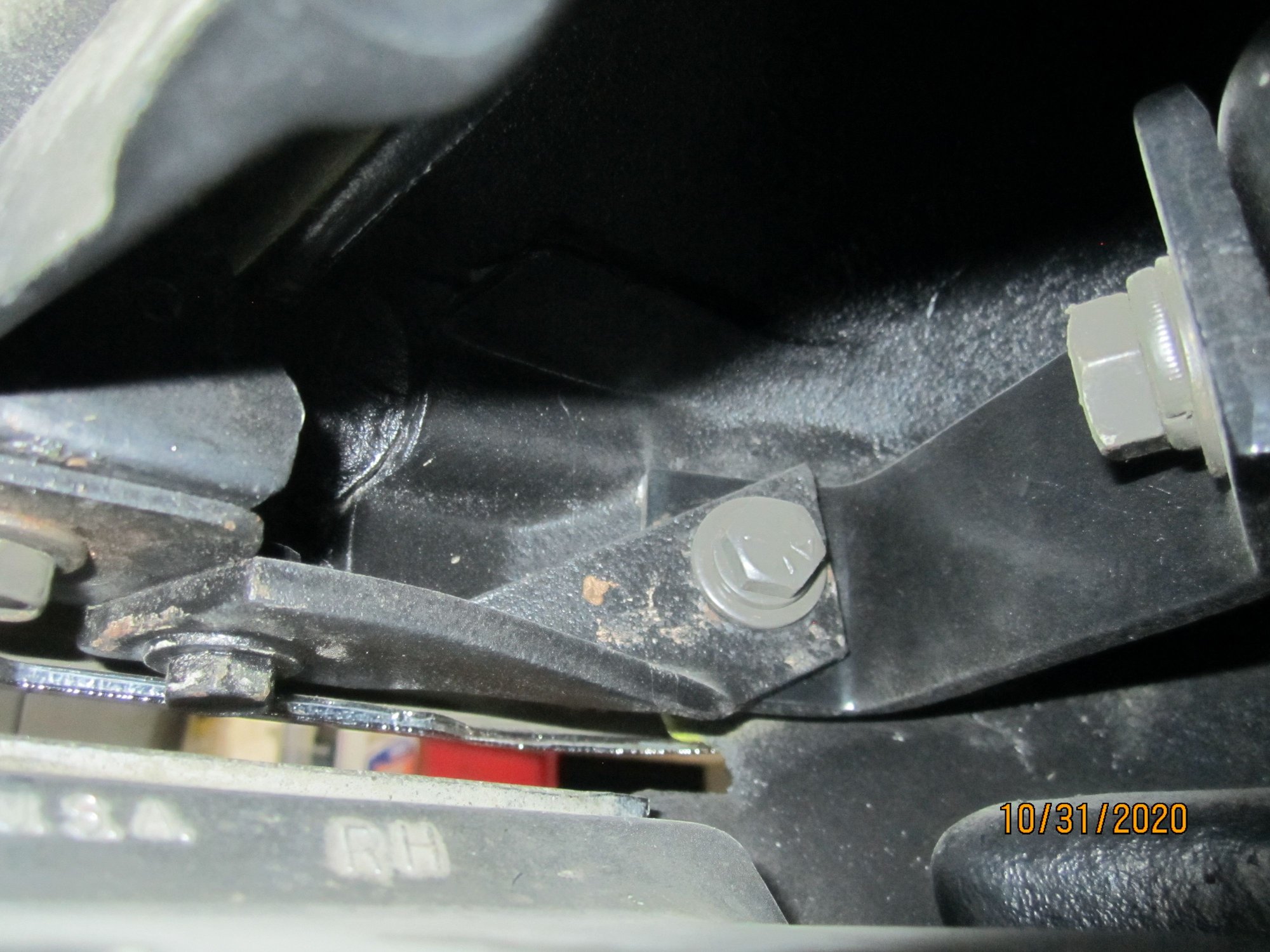

That should be the passenger side, the vertical end is cut on a more pronounced angle and the horizontal bolt hole is more towards the front of the car, you can see both features in my image there

See the RH in the photo, that is definately the passenger side . Lou.
