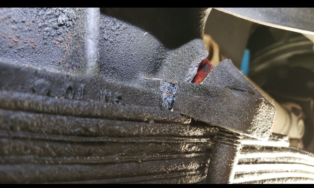

About everything that can go wrong, according to others' accounts I've read, has gone wrong. Among the worse so far, I found that one of the tabs on the back of the rear end housing was already completely sheared off before I even began taking the bolt out. I'm hoping I have have it welded back on.
Old May 4, 2024 | 11:32 PM
4-vettes's Avatar
4-vettes
Posts: 13,143
Likes: 7,753
Cruise-In VIII Veteran
No. That's cast. Get a replacement heavy duty cover. Replaced mine years ago with a Muskegon one.
Old May 5, 2024 | 11:47 AM
GTR1999's Avatar
GTR1999
Joined: Aug 1999
Posts: 15,130
Likes: 3,938
From: Connecticut, USA
Yes that cover is junk now. Prices are going up on everything, covers included so I wouldn't wait. That breaks many times from improper installation and loading. Make sure you understand how to install one. It can also happen from impact like a pothole but usually it is installation loading. There were 2 covers too in case you look for a used one. 63-77 and 78-79 both will bolt up to the housing, but the spring pads and bolts are different for the spring change in 78.

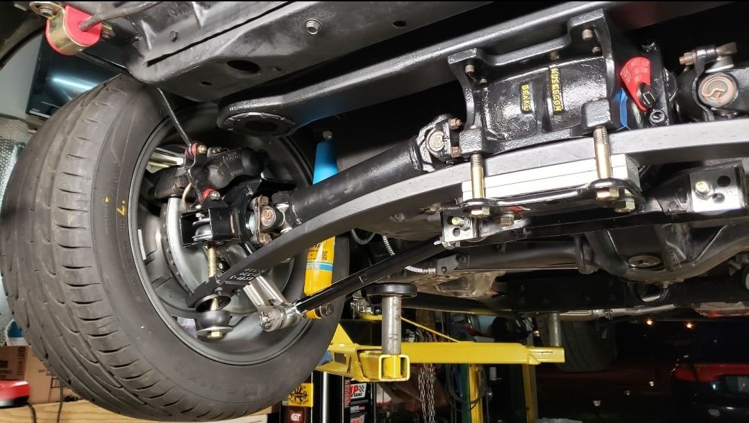

I too had this brake on me,,, the night before we were leaveing for Power Tour. ( we went any way, but took a different car ).
,,,,,,,,,,,,,,before,,,,,,,,,,,,,
😁 After doing everything 👍 ( over one winter season )
There are a few tips we can share as you go along. Just ask here before you dive in.
( some of us enjoy working on our old junk )
Old May 8, 2024 | 05:07 PM
vetteman061's Avatar
vetteman061
Joined: Dec 2011
Posts: 220
Likes: 37
That looks really nice. I suppose I'll take it one step at a time. I've got the spring pack out and I've been soaking the sombreros with penetrating oil for several days. The next step is getting the diff out and I guess I'll measure the end play to get a definite number on the side yokes. Since no one seems to have much confidence in the aftermarket yokes, I may just keep what I have as I don't want to wait until next year to drive the car, and I also don't drive it very often.
