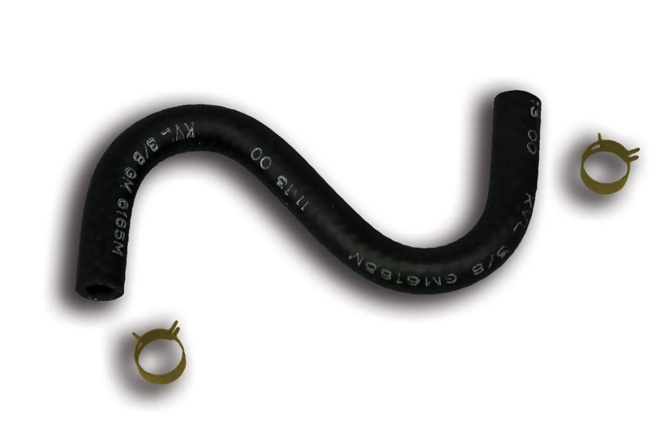

Originally Posted by interpon
make sure you use the 'S' hose so you do not have any kinks
My "S Hose" was just generic 30R7 3/8th Hose. It looks like it has a date code from Sept. 20 1996 so it has permanently shaped itself into an S. Glad I changed it.
Getting the hose clamps off of the steel line on top of the frame rale is challenging. I also changed the 1/4 vent hose. I'm glad I read about the small restrictor inside the hose that vents the bladder - I would have totally missed that. I cut it out of the old hose and put into the new hose.
My "S" Hose
My "S" Hose
I don't remember the "S" being that long. My hard line to my pump runs all the way up the frame rail right near the fuel pump and my "S" hose is only a few inches long. Was your hard line been cut or something?

This is where my hard line ends and
My hard line ends in the correct spot on the frame rail. Both hoses are 24 inches long. The vent line is about the same. A couple more inches in length for the vent line would make the installation easier.

Everyone else is talking about the S hoses at the front of the hard line to the pump. You are on the wrong end of the car.
That's what I was going to say after seeing his pictures. The supply hardline to the pump inlet on the right front of the frame rail is the "S" hose.

My bad. I did not read the first post carefully and I just happened to be replacing the rear hoses this week, and because I run an MSD Atomic EFI, I don’t have a front S hose so it is not something I think about.
While the hoses at the gas tank are probably less of a fire risk, that risk is not zero, and I expect there more than a few C3 owners that have not dropped the tank and changed out these rear hoses.
