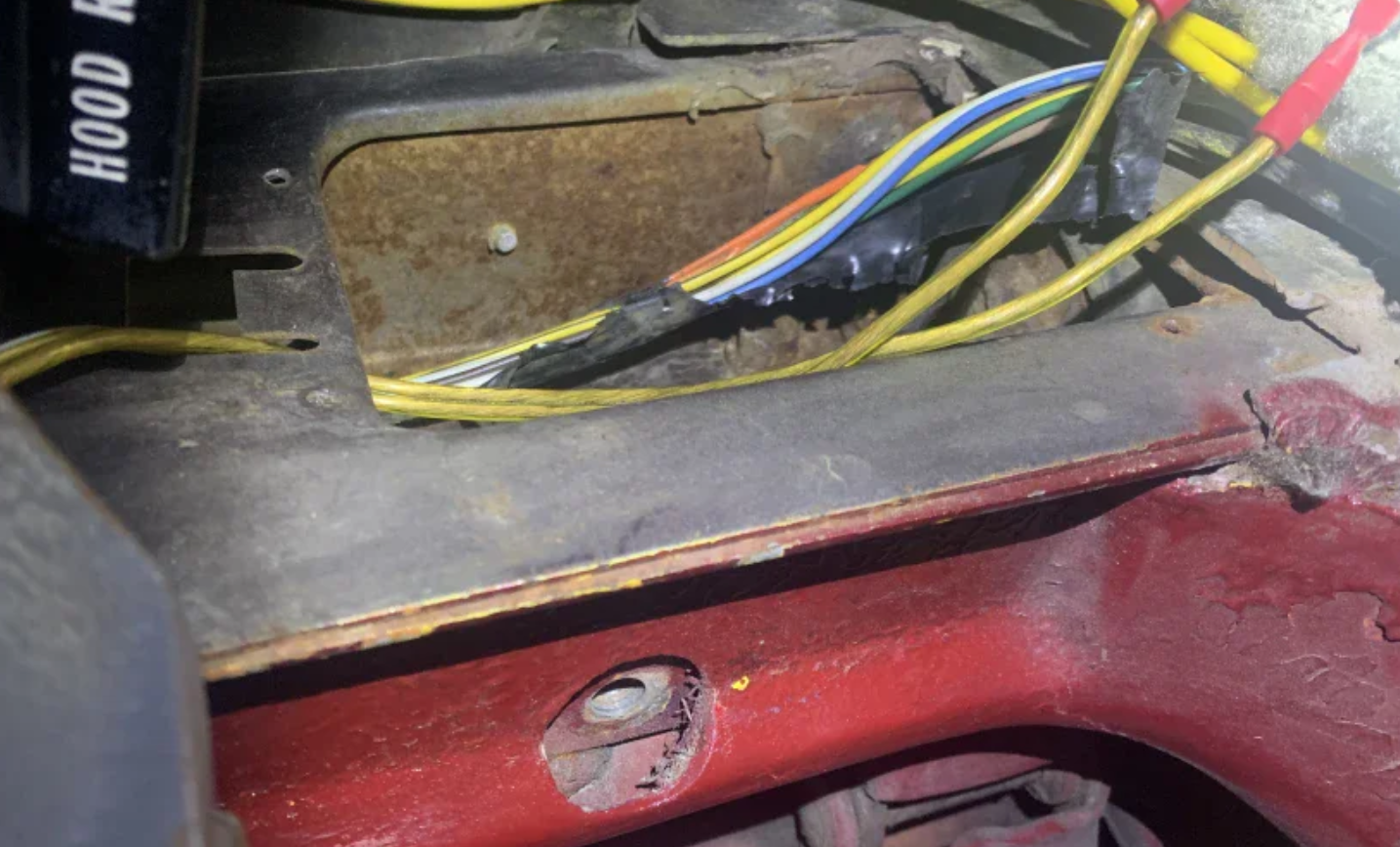

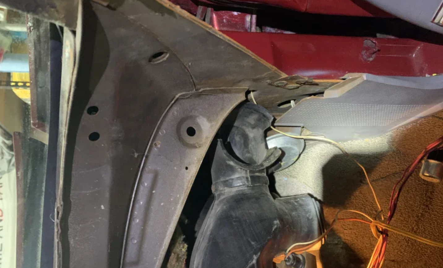

Agree that more pics are needed but from what I see posted, nothing to be afraid of. The #2 looks typical for a 50 year old mount in decent shape.

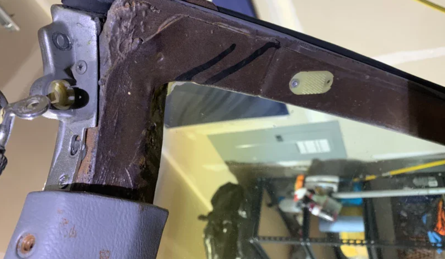

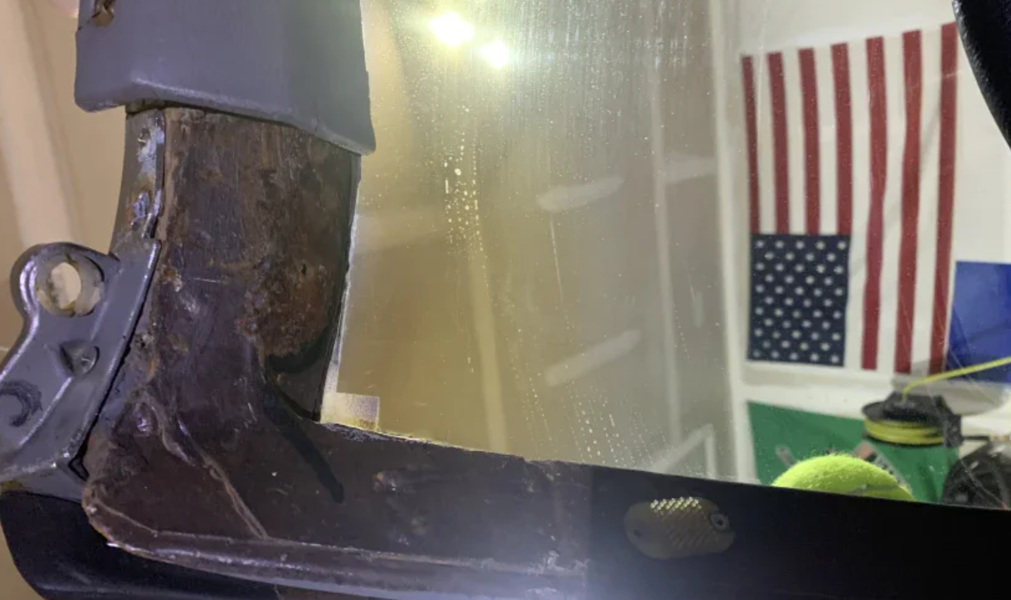

The last 2 pics are a little concerning to me. Looks like someone slathered JB Weld on the corners to fill or cover up rust. The black runs are probably a POR-15 sort of rust treatment.

Those wires need to be moved aside for a better view of the body bolt threads/nut/washer/surrounding area in the recess.
