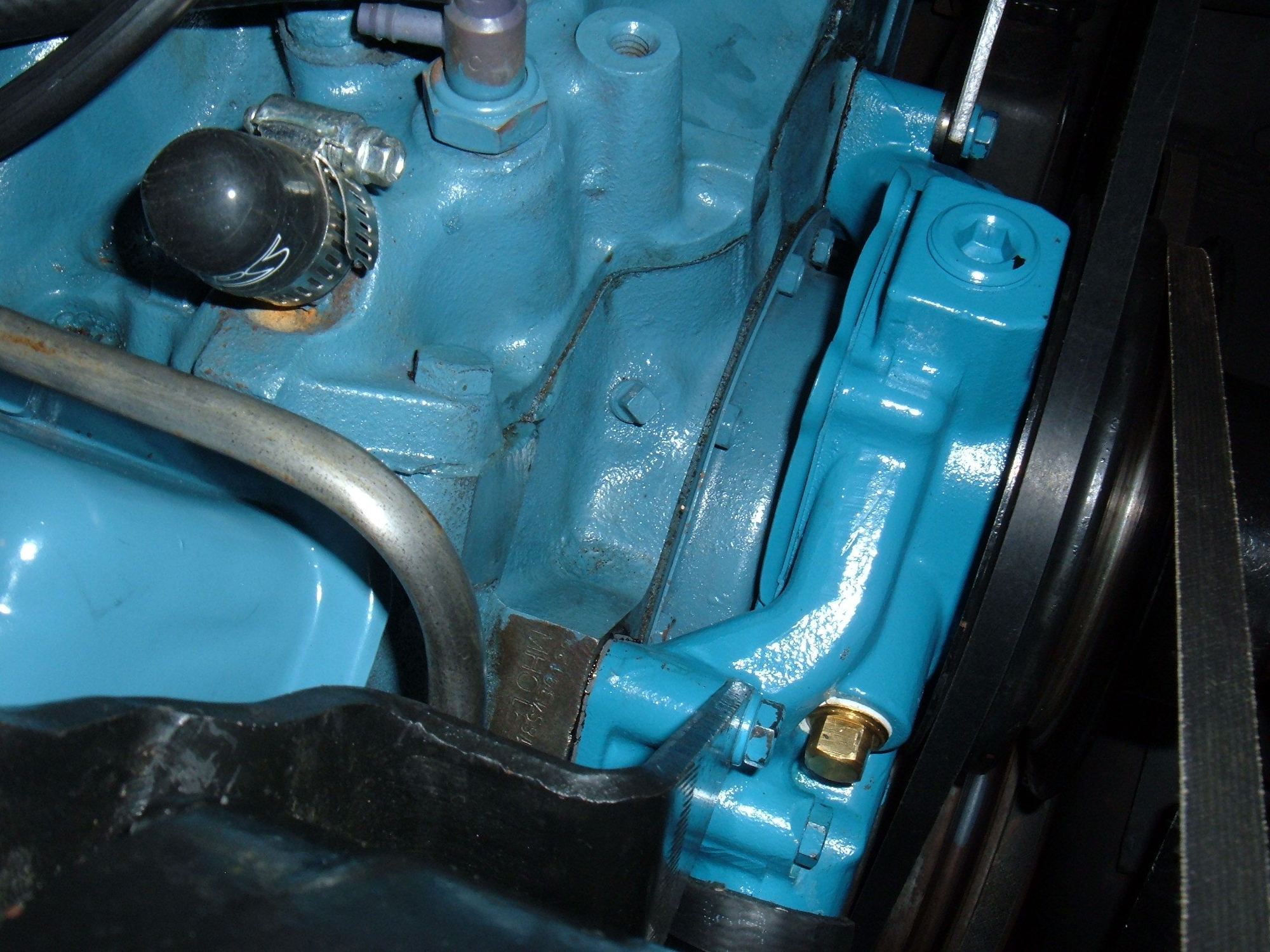

Old May 8, 2024 | 12:15 PM
LowSporty's Avatar
LowSporty
Joined: Dec 2020
Posts: 246
Likes: 165
Hello, here's a pic of how I did mine regards, LowSporty
