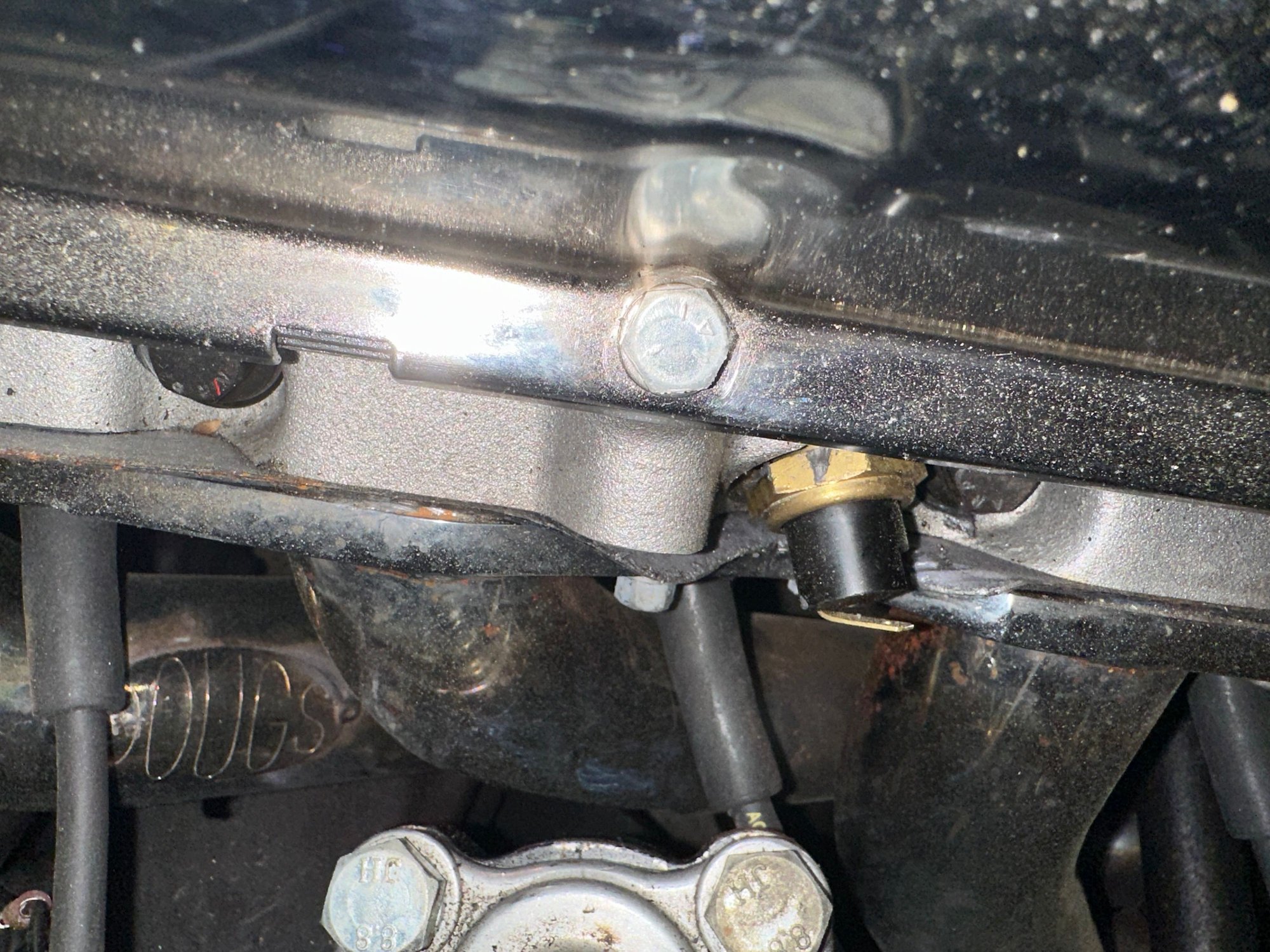

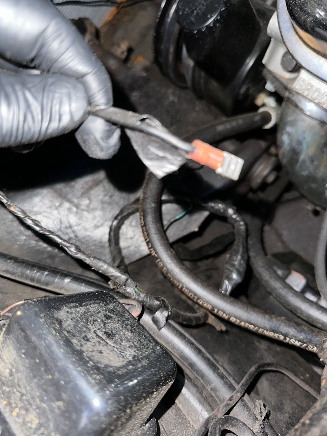

I was checking my brake fluid tonight and noticed a connector sticking out of my block. After some searching, I found this wire in that area. It connects to a mangled harness. Do they belong together and what do they do?

That's more or less where my temp gauge sender is (not brodix but...)

Coolant Temp Sender.
And somebody decided to bend the chit out of it when they installed the header.

You need to cut off that connector and put a shielded connector on the wire.

Is this the wire for that sensor?
A shielded spade connector?

Sure looks like it's the correct wire for the coolant temp sensor. Is your temp guage in the center cluster not working?
Whenever finding a unconnected wire. The first thought should be, What's not working?
Keeping in mind all vehicles have some unused wires.
In this case it does look as thou the original temp sensor was replaced with this one with the spade terminal, the original connector cut off and this cheap female spade connector installed.

That wire also had a woven heat protector on it. Best to put the cover on it and add the connector last. Jerry

None of my gauges work. I’m fixing several things at once.

Here's what my '72 454 temp wire looks like (new Lectric Limited harness):
