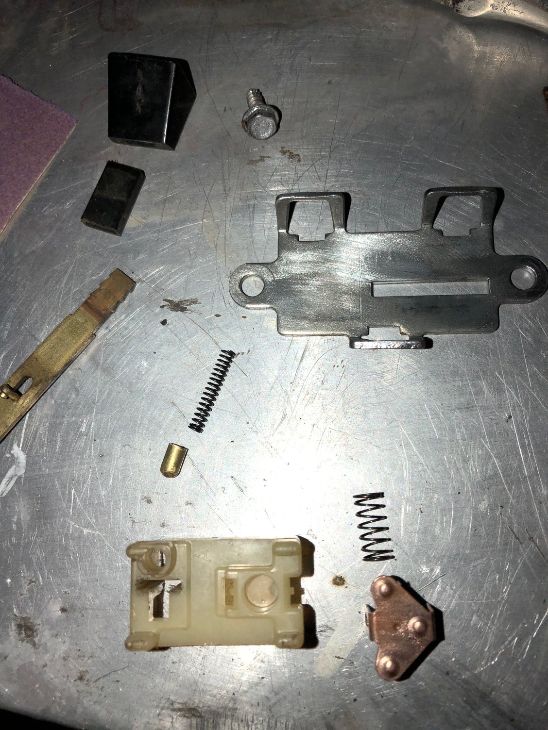

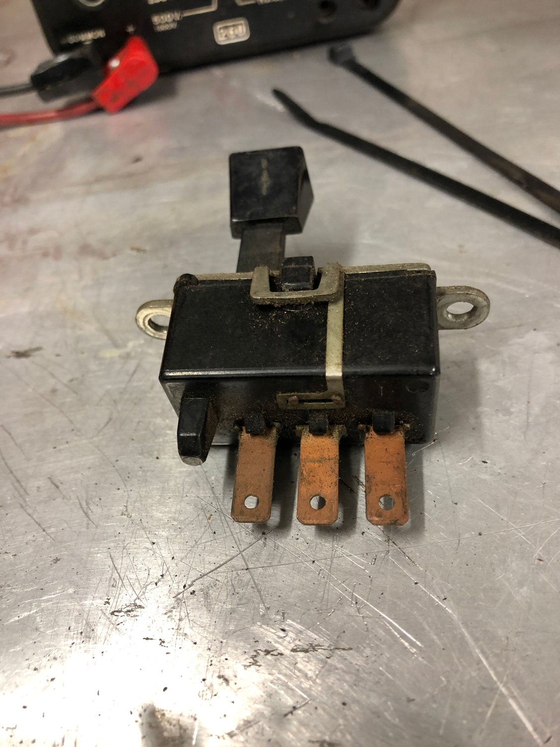

If the switch doesn't work after a good spray cleaning, you may need to disassemble it...
older cars seem to use switches with an internal slide mechanism. The switch grease becomes dry and stiff....
