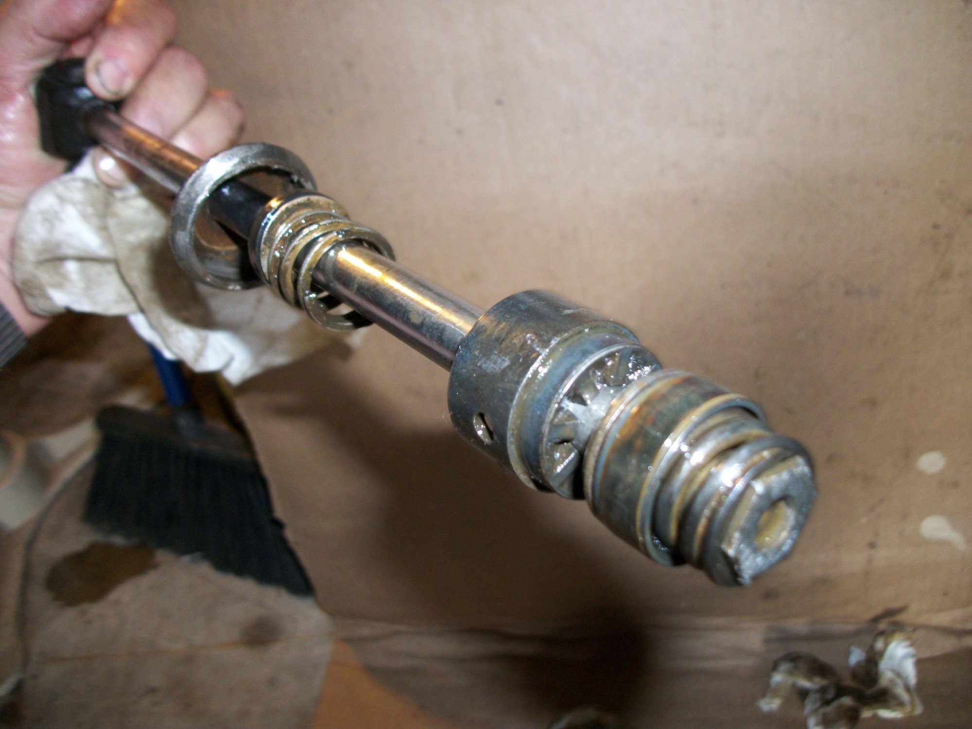

I think I'll spend the money on a bump steer damper...driving around New Orleans I found myself in the oncoming lane after hitting a "superpothole" near the Superdome.
The original damper was worn out and rebuilding it without the correct seals didn't renew it.
