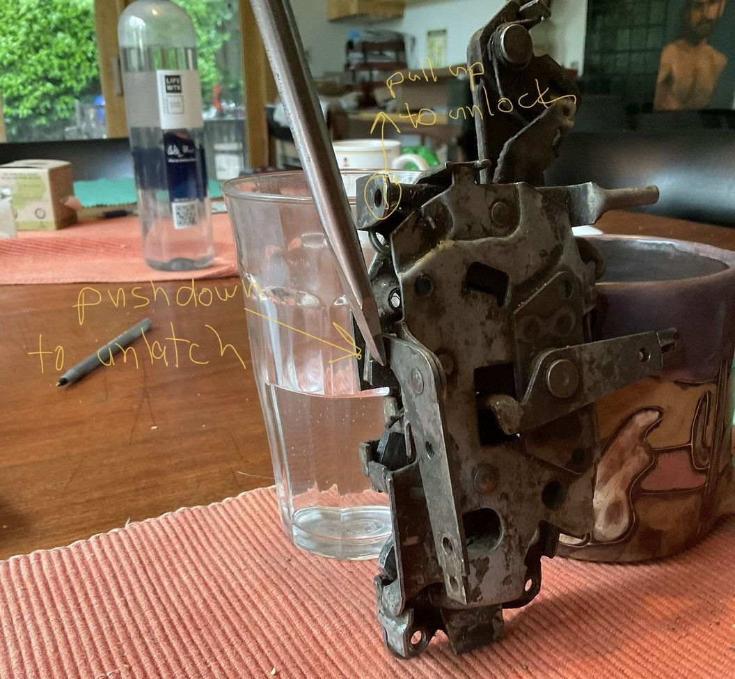

Find this part and push it down with a screwdriver:

Those 2 screws hold the black plastic ANTI THEFT or whatever it is called plastic cover in place over the locking mechanism. It covers the parts the Mr Peterbuilt showed in his pic.And yes the door needs to be open to reach them. Like I said, if you were lucky the last guy didn't replace those covers the last time the door was off.

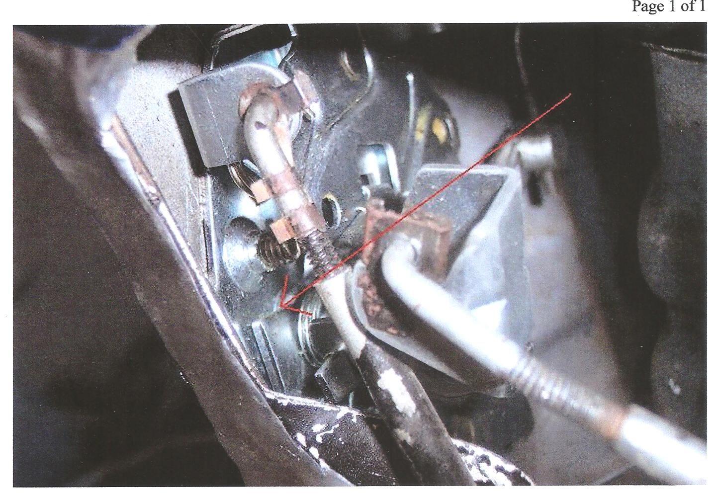

Another pic

I am still fighting with the 82 drivers door. It is locked and will not unlock.
I have a few questions:
Referring to the above pictures of moving the "door latch" and the "door lock mechanism" with a screwdriver through the window opening:
1. Can the door latch be pushed to open the door if the door lock mechanism is in the locked position?
2. Does the rod that is originally connected to the door lock mechanism have to be connected when moving the door lock mechanism?
3. Is there anything else that I need to move / push / pull to get the door open?
Thanks for your help on this.

When you use a screwdriver on the door lock mechanism, give the screwdriver a quick slap down, it should release. Mine was caked with hardened grease mixed with dirt, I ended up taking the mechanism off and giving them a good cleaning and new grease. Good luck.
