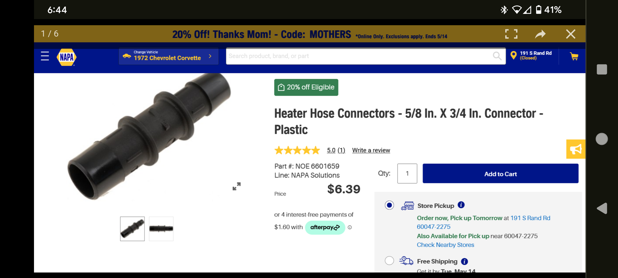

Because one heater hose is 5/8" and the other is 3/4" there is a special connector just for this job.
Its black plastic and has both of the above sizes to make a temporary loop.
Simply remove the heater hoses from the core after draining some coolant.
Attach hoses to adaptor, clamp it, good to go until repair is made.

Originally Posted by Mdbirk
That's what I used. Been there for 20 years.
