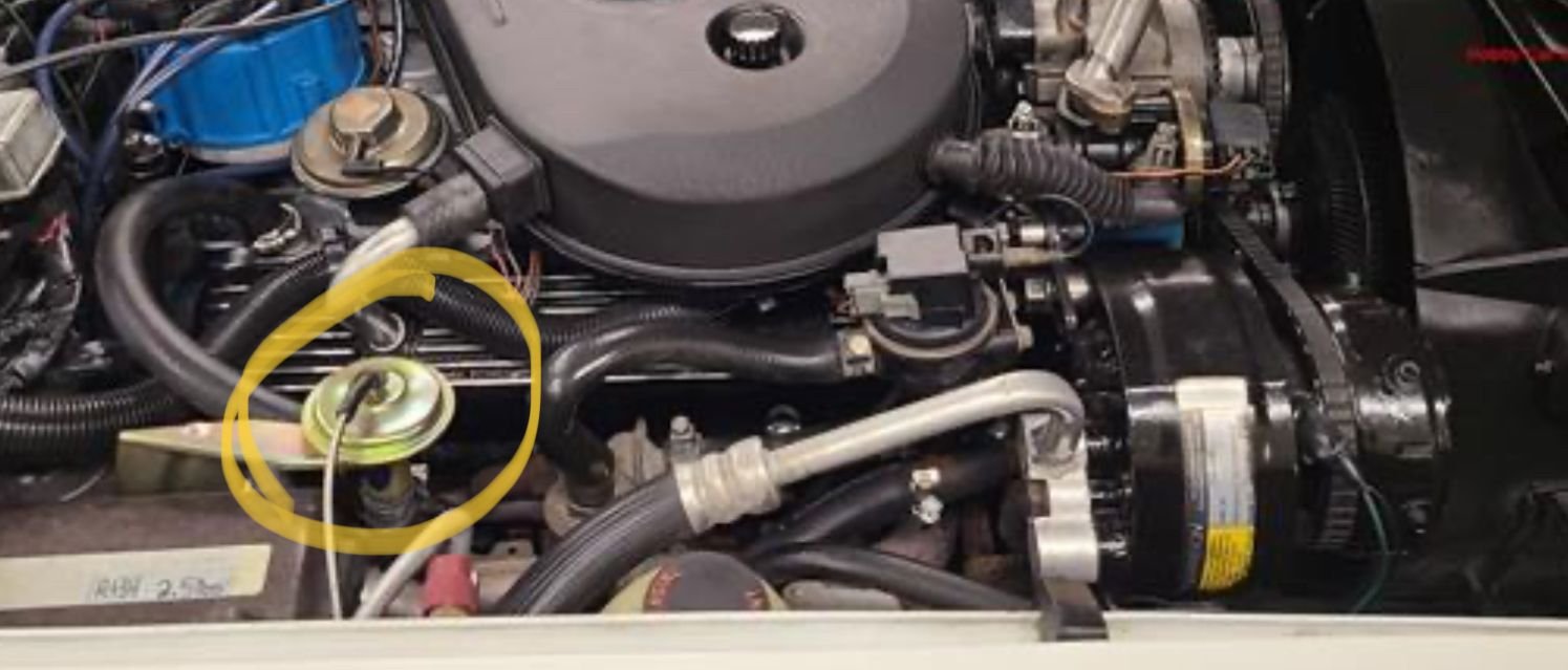

Hello. 1982 crossfire. This part is leaking antifreeze. Need to replace. Any help and part info appreciated. Thanks.

Hello, that's your heater-control valve, it turns on/shuts off the flow of hot coolant to the heater-core when you select heat. It's vacuum operated Regards, LowSporty

Valve, Heater Water Temperature Control, GM part number 14044483 . Google that number and you will find sources.
