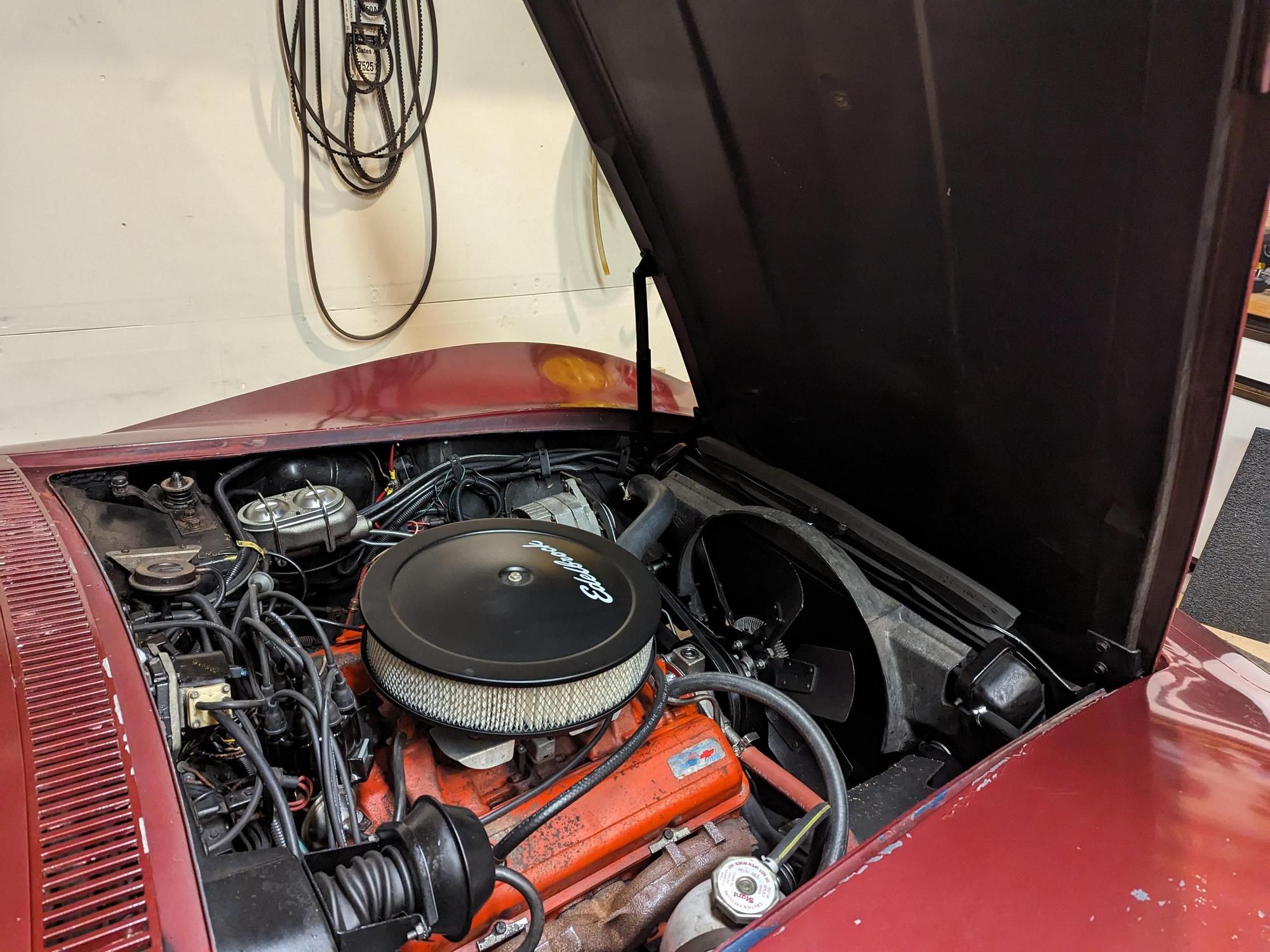

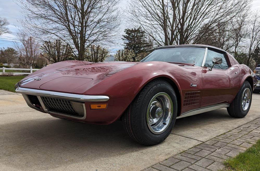

Thanks again for all the questions answered in 1st thread. Just wanted to share a quick update and couple of pics. Finally able to drive the car.
List of things completed below. Right now, everything works, including headlights and wiper door.
I still need to replace weatherstripping and oil pan(very banged up) before thinking about paint or wrap.
I replaced the Holley(ran way rich) that came with it back to a Quadrajet from a 74 big block Vette. It ran quite well after. Whatever cam is in it won't let me get the idle any lower than 900-1000. The clutch and trans seem fine as well, only concern now is the clunk when first starting off or going from reverse to first. I replaced the front pinion bushing and that helped some. I am hoping just the high idle and 6 universals are causing it and not issues with the rear itself.
