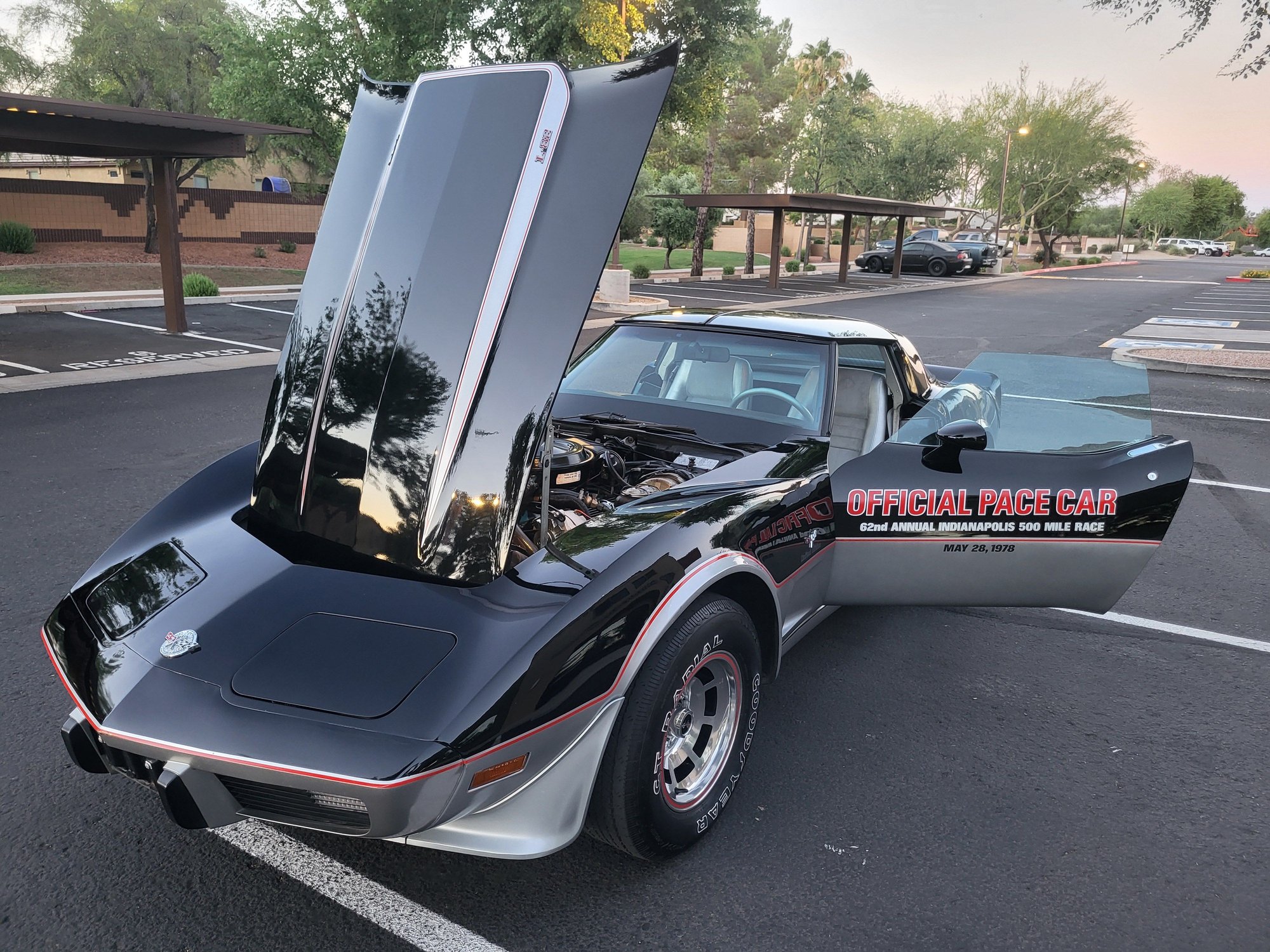

I was in Dallas last week on business and had plans to look at that pace car, I recently sold my 1980 for a pace car purchase... I loved the 80 and I'm partial to the 80-82 body style, I am mechanically inclined but for myself I stayed away from the 82 when I was looking because I was personally more comfortable under the hood mechanically with the non computer 1980 and earlier... I added a 2004r overdrive transmission which is a big plus for the 1982 your looking at.
As much as i love the 80-82 body I also think the 78 pace car is one of the most attractive C3 corvettes produced and becoming popular, though 6500 made for me it was just a little more "collectable" over my L48 1980 I had and that's what I was looking for.
the 78 is going to be more primitive than the 82 in many ways, i purchased a 5k original mile L82 pace car and the original paint is quite nice but being a St. Luis plant lacquer car it is less refined than the 81 and up Bowling Green produced body/paint, I was able to take a few days and 2000 sanded, buffed and polished and looks pretty impressive now for original paint.
Best of luck in your decision, definitely pros and cons for both, your plans for driving, abilities, resources and future plans will play into your decision.
Wanting a C3 is great but if you are not mechanically inclined your gonna want resources for some basic repairs that will be inevitable, I've owned many and enjoyed them all taking them out for a ride weekly without any big issues but will always need basic repairs, not easy today to find someone who works on older cars in all areas.

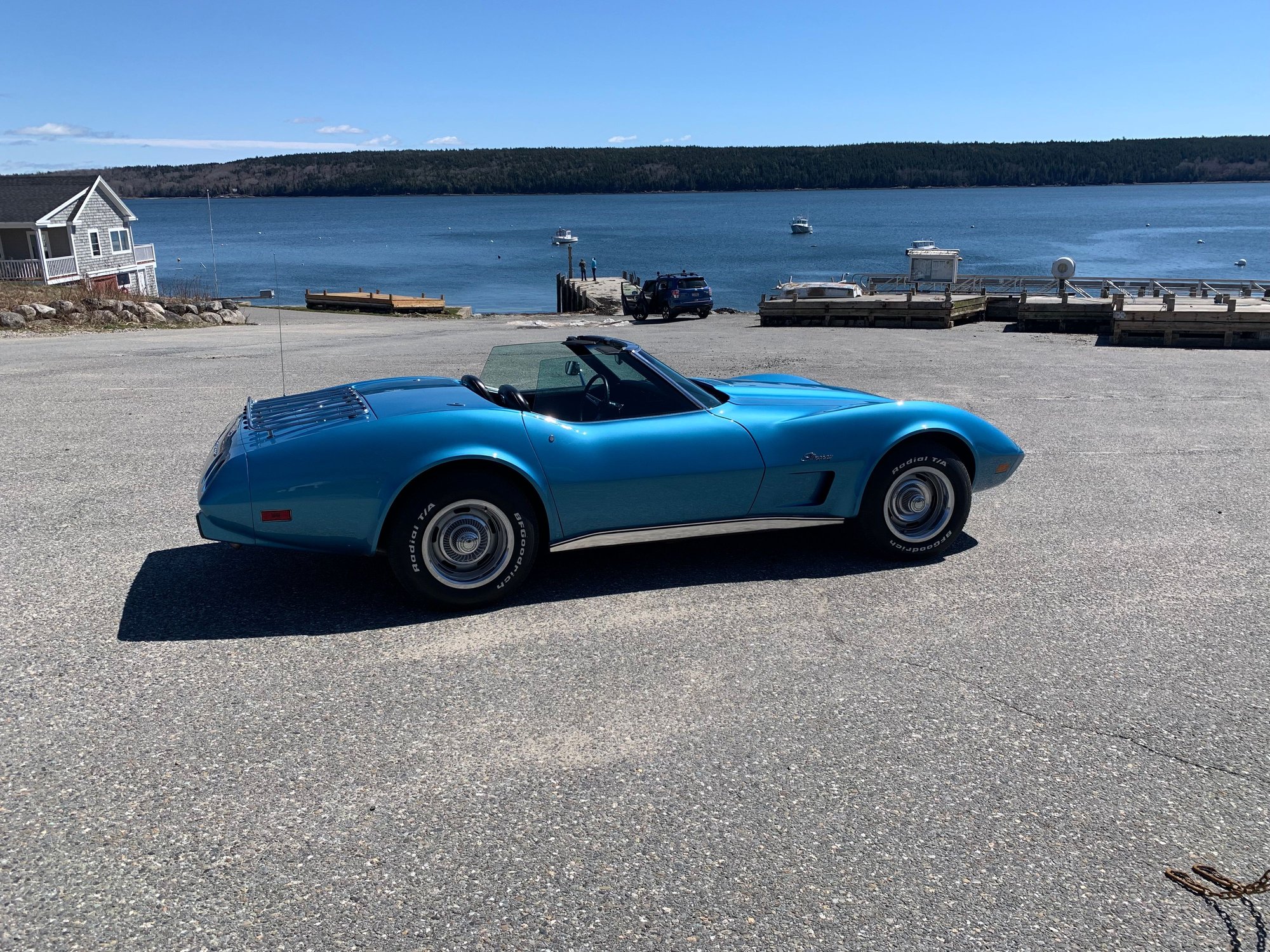

A great looking coupe in Bright Blue, here is a roadster
