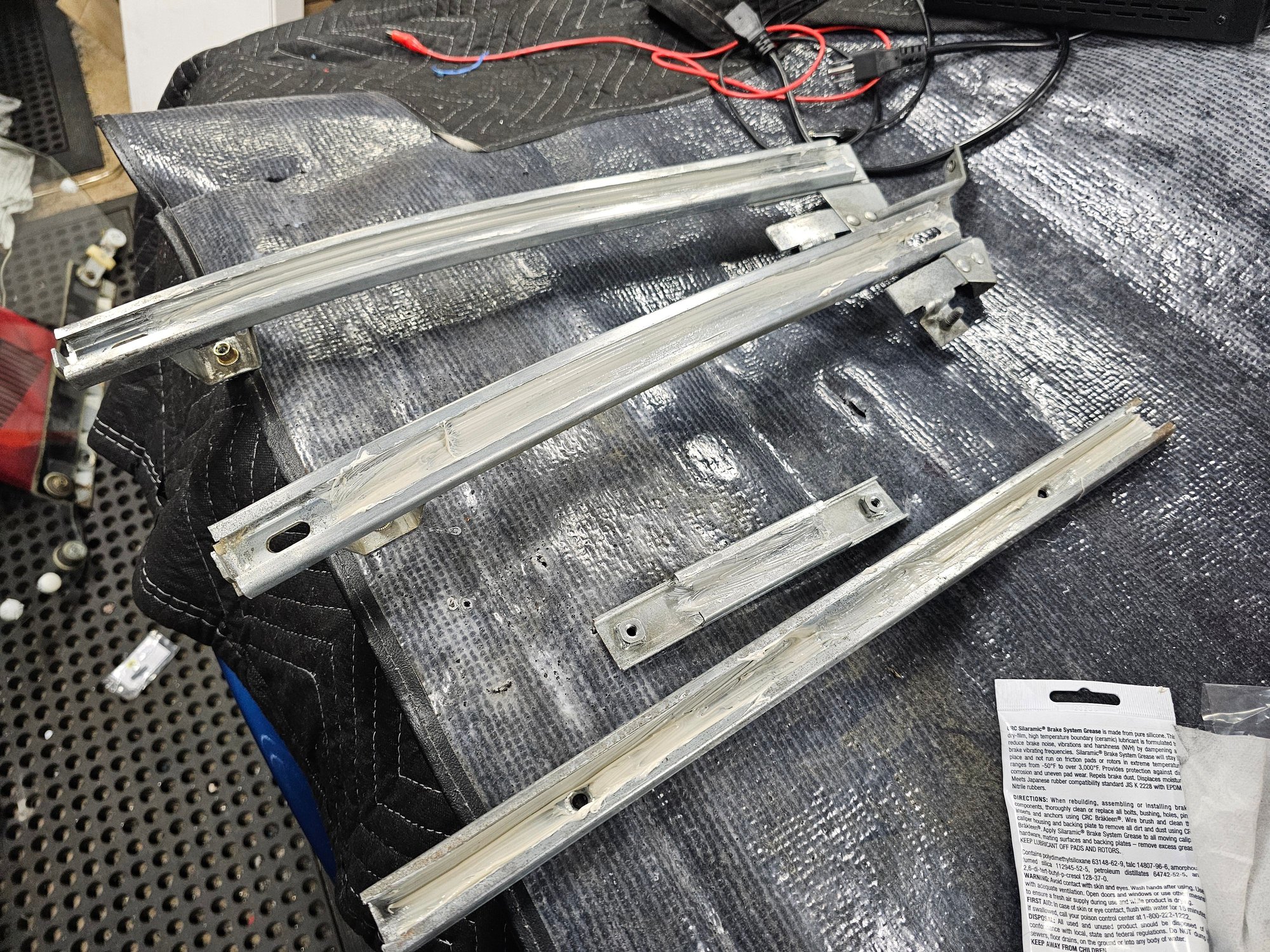

I'm cleaning and rebuilding my P/W tracks and regulators. For the tracks that guide the rollers, is it really advised to grease the entire thing like in the article/pic above? I can see greasing the roller axles well, but why the tracks the wheels roll in? Seems it would collect grit and junk and hinder the rolling action.
Any advice on this detail?

I thought the same as you. I have a copy of that article and the amount of grease they use seems excessive. Short term-doesn't hurt anything. Long term-hard to say. I opted to be more conservative. Used Mobile 1 Synthetic and maybe a third the amount. Windows go up & down in the blink of an eye.

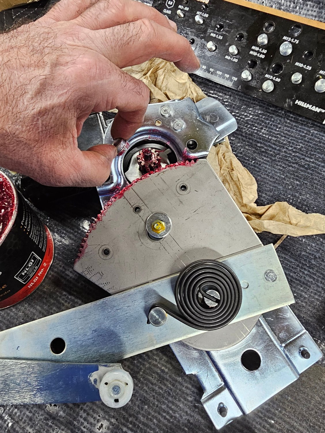

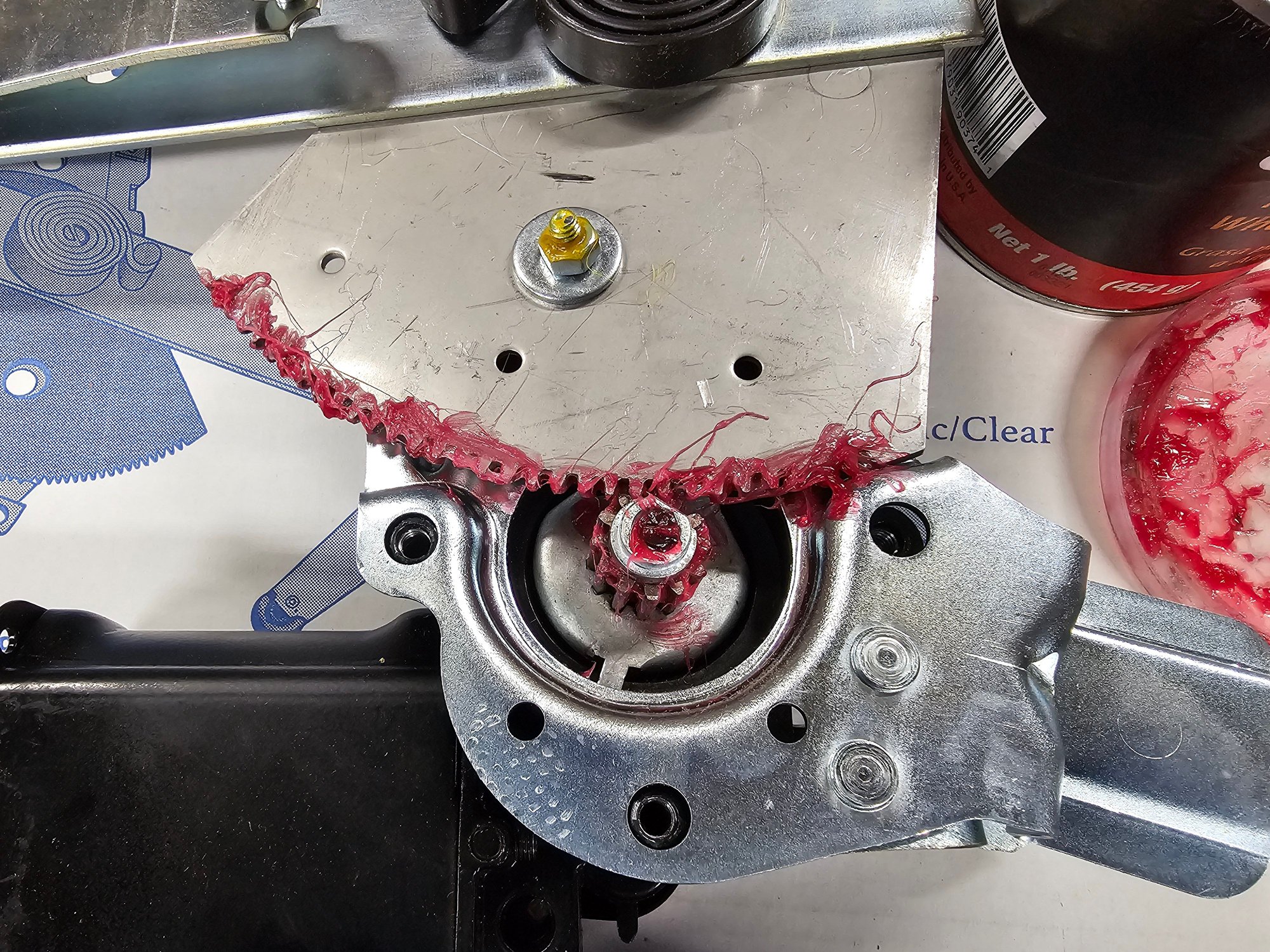

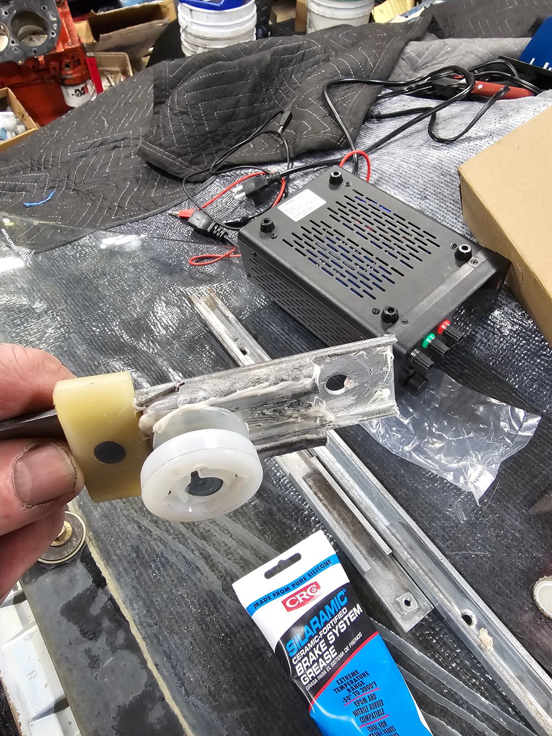

I used bearing grease on the gears and ceramic brake grease on the sliders. A conservative amount.
the whole show is here...they work great if not go a bit too fast but manageable..

"A conservative amount"? What would you consider a liberal amount? 😉 I still question why the roller tracks need any lube at all...

Friction reduction, they are more guides than rollers.
That would be my take on it also. It's not a precision fit assembly. The grease prevents binding.

@Rescue Rogers I get it now! Just received replacement rollers and, even greasing the wheel axles, they really aren't freely rolling. My old ones were very floppy because the 3 little hub nubs were gone on every wheel, which allowed the wheels a lot of movement.
Thanks for the feedback and patience with my ignorance comparing new vs. old (damaged) parts.
