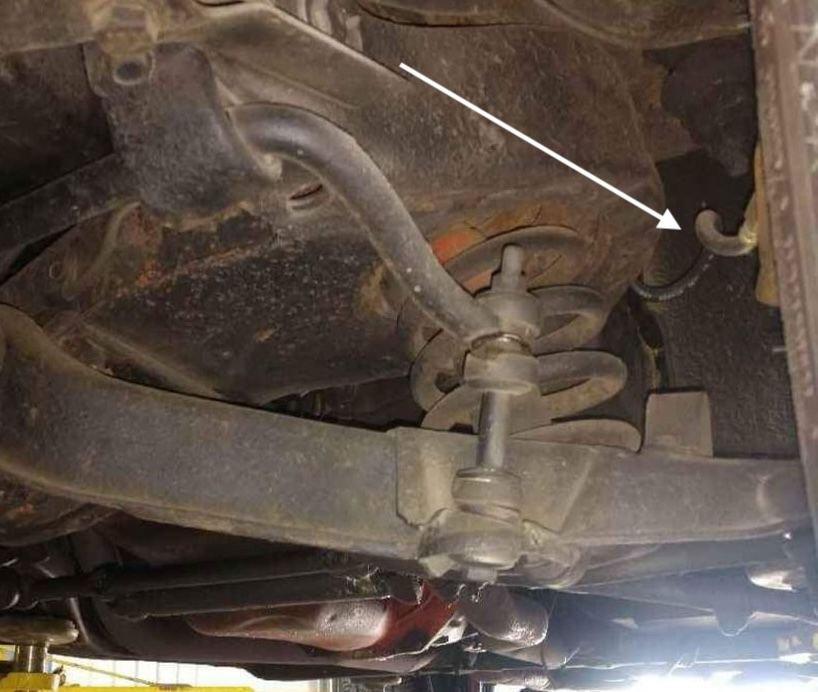

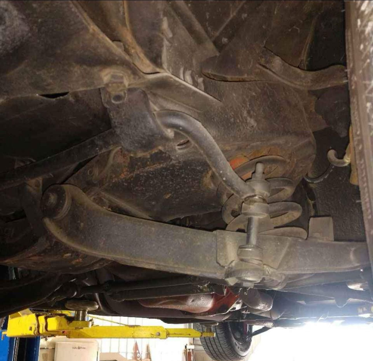

Here are a couple pictures, not sure if they show anything of value.

Pretty limiting on the pics to see much... about the only thing that concerns me is the pig's tail corkscrew on the front brake hose. Should not be twisted like that.
The rear spring hanger bushings look pretty flat so a future replacement may be in order, but it's pretty hard to tell their condition in the pic.
Nothing else looks amiss other than being dirty, so has likely been some time since the car was NCRS judged.
