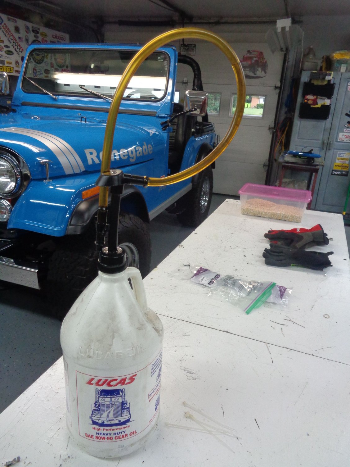

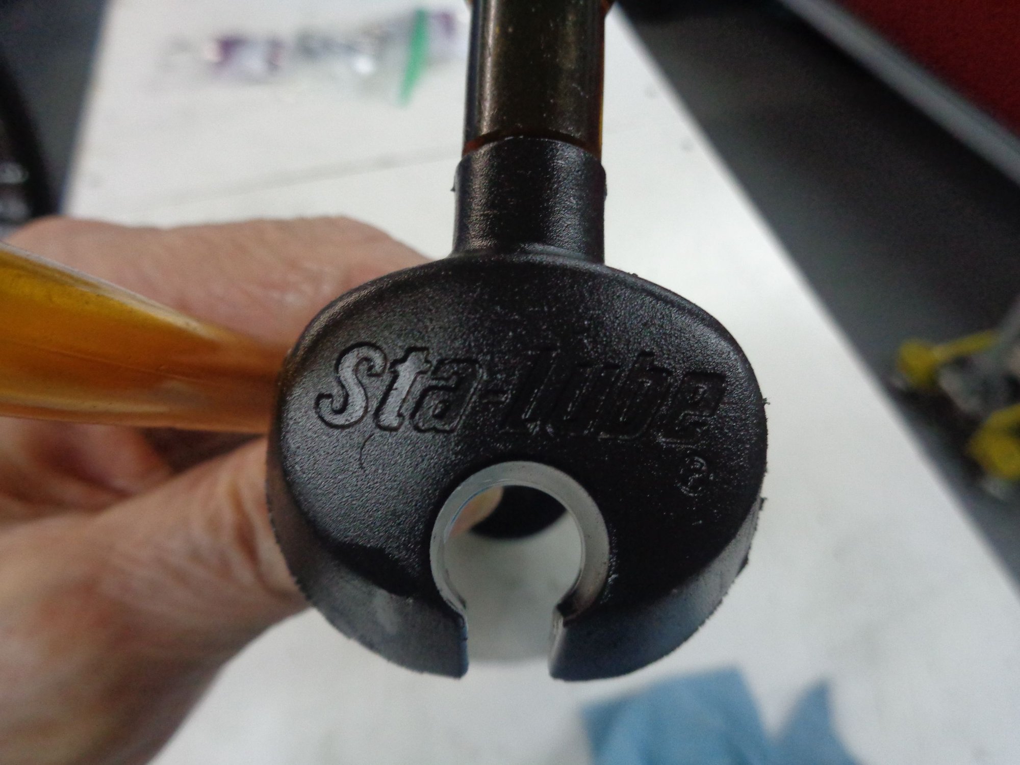

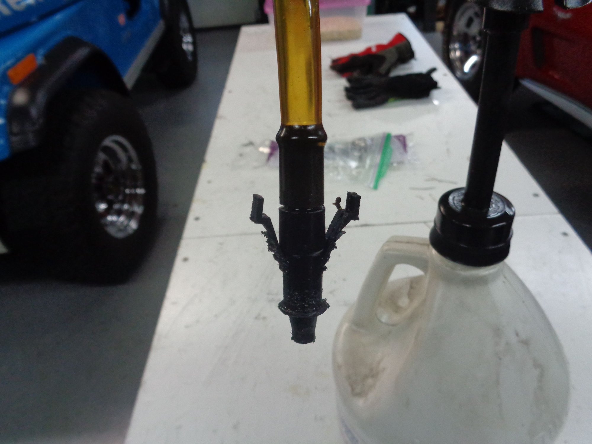

I've used one of these pumps for years. I have two 4WD Jeeps, which is 8 gear boxes that need filling. This works great, stick it in a gallon jug of gear lube and start pumping. No mess.
