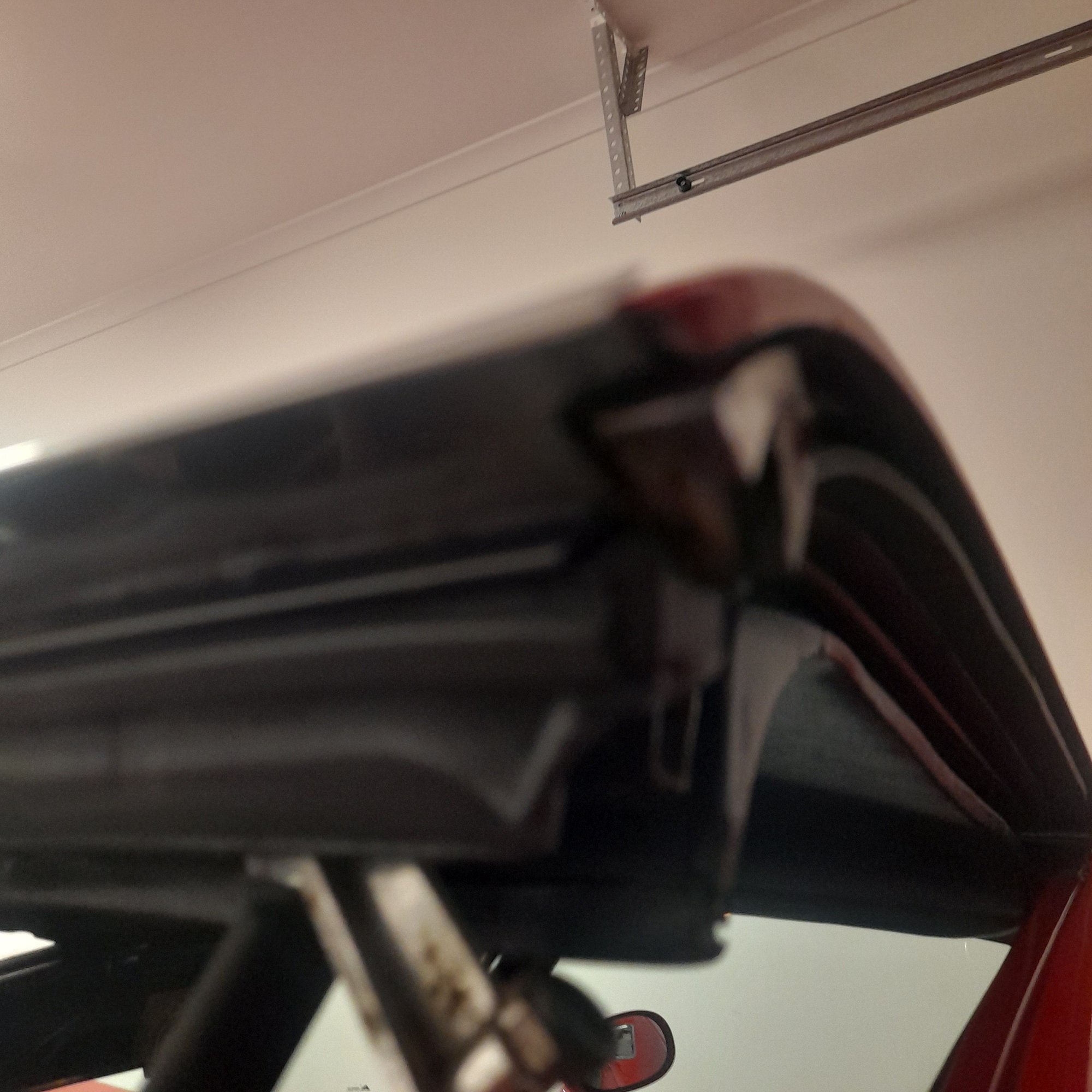

OK, took some pic's of my driver's side T top in the area where the door glass meets up.
About the center above the side window. Note the gloss black channel the weatherstrip fits into.
Forward corner. You can clearly see the end of the channel the weatherstrip fits into.
Rear corner.
The late 77 and up weatherstrip does not use this channel. The reinforcement is built into the weatherstrip.
Also of note, only the very late 77's used the late weatherstrip. So if you have the key alarm in your fender. And the original tops you should have the early style weatherstrip.
Now if your tops aren't original.........
