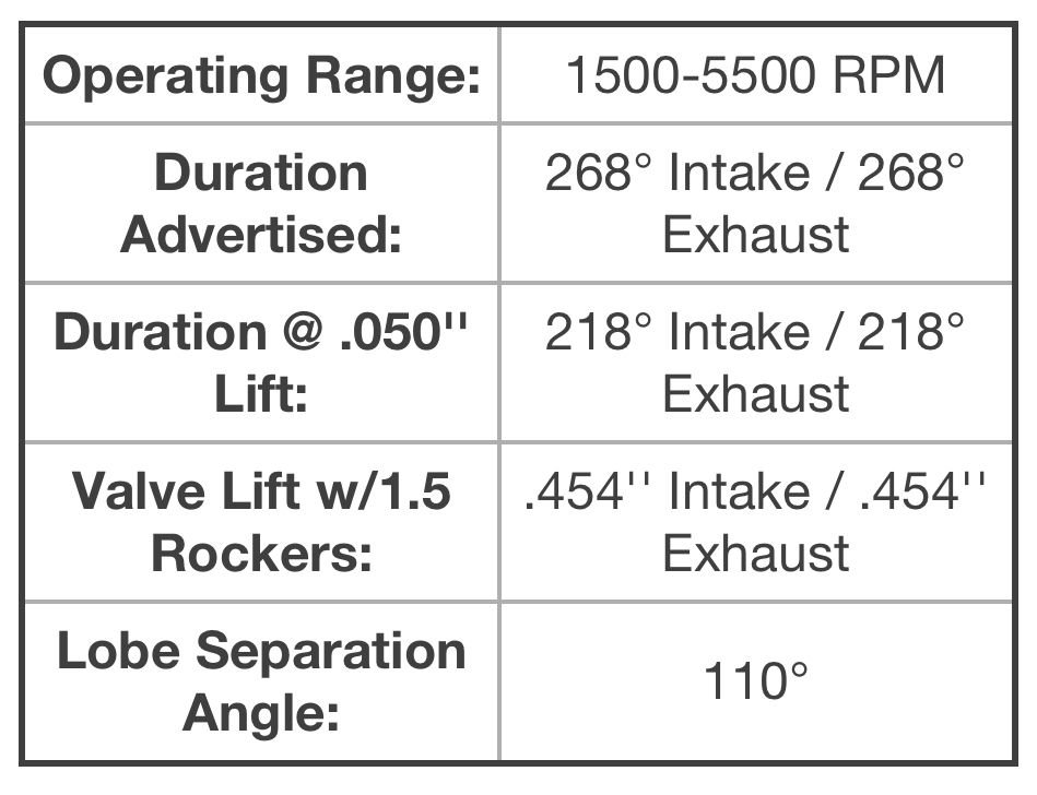

Thanks for the Comp 268H recommendation.
I have swapped out my stock exhaust and went to a true dual 2-1/2” exhaust out the back with Magnaflows.
Follow up question:
If I do swap to a Comp 268H, is there anything I need to adjust with the stock valve train? Or is it as simple as a R&R the cams and get back on the road?
Additionally, what should I be looking at for specs with the
Comp 268H (lift, duration, etc).

Straight from Jeg’s website:
You’ll need new lifters with any new flat tappet cam obviously. Not sure if you’ll need new pushrods. Many people have done this cam and kept the stock rocker arms, I’m sure they’ll chime in with what length they went with. Once everything is back together just give the lifters 3/4 of a turn of preload.

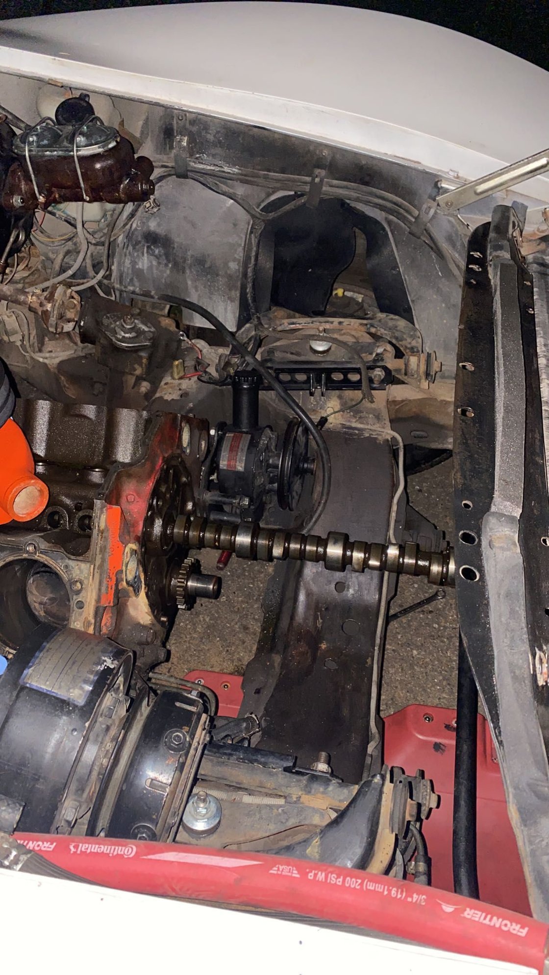

If you have AC you’ll get the cam out until the very last lobe and it will hit the condenser.
Unbolting it and gently rotating it out of the way should give you the clearance you’ll need, being very careful not to kink any of the lines.

Max lift for those stock heads is@.480

Here are their .050" duration specs.
L48 195*
260H 212*
268H 218*
L82 222* / L46 224*
The L46 cam adds about 600-800 rpm up top vs the L48 one, and has an idle lope you can hear, vs the L48 is very smooth.
GM says there is a 50 HP difference between top & bottom.
The others kind of split the difference
Due to other factors, on a stock 8:1 CR block, the 268 will run the hardest of all four, and better than the L82/L46.
On a 10:1 CR block, the one step bigger L82/L46 is the clear winner.
I doubt there is a noticeable seat of the pants difference between an L82 or L46.
They are all good streetable cams, torquey, not big HP cams.
The milder the rear gears you have you should stay near the smaller ones. (268 & smaller) The bigger ones really respond with more rear gear (268 & up).
So you have a 3 step interval, roughly about ~20HP for each step.
