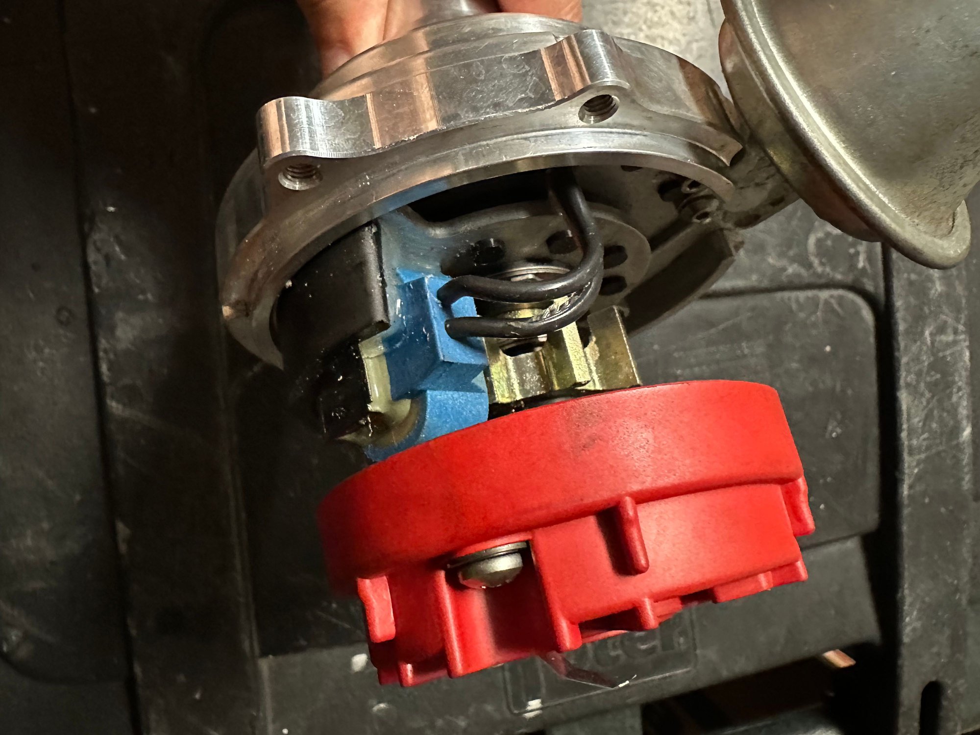

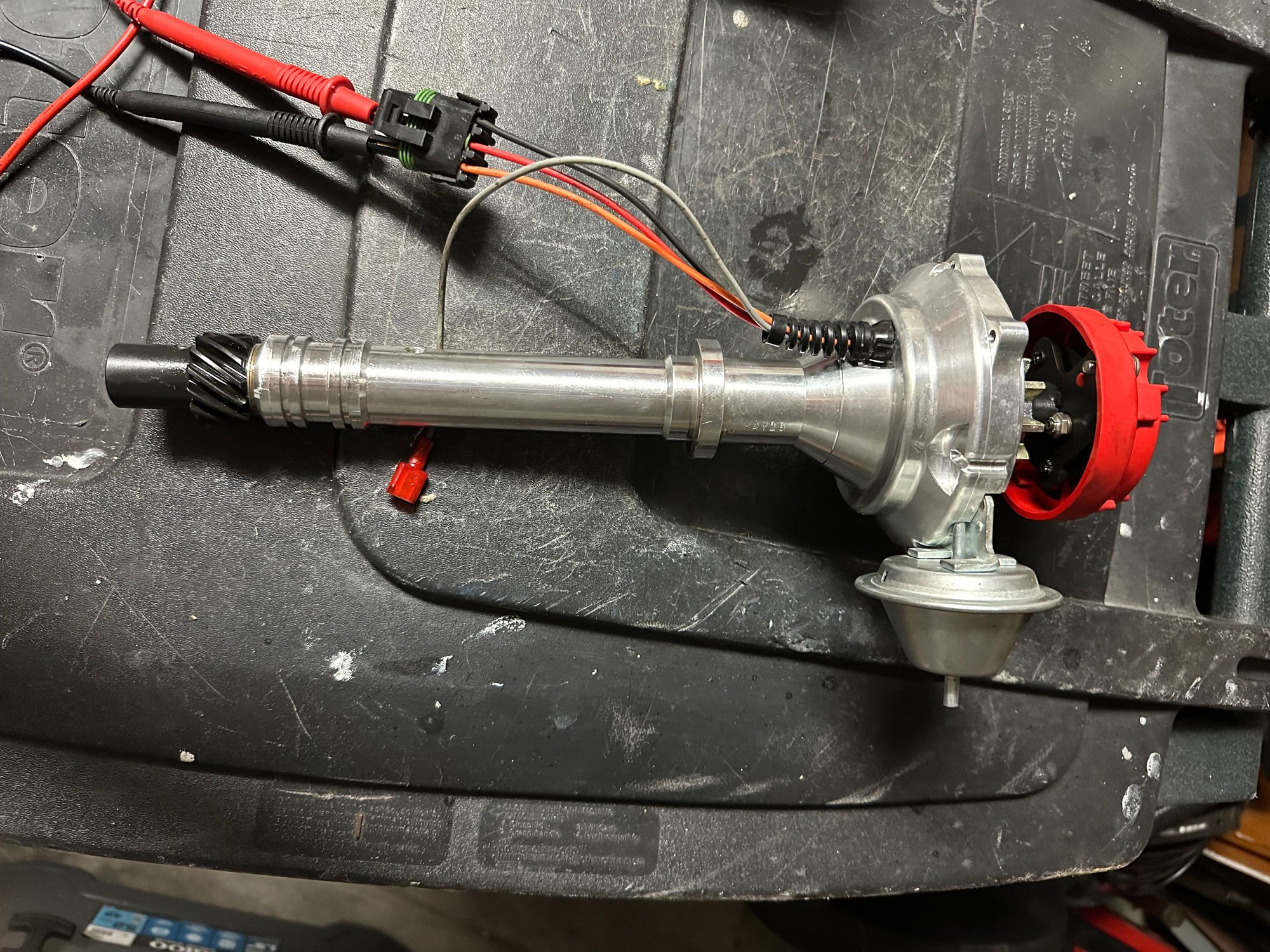

Wrenching on my son's 73 Camaro today trying to diagnose a sudden no spark issue with his MSD 8360 ready to run distributor and Blaster 2 coil. At the end of the day I decided to pull the distributor and bring it home (the car lives at his grandparents house) and do some Google searches. I have never in my 30+ years of working on cars seen a distributor that was so hard to remove. I had to yank and wiggle the sh*t out of it to get it to come out. We have only owned the car a year. It has the numbers matching 350 that was rebuilt recently by the previous owner. It has a Chevy branded performer type intake on it and the distributor looks brand new. The previous owner was the KING of the "bubbas". I have the Corvette tach drive dist.,6AL box, and Blaster 2 coil in my Corvette for over 20 years without a problem (knocking on wood)
Does anyone know what would cause this issue?
Does anyone know how to test the pickup module in the distributor?

Other modules can be tested with a 9 volt battery and a multimeter to test for an output signal. You need to know which wire is power, ground and signal. Power and ground to battery, multimeter to signal and battery negative.
