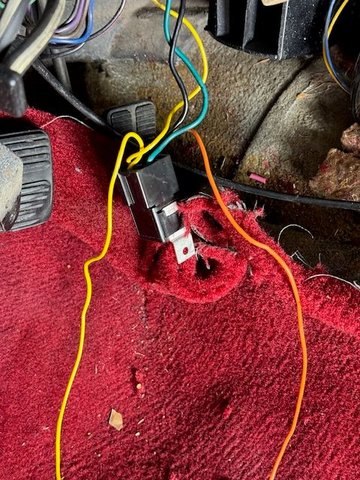

Thanks again Retrovet. I'm almost done removing the Viper 350 system but have run into a snag. The main module is removed as well as all the wires that leave the module and splice into the factory wiring. The only remnants of the Viper system is what I believe to be the starter relay. It has 4 wires: yellow, orange, green and black. It's definitely a Viper product and I will post a picture. When I unplug this relay from the square pigtail connector (not snipping any of the four wires) the car won't crank (start). This is weird because everything else from the Viper system has been removed yet I still "need" this relay circuit to start the car.

Hi
Follow rhe green and the black up to the splice. It separates the starter wire - purple. Just splice the purple back together. If you can not see it , you may splice the green and black together and eliminate the socket and relay. Do not attach the yellow - should be an ignition source - just tape it up
If your at the column wires you will see the purple wire cut and going to the socket wires. Just remove and reattach
Yellow may be connected to a pink wire. If so remove and tape the pink.
You should be fine after completing
