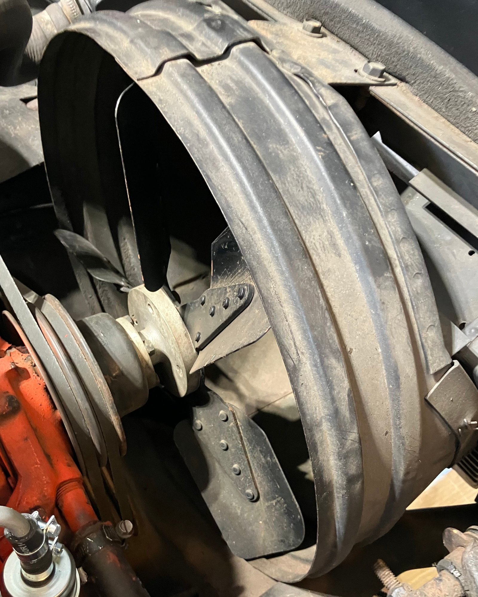

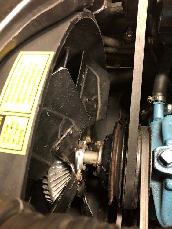

The 1972 base 350 convertible I recently purchased does not have a fan clutch. I haven’t driven the car very much since I got it home, I’m fixing all the systems and pieces that have been neglected for the past 30 years. It didn’t overheat when I drove it 40 highway miles home. My factory Assembly M
anual shows it as having a fan clutch. Do you all think I should invest in a fan clutch or just drive it as is and see where my temp is at?

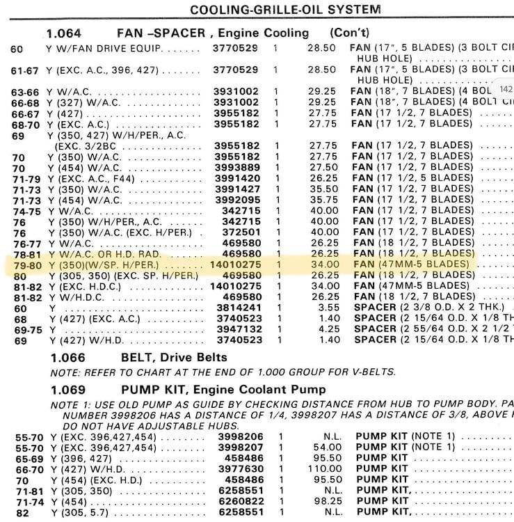

here is my fan clutch education.
https://www.corvetteforum.com/forums...re-79-l82.html

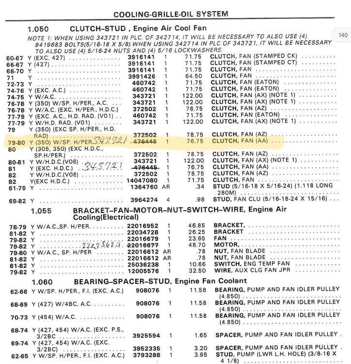

IMO, that looks like a fan clutch eliminator kit used with the stock fan. I would get a fan clutch first. Also, if your going to look for the parts by GM part numbers, the correct GM part #'s for a 1972 L48 with no A/C is 460472 for the clutch and the fan blade is 3991420.

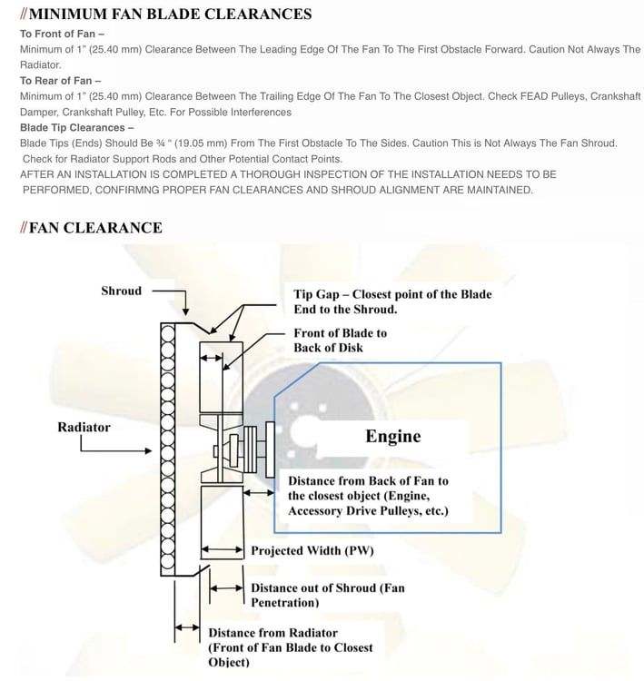

Positioning of the fan blades in relation to the shroud is critical. You don't want the fan too far inside or too far back where its doing nothing.
I believe the general rule is: two thirds (2/3) inside the shroud.
Looks like yours is spot-on.
If you add a clutch, you will likely have to remove that fan hub you have now, to get the proper spacing.
should be half in or half out depending how you like to look at it

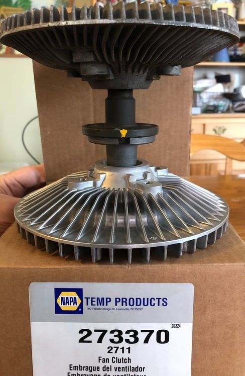

In the thread i posted
https://www.corvetteforum.com/forums...-79-l82-3.html
i found the replacement not the same as original.
mine was all in shroud except half inch out, the new ne would pull it back almost another day inch.
I wound up fxing my old clutch in thread bot would be kinda cool to get exact measurements for your car..
i would put a clutch in. If it verheats with clutcg, something else is wrong.

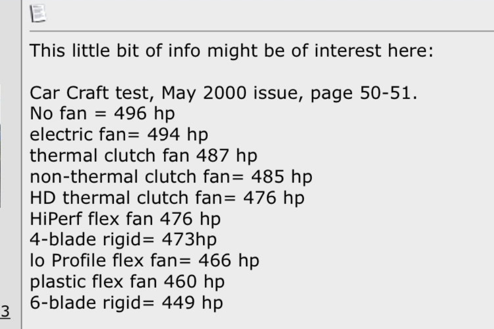

Agree woth heavy duty i tried..really noticed drag and noise..i can only imagine how much power lost if i could feel the heavy duty vs standard hp clutch.
Example to show relationships

Thanks for posting the diagrams and a part number @interpon!
The OP would do well to use that, and get on the road quickly.
