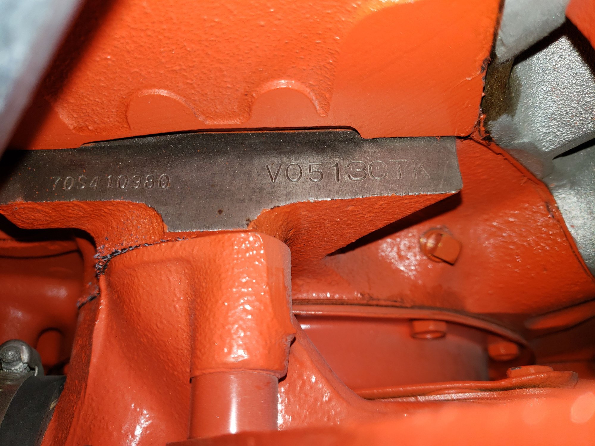

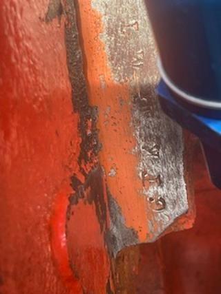

Here are the pics i n 2 photos; there a fuel filter in the way so I can't get a detailed picture in one photo.

Wow that is bad. Factory stamps where done in a gang holder where it will be straight and even. That is not even close

I'm sorry to be the bearer of bad news but in my 44 years as a Corvette mechanic I have never seen a stamping like that come out of the factory. As Nowhere Man stated they are done with a gang holder and I've seen them off center of the pad but still in line. Those numbers are all over the place. Also the font looks a little funky to me.

These are typical appearing stamps for a 1970 LT-1 ether CTK or CTU.

Keep in mind that the very poor restamping does not tell you that it's not the original block/engine for the car. Could very well be original and just restamped after block was decked (though it looks like it's been ground out and not done by a machined fly-cutter or the like which is suspicious in itself).
Your next step is to look at both sides of the top of the engine's rear flange where it bolts to the transmission. The driver's side should have the block's casting #, the passenger side should have the casting date.

OMG ................sorry, but that's the worst stamp pad I have ever seen, no question, hands down, PERIOD !! It's like the difference between a five year olds handwriting and an adult. BAD ....... Hope you didn't pay LT-1 money for it !!!
